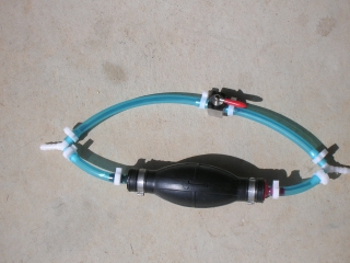

This is the primer bulb plumbing I used in my Mk 3. Works great and no more cramped fingers trying to clamp the bypass line closed.

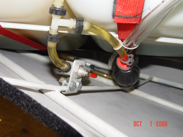

Ditto...
