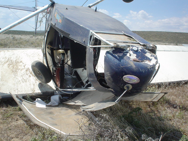

As I mentioned earlier I finished the Firestar to the point that I could get her back in the air. As you might remember I had to make an off field landing in the first part of May and ended up on my back with my wheels in the air.
[img]cid:001301c6e37b(at)usermj5tjr71vq[/img]
The only real damage to the structure was the tube that the rudder pedals set on. The fabric was trashed in transporting it to a trailer across hill and dale. I found when I recovered it that auto paint and stitts fabric apparently do not mix well. At least that was the AD that came with my covering kit. The paint of course was auto paint. I had wanted to recover it this winter any way. Just not at the beginning of summer.
