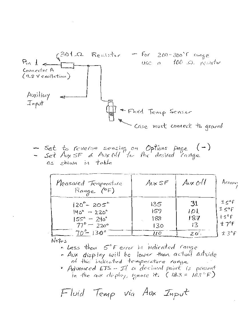

I have just received a reply from GRT on the coolant temp sensor connection to their EIS 4000 - they confirm that Aux. 4 can actually be used by the arrangement shown attached with the VDO type temp sensor that e.g. Skydrive sells with the T-piece to be inserted in the coolant tubing - or one of the sensors installed by the factory in two of the cylinder heads.
Best regards,
Svein
