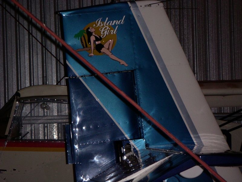

Hey Gang,
I agree with Dave. The glues used on the tape are quite good.
I have a large vinyl cut graphic of a girl in a bikini on an island
(really!) on the tail of my Lake amphibian now for 10 + years with no signs
of peeling. And the prop blast is only 3 or 4 feet from it (being that it
is a pusher), as well as the huge amount of water spray it endures. Also,
a
friend of mine has an Avid Flyer that has vinyl graphics (large ones) on
the
fuselage, tail, and wings. It has been probably 5 years and 300 hours of
flying conditions (winter, summer, spring, and fall - skis, wheels, floats)
with no problem. Another friend has done three (going on four now) Just
aircraft co. Highlanders, each of them having large graphics on the
fuselage
and the floats. No problem there either, and we flew two of them from
Wisconsin to Florida and back, along with a couple 1,000 mile trips thrown
in. I also have a set of fibreglass floats with graphics on them that are
at least 5 yrs of heavy water use, and left outside. No problems with that
either. Granted, fibreglass and metal are different than fabric. But from
what I can tell the fabric holds the stripes just as well.
I personally think if you make sure a professional tape stripe installer
does the work it will stay on without issue.
Here's a pic of what the graphic on the tail looks like today (with a bonus
picture for all of you guys that don't understand why I like seaplanes so
much.....) <GRIN>
Paul Seehafer

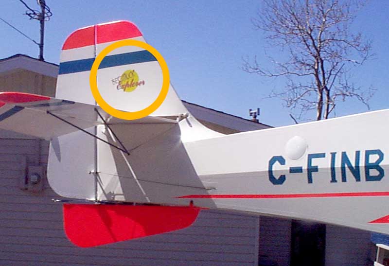

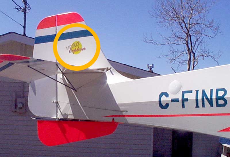

Weight... for a full body wrap
I have a small plastic graphic installed on the tail of my plane for the past two years... No cracks,rips or tears. Installing a full body wrap on a cloth plane could be fun though. The chemicals used to remove it may not be good to the dope system you are using let alone the cloth. Try a small piece of the wrap material on a sample of cloth doped to a small frame to see how it applies and removes. While applying the graphic any small bubbles can be taken care of with the judicious use of a small diameter sewing needle.
Just for the Halibut, I'm including a small pic of my graphic and one of it on the plane.
BTW I'm so far down in the woods in Newfoundland I have to come out to hunt. I found a company that does auto graphics about an hour away. Companies that do street banners or shop graphics should also be able to help you.
Noel

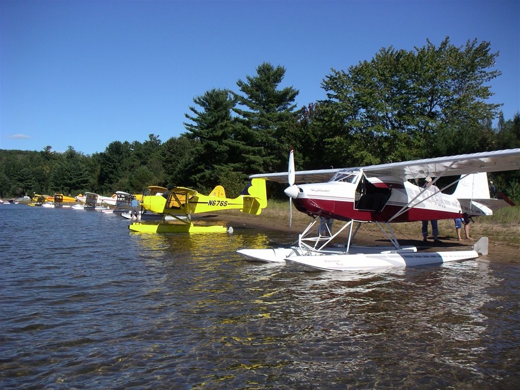

PostPosted: Sat Sep 30, 2006 4:39 am    Post subject: Graphics body wrap! Reply with quote
Hi Noel,
Didn't you know a good looking, exotic looking seaplane will attract good
looking, exotic looking women? <smirk>
Does my Kitfox get the same amount of attention? Hmmmmmmm........
Honestly, no. But women in general sure do think it is "cute". I'm not so
sure I like that whole cute thing, but anything is better than nothing.
Here's a picture of my "cute" Model IV at our annual Eagle River Seaplane
Fly In during the poker run (we fly 6-8 lakes) we had 3 weeks ago.
Incidently, my little Kitfox IV had no trouble whatsoever keeping up with
Husky Amphibs in the group. The Kitfox makes for one nice seaplane!
Oh yeah, that is my buddies Highlander in the foreground. If anyone is
interested that airplane is up for sale. (68K on floats, and 58K on
wheels). It was a Sun-N-Fun Grand Champion, plus Oshkosh Seaplane award
winner. Very nice airplane.
Paul
