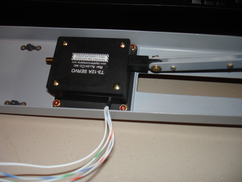

Was wondering if anyone else had this problem or not?
Before I mount the elevator trim servo bracket with the Ray Allen trim servo, I wanted to
think about the wiring. The wires make a real sharp bend due to the closeness of the mounting bracket.
See attached picture. Did anyone cut out a half circle in the bracket or just bend the wires and
cover with protective material?
Also, what wire did you guys use to hook up the servo?
I was thinking of ordering the WC2 5 wire Teflon Installation Cable from Ray Allen
at $1.10 per foot.
Thanks for the input

I left the sharp bend in mine, but the half circle is a good idea… There’s definitely enough structure to support cutting such a small relief for the wires.

I can't recall cutting the bracket but for wiring you might consider a shielded quad and a shielded pair of 22G wire. probably less expensive that the trim cable and shield can be grounded on one end if there are stray electrons running around in your airplane. Come to think of it I bought the cable and decided not to use it.

I drilled mine for a small hole and inserted a snap bushing so the wires come out of the side. Just drill the hole in the center of the side metal so as not to weaken it.

Since we are talking about Allen trim servos, what kind of wire connectors are people using to hook it to the wiring? Knife splice, butt splice, AMP PIDG or what? I ask primarily because the aileron trim servo is mounted on the left wing’s inboard inspection cover. And it seems like it would be nice to be able to “unplug it” in the future without cutting the wires.

I've seen two approaches used. 1. is on Aeroelectic.com where Bob
illustrates how to use a 9 pin d-sub with the flanges ground off and
then bound with shrinkwrap. 2. Ted French has used what I believe are
RJ45 connectors (I assume this requires a special crimp tool, but looked
like a nice solution.

I used 9-pin d-subs with zip-ties through the holes in the two connectors to hold them together and heat shrink from the back of the connector onto the wires.

I can’t remember any issues with the wire bend, but I got the MAC 5-wire servo wire from Aircraft Spruce for a little cheaper:
MAC SERVO WIRE 5 WIRES 20 FT
11-11550
$16.20
MAC SERVO WIRE 5 WIRES 25 FT
11-11549
$20.25
MAC SERVO WIRE 5 WIRES 50 FT
11-11548
$40.50
Marcus

Thanks for the idea of using the d-subs! Sure beats any can of worms I was coming up with. I asked our computer guy about the RJ45 connectors and yes they take a special crimping tool. As a side note, just had my wings inspected by our Tech counselor and he is very pleased with them. So just a few more steps and on to the fuselageJ

FWIW: RJ45 crimpers which do an acceptable job are not very expensive. (I've got a couple which are used for Cat 5 network wiring. BUT - In the high vibration, variable temperature environment of an airplane I wouldn't trust the RJ45s as far as I could through a Boeing 747! The d-subs, if properly secured are good, and there are several others which are better, but heavy and expensive.
