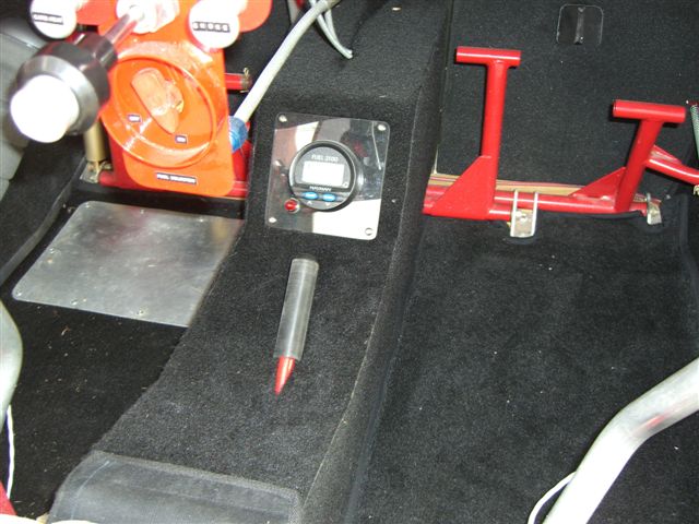

You have to make sure that you remember to update the gauge everytime you
add or remove fuel as it doesn't read anything from the fuel tanks. I also
fitted the Murle Williams low fuel warning light just to have a direct
contact with the actual fuel supply. I located both in a small consol that I
built for fuel management. See attached Foto.
You can see the low fuel light in the bottom right corner of the lexan cover
Hope this helps
Gary
