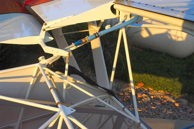

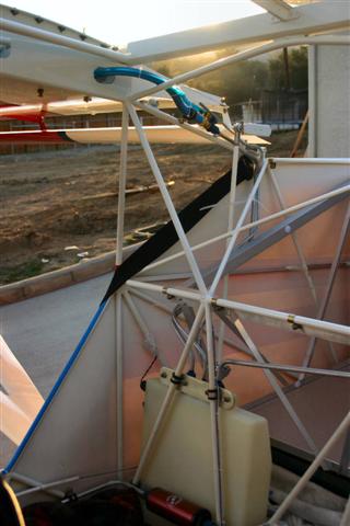

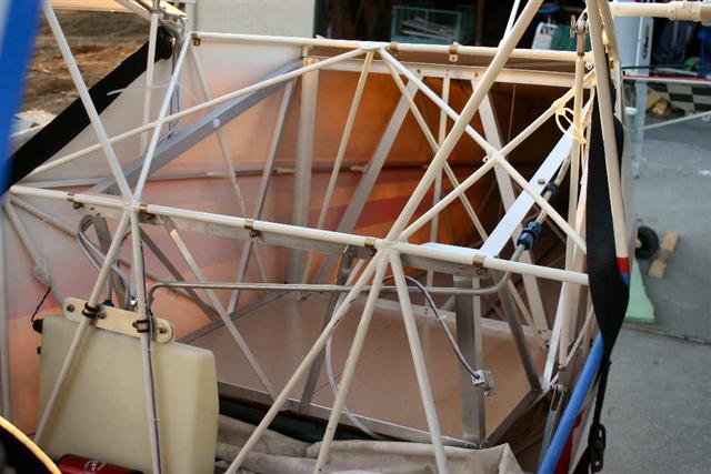

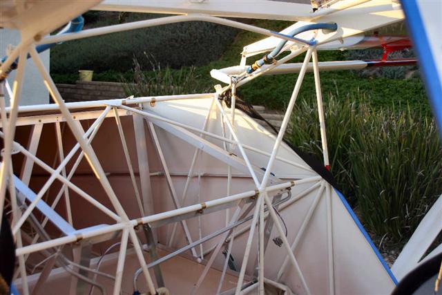

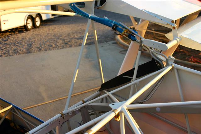

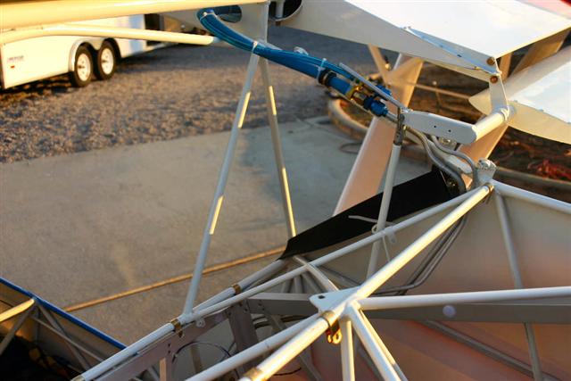

I wanted to upload these pictures of my Kitfox fuel system.
There's been some discussion about loops in lines so I wanted to show my
system which runs entirely "down-hill". The tank to header lines are 3/8".
The header vent is 1/4". The header to fuel pump, (not shown,) is 3/8".

I like it Guy. The lines are definitely retaining a downward slope and well
out of the way of potential damage. Other than the typical leaky header
tank fittings you shouldn't have any fuel problems with that. Nice job!
