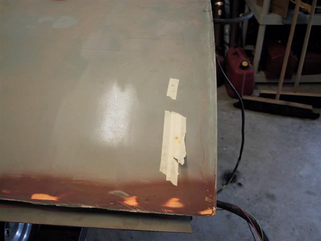

I have one tank that is weeping through the glass. I see Skystar had this problem and offered replacement at one time. Is there any way to repair this? from the outside? Inside? Sloshing seems to be out, I had as good a look inside the tank as possible with a small webcam on a dowel and they seem in good shape other than the small spots shown as dark on the masking tape.

Posted: Tue Sep 12, 2006 6:25 am Post subject: Leaky fuel tanks. |
Dave,
It looks like these tanks are new and never been installed. What year were they manufactured? What type fuel did you use that showed the weeps? With the rapid use of Ethanol, it makes the tank questions much harder. I for one do not think an outside patch is the way to go. I also don't feel comfortable with sloshes (Just my opinion). However, short of cutting the tanks open I might consider a large outside patch of glass and epoxy resin. I would always be suspicious of the rest of the tank area and future leaks.

Posted: Tue Sep 12, 2006 6:51 am Post subject: Leaky fuel tanks. |
Very small pinholes which is why Skystar used the internal sloshing
stuff. Clean it and and epoxy on the outside? The pinholes are very common.
Paul
At 07:04 AM 9/12/2006, you wrote:
| Quote: | I have one tank that is weeping through the glass. I see Skystar had

dosmythe(at)cox.net Guest
Posted: Tue Sep 12, 2006 7:12 am Post subject: Leaky fuel tanks. |
I might add one more suggestion if those are new/never installed tanks.
Clean the outsides very good. Mix up some good epoxy resin and coat the
entire outside of the tanks. Use a plastic scraper and put the epoxy on as
thin as you can. Epoxy (especially when lightly warmed with a hairdryer)
will wick into the smallest of pin holes. This might just add a little
extra assurance.
Don Smythe

Posted: Tue Sep 12, 2006 7:24 am Post subject: Leaky fuel tanks. |
Hi Don, these tanks have been used for ~500 flying hours. with avgas and CDN auto gas, so likely no ethanol. The show the laks I just tossed a gallon of gas into them and let them sit for a few days. I knew where it was leaking and wanted to see how bad it was. Is regular epoxy resin gasproof, I have some really nice tight weave fiberglass cloth.
