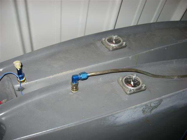

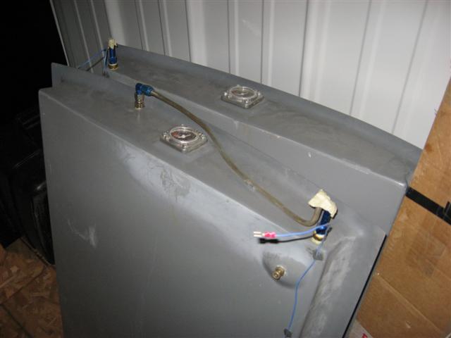

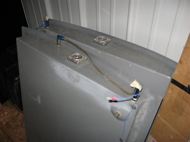

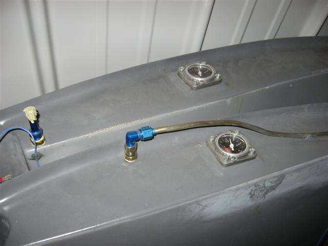

PostPosted: Sat Sep 02, 2006 5:53 pm    Post subject: Fuel feed problem Reply with quote
Yes the vent is at the top of the tank under the
flange. One can use a swivel 90 deg fitting. Some
have female threads so one has to use a close
union In any event they are available .Check
hydraulic supply houses. Check the car nut places
like Earls. Attached is a couple of pics foe an
even easier way using AN fittings & a straight
swivel from the hydraulics house + soft Al tubing.
Paul
