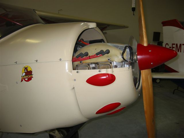

I did this conversion on a Model IV. The cowling work is the most
difficult. I left the aft cowling pretty much the same except for a little
bit of work on the aft bottom cowling in the exhaust area. I had to extend
the round bump cowling about five inches and widen it by splitting the top
and bottom in half. This past winter I made a brand new bump cowling which
took considerable time but it does look really nice. I have a few pics on
the Jabiru USA website.

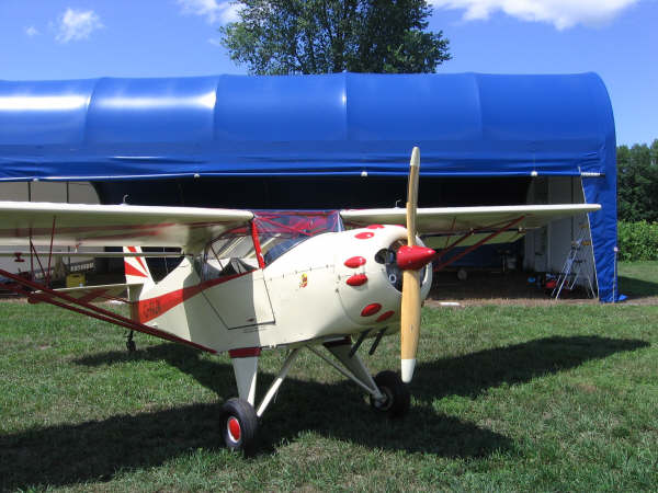

Hi
Here are a few photos of the cowl on my Model4 with Jab 2200.
The main changes on this installation relate to a bump on the Pass side
front cowl (about 4" x 2" to clear the No.1 rocker cover and cut outs in the
ring cowl to fit the inlets in the to ram air ducts. The rest of the front
opening is closed using clear lexan so that the cowling is not pressurized.
There is also additional opening and some aluminum fairings in the bottom of
the cowl to allow sufficient air flow through the cowl.
Like Michel my CHT and oil temps run on the low side of recommended
operating range.
If you would like more detailed photos I would be happy to send them off
line
Gary Algate
Model4 Jab2200

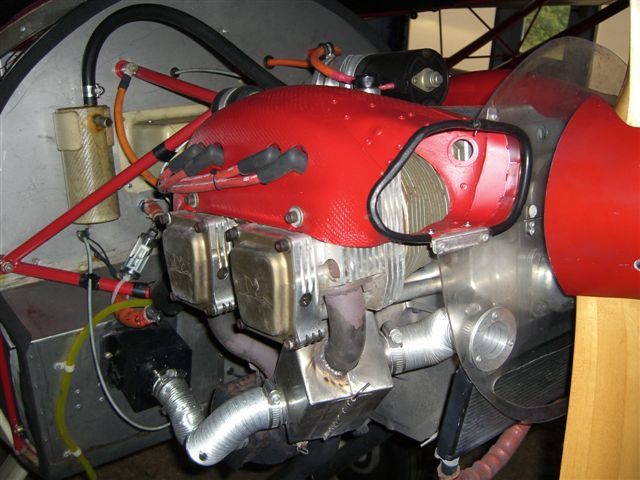

Wow, Gary, I was just looking at the heads on your engine, and noticed
how much more fin area I have around the exhaust pipe. Mine is the
newer engine, with larger heads, but I never realized how MUCH larger
'til I saw your engine. I had never seen a picture of the earlier
engine 'til now.

PostPosted: Tue Sep 05, 2006 7:28 am    Post subject: Jabiru 2200 conversion Reply with quote
Lynn
I haven't seen the newer model Jab so I don't know what to compare with. My
CHT's run at around 298 F at cruise during summer, so if you have more fin
area you must have great temps.

Go to Pete's (or Andy's I think) website and look at the engine
pictures there, and you'll see how much fin they added around the
exhaust pipe area, and maybe some on top too.
Probably better temps with the larger/newer heads, but the Economy
Tuning (lean burn) added some temperature, I'm sure...it sure did to
the EGT.

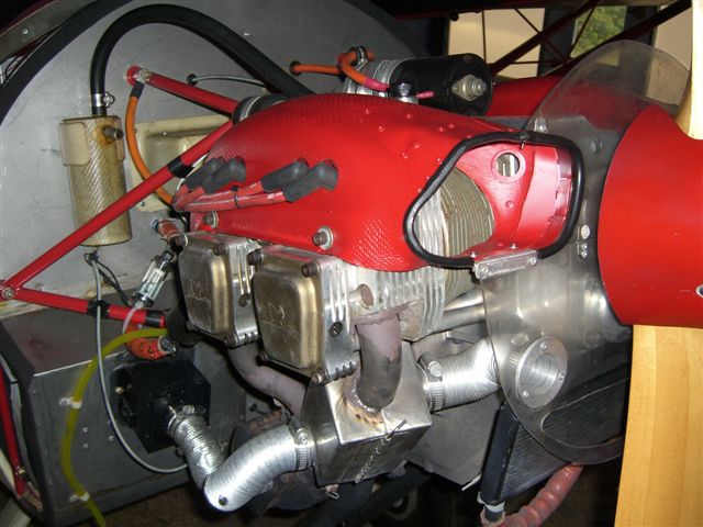

engine 'til now.
Lynn
