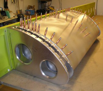

I have L section .025" spar cap and spar cap doubler .125 each and spar
web .040 as per drawing 6V4 all of which amounts to more than an A5 can
handle.
regards phil Plumley G-ZENI

Phil, that would be a *solid* rivet. Not very clear, as the drawing says "A5", but I did use
solid rivets on those "L" angles.
If the attached file makes is to the list, you can see it.

If you look at the detail at bottom center of drawing 6V3, it shows the
spar being riveted together with solid rivets. I'm not sure, but might
this also apply to these nose rib L sections?
