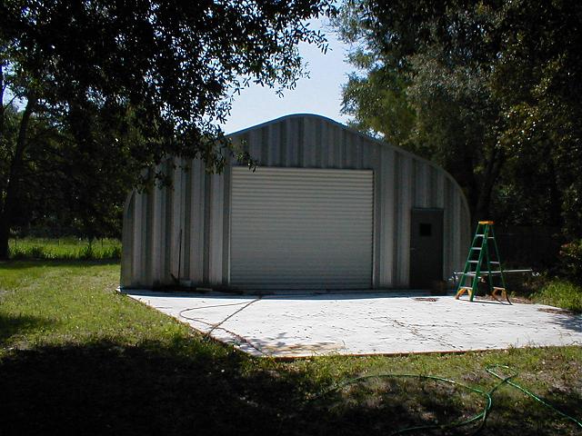

I like your hanger.
Tell us about it, please.
Did you build it?
Steve Boetto
Joined: 11 Jan 2006
Posts: 365
PostPosted: Wed Aug 30, 2006 5:16 am    Post subject: Steve's Hanger Reply with quote
Hi John,
I posted several items last year but I think you were traveling.
It is a modified Quonset. Cost was $7500 delivered to Fla from Pittsburgh.
Foundation and slab $7000
Large apron out front $3000
I bolted this thing together by myself in about 40 hours
30' x 40' at almost 15' tall
Add about $1500 for a roll up door and heavy walk thru door.
On a hot summer day it is about as cool as standing under a tree
Hut is rated at 150 mph sitting in full exposure
All the toys and everyone goes in at Hurricane time, Even the Ferret.
