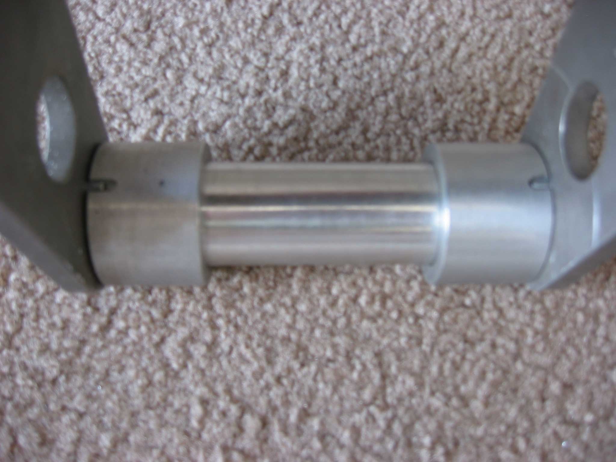

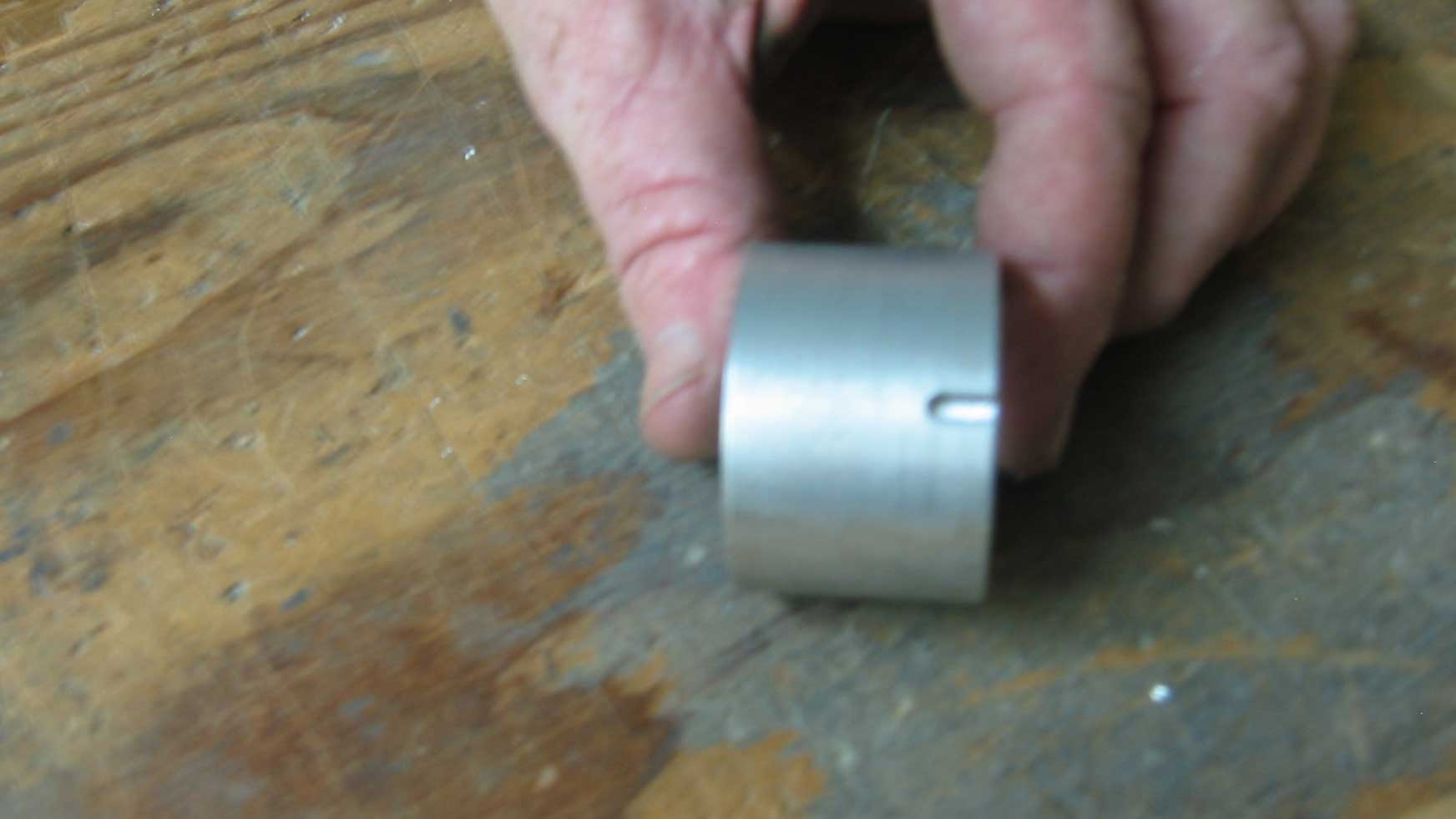

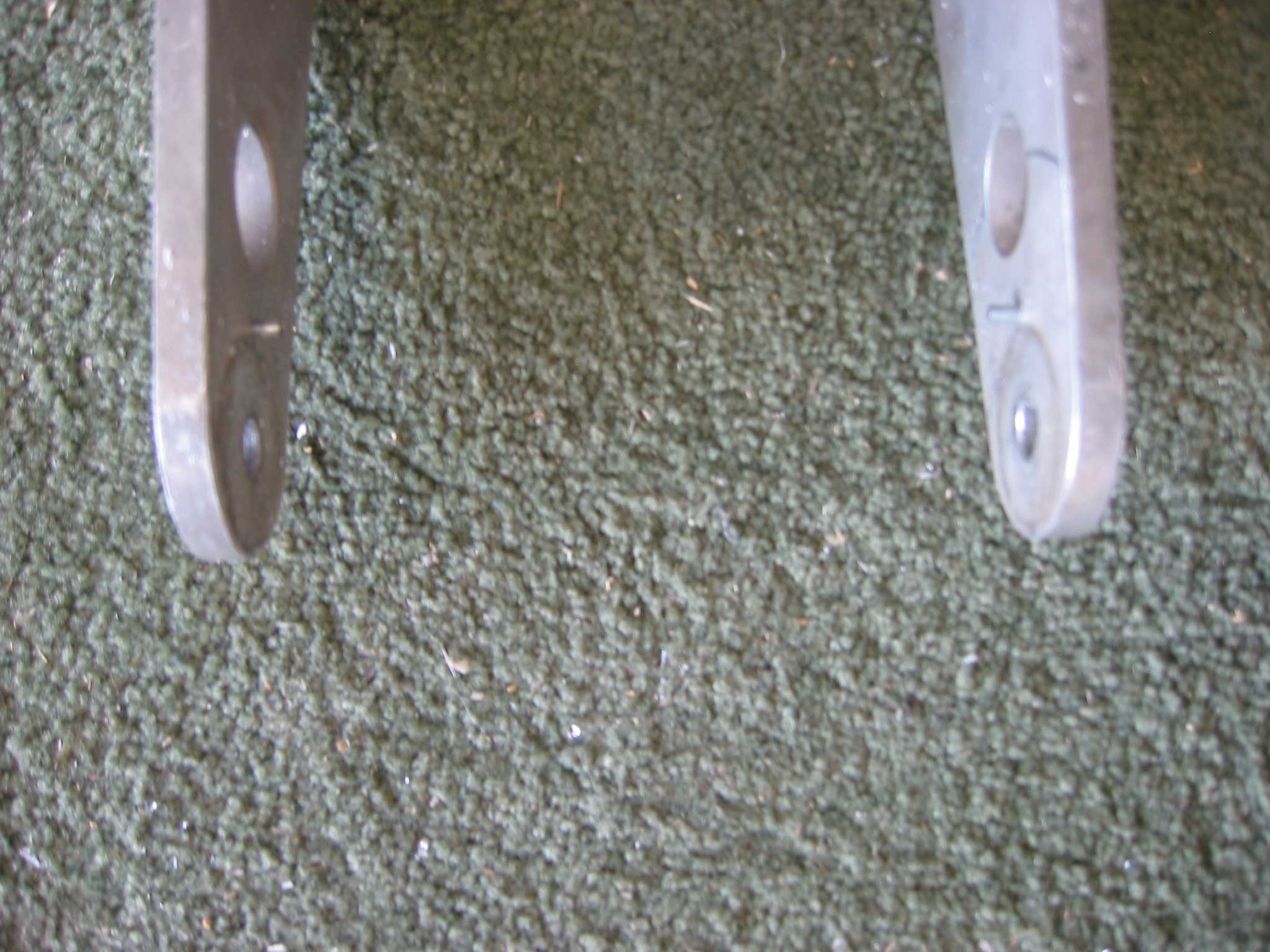

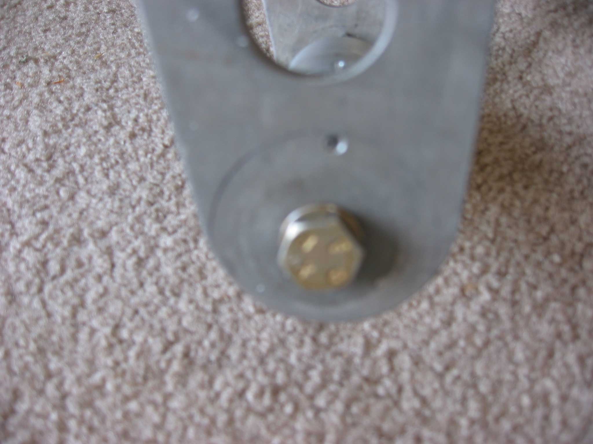

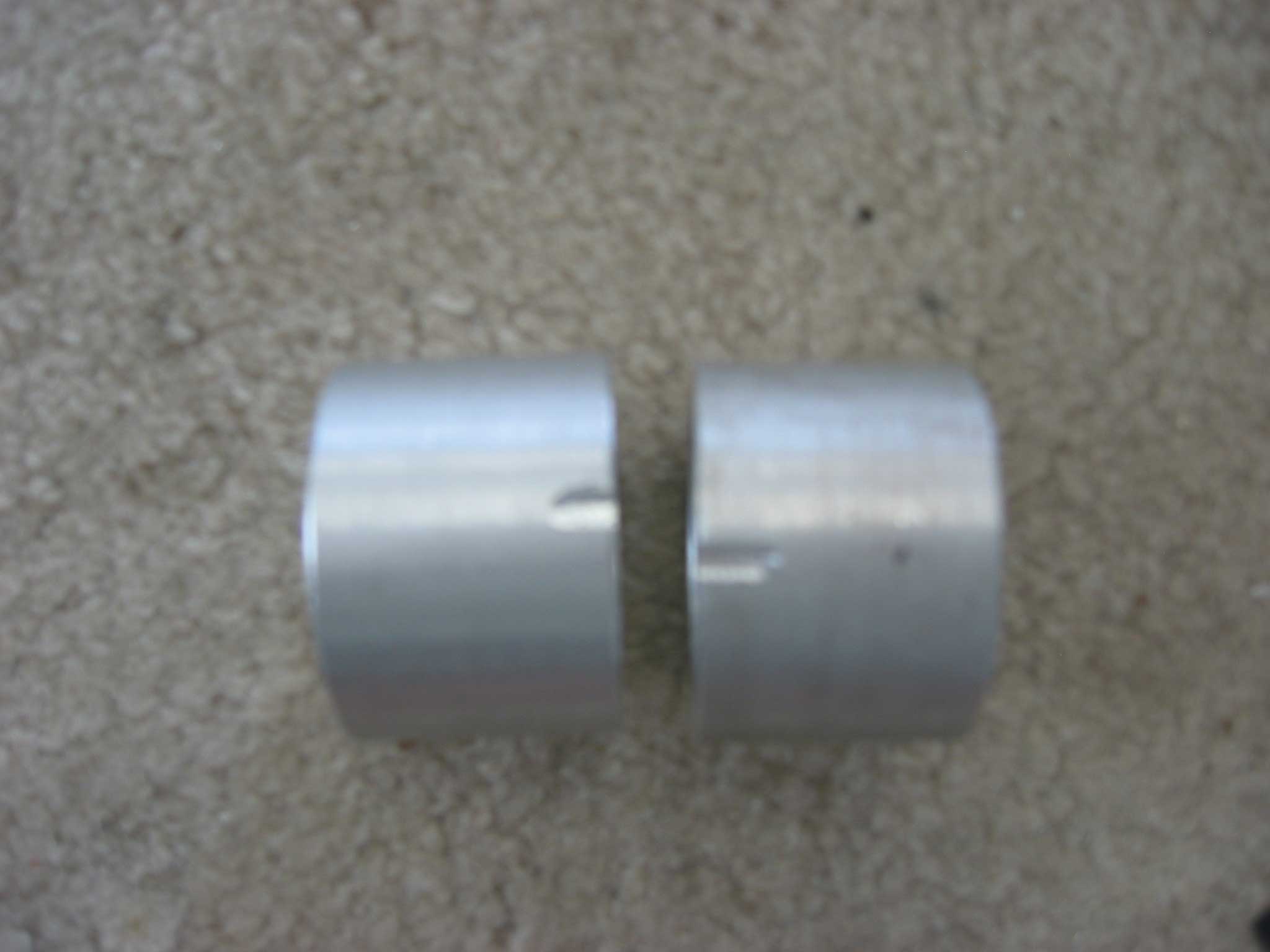

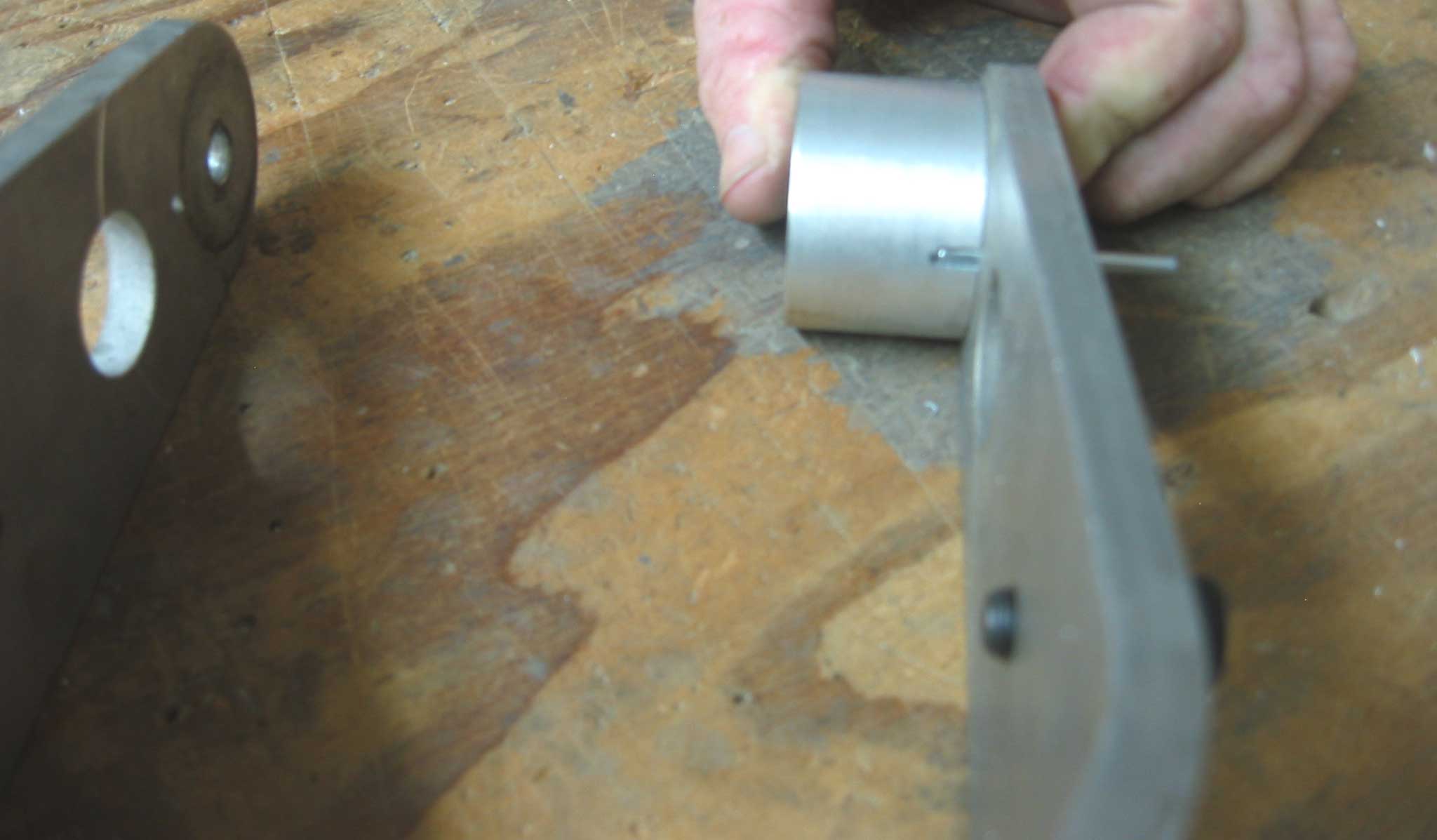

A good friend of mine was down from Iowa this weekend, I'm in the Dallas area, to help me on my plane. He is a very good A&P and I'm very lucky to have his help.

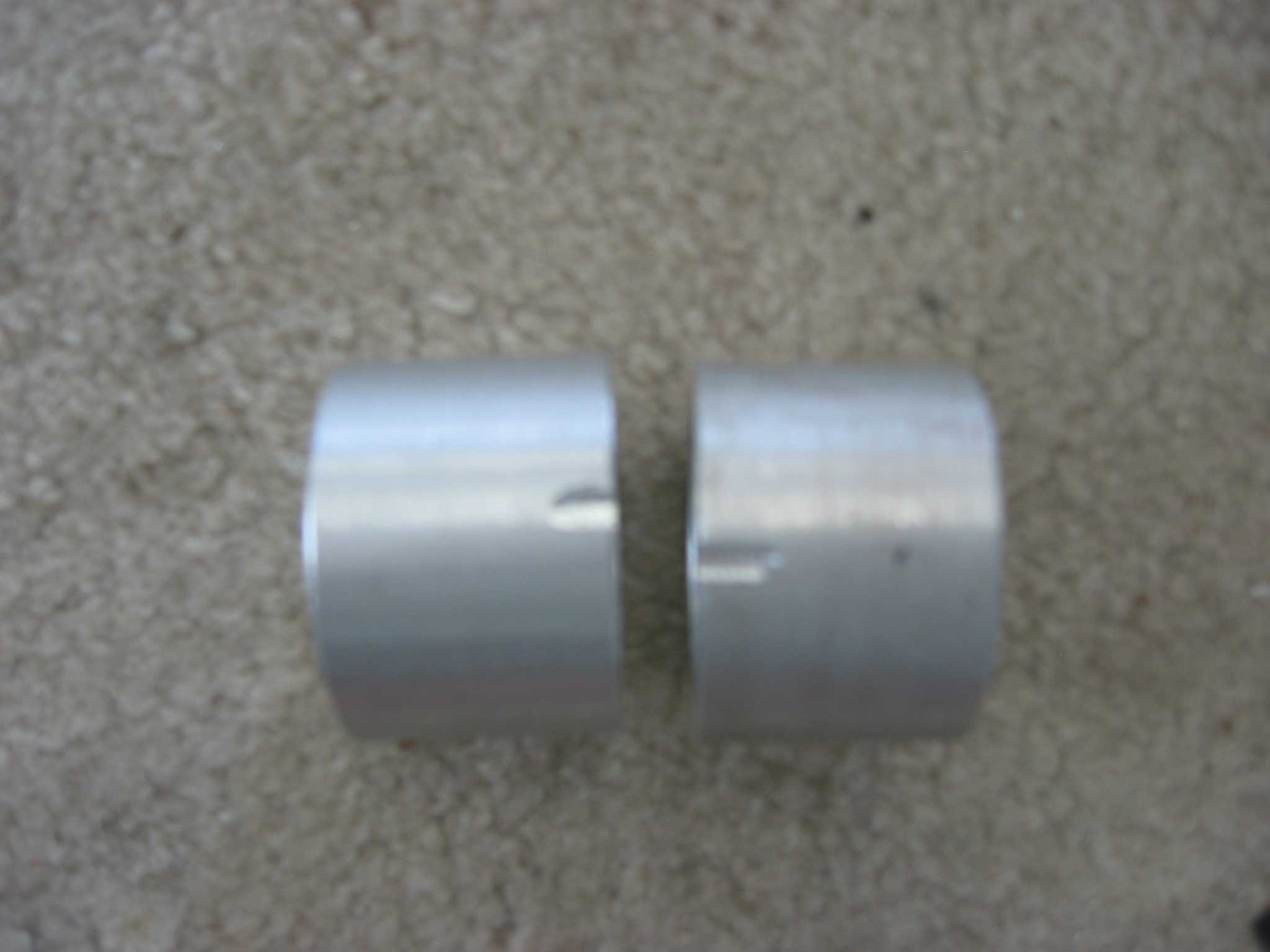

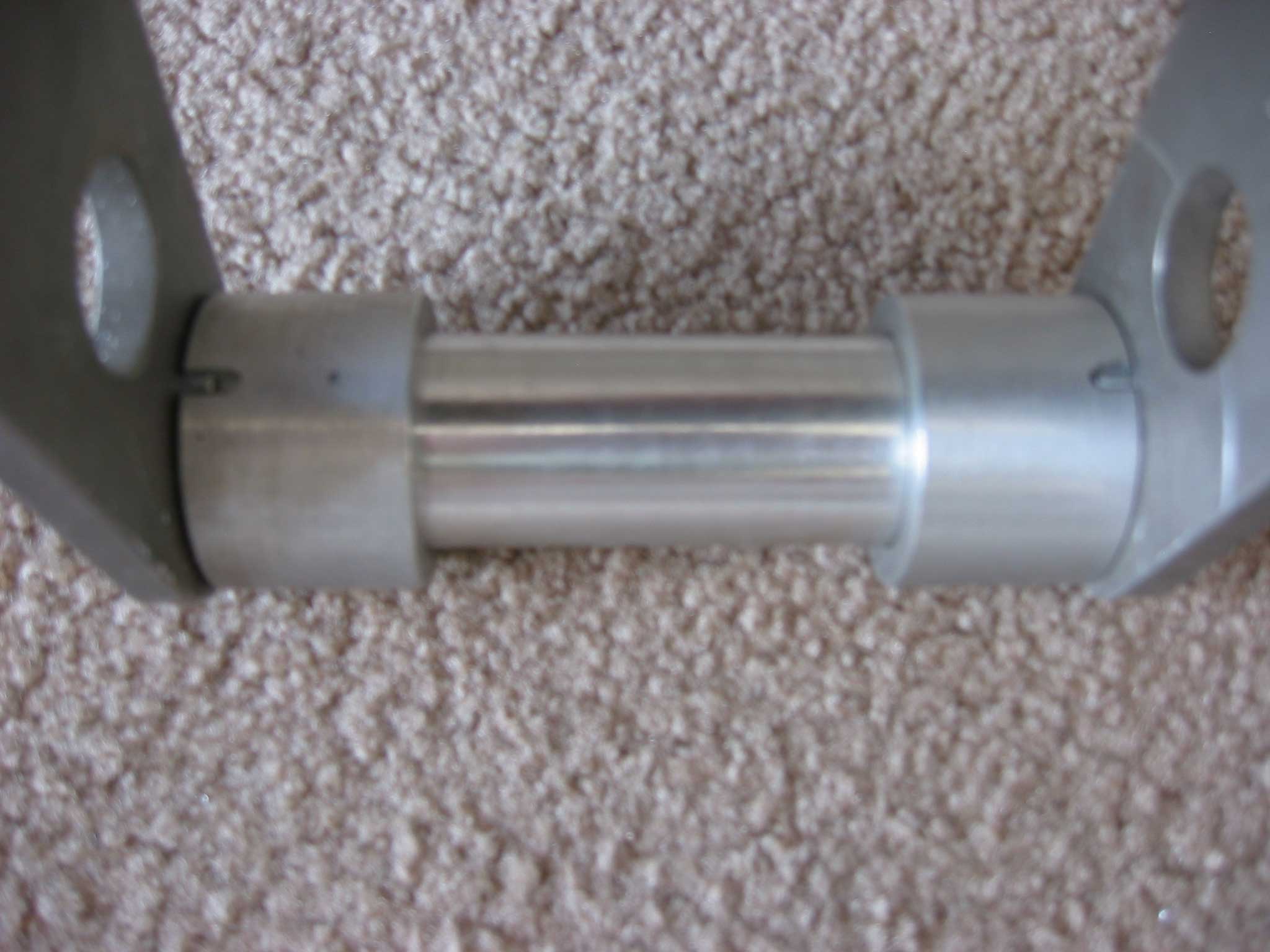

Anyway we discussed the front wheel bushing problems the 10 is having and here is the solution he suggested to fix the problem and I think it's a really a good idea. What we did was to take off the nose wheel fork and we drilled a 1/8inch hole into each side of the fork. We then inserted roll pins in each of the holes allowing them to protrude through into the inside by a small amount. We then took the newly supplied bushings and milled a small grove into the edge of the bushing which will allow the roll pin on the interior part of the fork to slide into. This method will definitely stop the bushing from turning.
I've attached some photos, which I hope will make it easier to understand. The focus on the pictures wasn't as good as I would have liked but you will get the idea. If you can't retrieve the photos because they aren't on the summary distribution just e-mail me if you would like to see them I will forward them directly to you.

That's basically what I had said was an excellent solution. I'd
do it myself, but with the deep grove worn in my fork, I'm not
sure how much I want to drill mine until I get a new fork.
But, one thing about that solution is that as it wears in,
you'll still have to worry about the bearing spinning against
the inner edge of that spacer if you don't have lots of tension
on it. The seal is draggy on that bearing, and you may end up
having the bearing not turn, but turn on the axle shaft instead.
If that happens, you're going to need to shave a little off your
axle shaft to get the tension back.
So you've got a great solution. Randy did about the same thing
a couple weeks ago. Just make sure the preload is good on
the bearings.
Tim

FYI
I just got off the phone with Ken K. the Engineer at Van's and he
enlightened me on how the new parts are to be installed on this nose wheel.
This may have been covered, but I didn't notice it.
First the axle is supposed to be "floating" in between the fork not at such
a length that it is compressed by the fork. I was under the impression that
it was supposed to be just the right length so that when the spacers were
tight against the bearing (causing the bearing to remain stationary) that
the axle would then be tight. I saw something about using a feeler gauge
and sanding the end of the axle. According to Ken the axle is used to
support the bolt and keep the bearings centered, and it's length should be
about 1/16" shorter than the sum of the other parts when torqued.
Second the entire assembly should be torqued to the torque spec for the bolt
that goes through the fork and axle. He says this seems like a lot of
torque, but Matco says that it is fine for that bearing and it gives enough
pressure for the new spacers to lock on to the bearing. He says the wheel
will be draggy, but that is the way it is supposed to be. Again at this
point the axle will be floating inside the assembly. The assembly can also
be checked simply by re-torqueing during inspection. This method of
adjustment skirts the 'this feels about right' method of adjustment.
Mike Lauritsen
