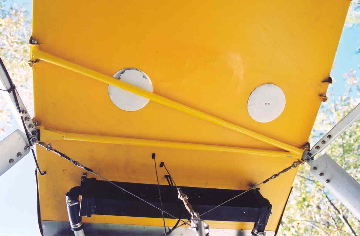

I recently received some info from a model 3 pilot flying Full Lotus floats.
He relayed " One item that was needed for floats on the models 1 through 3 is a brace across the bottom that I purchased from Skstar. "
I'd not heard of this before.
Does anyone have any knowledge or feel a need for reinforcement like this?
- see photo attached.

It appears that Skystar engineering felt this area needed some extra
strength.

Dave relayed that my photo attachment (sent via web view) did not come through.
I'll dupicate my question here and try the attachment via Email.
I recently received some info from a model 3 pilot flying Full Lotus floats.<?xml:namespace prefix = o ns = "urn:schemas-microsoft-com:office:office" />
Does anyone have any knowledge or feel a need for einforcement like this?

PostPosted: Thu Aug 24, 2006 6:43 am    Post subject: Re: Belly / float mount reinforcement Reply with quote
no photo attached ?
Dave,
The photo shows up in the forum link http://forums.matronics.com/viewtopic.php?p=56936#56936 where I generated my question. I also received the attachement when I received my posting via Email. I'll try again via Email to the list.
I have a brand new set of Full lotus at my shop now being installed on a beaver . Let me know if you need pics.
Yes....I'd love to see photos of your installations or parts/mounts.
It seem fairly basic and I know my needs are not unlike others - low weight + required strength. My model 1 low gross lives no room for excess.
Thanks!

PostPosted: Thu Aug 24, 2006 6:57 am    Post subject: Belly / float mount reinforcement Reply with quote
Richard,
I have not seen this brace before but I would certainly make one up if it called for.
Looks like a decent stiffner.
Now that is on front float gear attachment fittings. So Why would they not have one on the rear attach fittings as ther is more load there plus the added wing struts attach there as well.
I know some of the earlier Kitfoxes that is was a weak spot , expecially on hard landings.
Dave

PostPosted: Thu Aug 24, 2006 7:30 am    Post subject: Belly / float mount reinforcement Reply with quote
I have that brace on my plane. as well as a strake under the vertical stabilizer. You can hit pretty hard if there is a decent wave at all so the brace seems ok to me.
Noel [quote]

PostPosted: Thu Aug 24, 2006 8:16 am    Post subject: Re: Belly / float mount reinforcement Reply with quote
Noel sez: I have that brace on my plane
I'm glad to hear about this support at this point 'prior to mounting'.
Deke sez: It appears that Skystar engineering felt this area needed some extra strength.
Yep, I guess so.
Dave sez: So Why would they not have one on the rear attach fittings as there is more load there plus the added wing struts attach there as well.
I'm curious also.
I welcome other input or experience.
Thanks!
