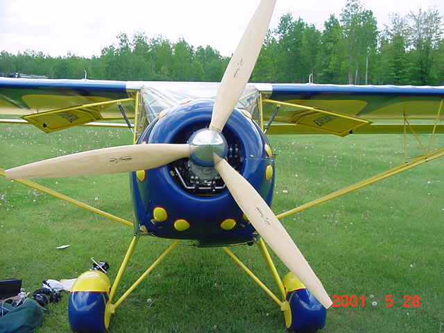

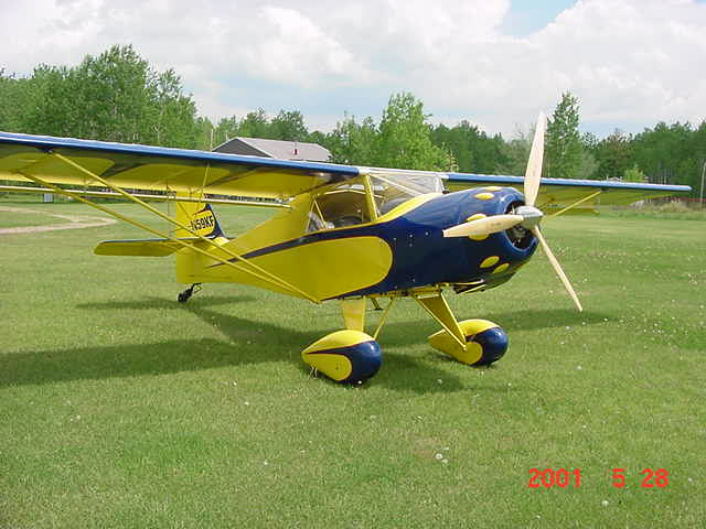

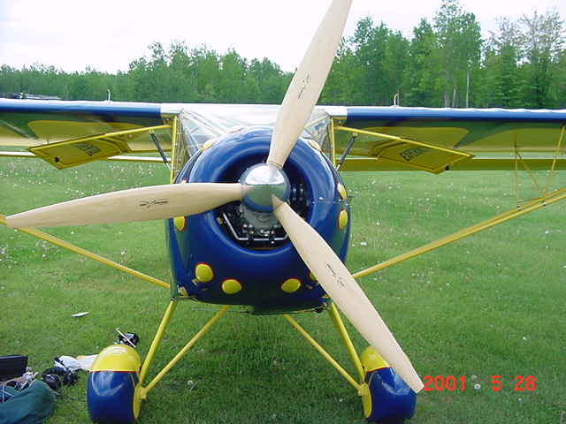

I built and flew a Model IV XL Series with a 503DCDI with a 3 blade ground adjust GSC for 5 years. The kit was sold by Skystar with that engine option. My empty weight was around 530 pounds, and useful load was 420. I was pleased with the performance for a 52hp bird, it would get off the ground faster than the 150 I was previously flying, about 500' on grass and 200 on pavement (or less with a head wind). I have flown all my children in it but not enough gross for me and my wife, I am 6' 2" 220 pounds. I flew the plane into Oshkosh Airventure 3 times and I was loaded to the max when I did it. It had two 6 gal wing tanks and a custom 10 gal aluminum header tank behind the panel. I would get 70 MPH cruise at 5900 RPM climb was at 55 MPH (at) 6400 RPM and I would get about 700' / min with me in it, had wheel pants but no strut fairings. Was pleased with the engines reliability, when it would get very hot, (like airventure time) I would have to make a jet change to maximize engine performance. Was a blast to fly, but then I think they all are. Is it the best engine for the 3, I don't know, If the price is right and the numbers fit it might for now. I am building a 5 with a 912, I am sure I will like it better but I have nothing but fond memories of my 4 with the 503 in it.
