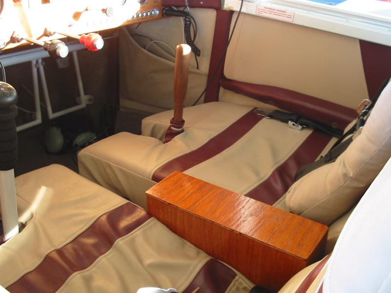

You might consider a small removable console. This works pretty well for us
(175 lbs and 120 lbs). picture attached. Do not archive.
Dale

>I would like to eventually after flying have
> a arm rest in the center.
Tim:
The simple answer is DO NOT INSTAL A CENTER ARM REST!
1 - There is not enough room.
2 - It will be in the way when you Need to work under the panel ... And you
WILL need to work under the panel.
3 - Unless you and your copilot are 100 Lbs each There is not enough room.
Yo already will be bumping elbows and maybe even butts.
4 - The RV-6 does not need an arm rest, your legs are your arm rests.
5 - I have always preferred MANUAL FLAPS but both RV-6's I fly have electric
flaps. They are acceptable. But, I still prefer Manual.

Well....don't know how simple my answers will be but I'll interject some
differing opinions.
Guess this is sorta subjective. The several armrests I have seen in RV's
are only about three inches wide (the width of the space between seat
cushions, and the pilots I polled seemed quite happy with the armrests.
My hangarmate put an armrest in his RV-6A and its still there after ~800
flight hours.
This situation is resolved by making the armrest easily removable.
One rationalization I have heard for the armrest to *prevent* bumping
posteriors. Wink
Tim wants an armrest because he has a throttle quadrant and wants to
brace his arm. Even though I don't have an armrest in my plane, if I
didn't have the cupholders between the seats I might have an armrest
with a little map pocket in it.
