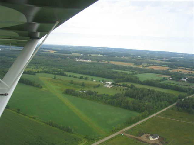

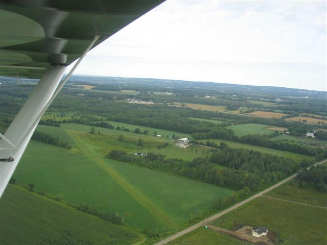

I think a lot depends on climate and drainage. In N.Ontario most of the privately developed strips are mounded so that during the thaw the strip remains dry and useable in Spring. Even in the clay based soils this still works - they basically move the soil to the centre if the strip and then roll it to contour the desired run off. Once seeded they continue to roll and after about two years they are perfect and useable year round.
I have attached a photo of our strip and as you can see the approach is interesting as you fly between two telephone poles on final (The wire goes underground) but passengers can find this a little disconcerting

Looks like a very nice strip.
