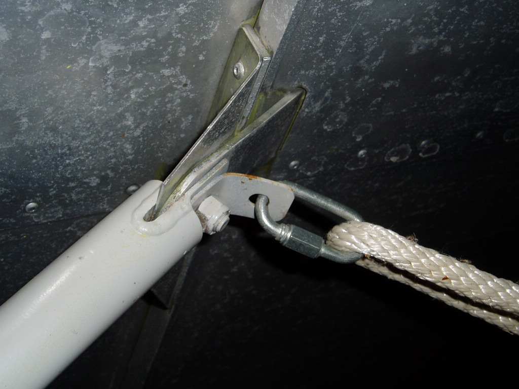

Here is what I did. The added piece is from 1/16" 4130 sheet. I put the
"quick link" through the hole in the 4130 and tie the rope to it. I carry
the quick links with me.
Chuck D.
N701TX

PostPosted: Tue Aug 15, 2006 6:45 am    Post subject: Re: 701 wing tie-down points Reply with quote
Thanks.. didn't think to check the plans, and not sure mine will have it, mine are circa 2003, but will check. And thanks for the pic, Chuck, it looks like that would work well too. So I should be all set.
