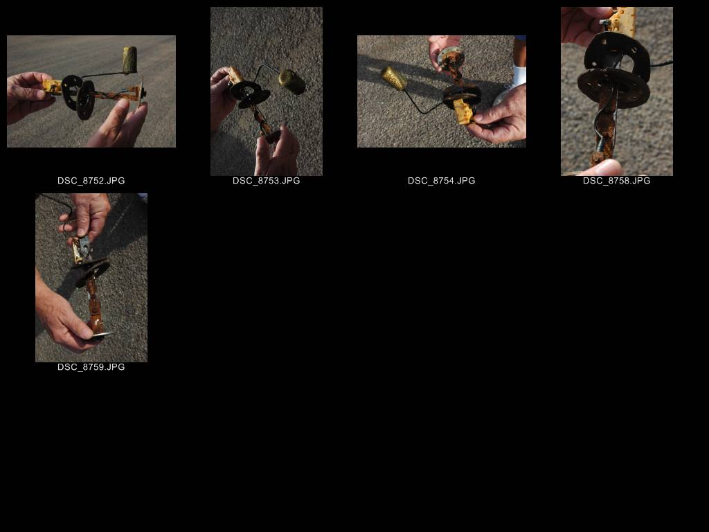

Try to salvage or toss?
It's soaking in solvent, but a cruddy, corroded mess. Arm is free.
jsf
--> Kolb-List message posted by: "David Key" <dhkey(at)msn.com (dhkey(at)msn.com)>
The arm could be stuck. Take your gauge out. Then move the arm up and down.
If your fuel gauge moves then your arm was probably stuck or the short is on
the sender side. If the gauge doesn't move when you move the arm then your
short is on the gauge side. If you replace the gauge then go with one with
numbers near 30-250ohm. I forget the exact numbers but those are real close.

I have an aluminum tank so the fuel guage is a very important insturment to
me. I'd put a new one in in a second. Looks like you got your money's worth
on that one. But you still need to see what your problem was so does the
fuel guage move when you move the arm?
on
close.
