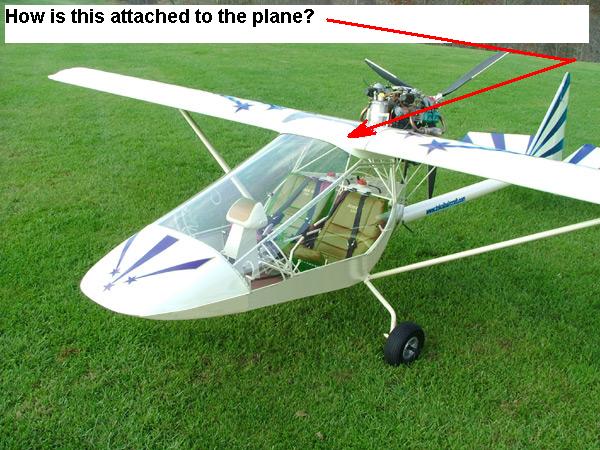

How is the thing between the windshield and the gap seal attached? Rivets I
bet but I'd like to know.
David

You're right. Rivet the fairing to the wing gap seal. Mine took a great deal of fiberglass work to fit properly.
Jim

On my Xtra this piece is riveted to the gap seal/greenhouse and then0 velcroed to the wings. The entire assembly comes off for wing0 folding opening up the whole top of the airplane.
Larry
MKlllx / 582
Nice looking airplane

I checked today on the MkIIIx that shares hangar space with me. You were
right, it's rivets.
-Ken
