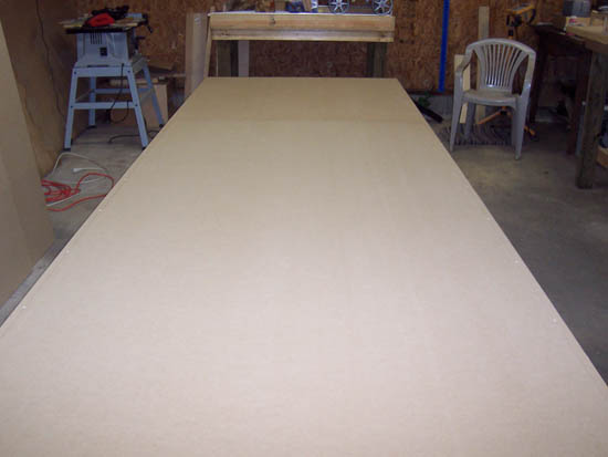

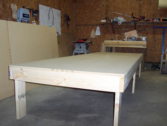

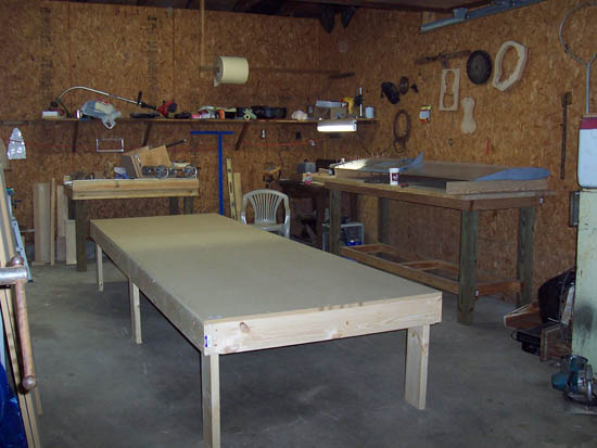

randy(at)n344rb.com Guest
Posted: Fri Aug 11, 2006 5:50 pm Post subject: 12' x 4' Workbench Ideas |
Yep... I agree... Here's my table made with 2X6's and an MDF top... It
works really well..
