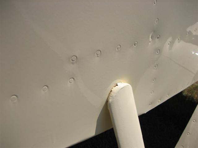

Let me just put some pictures to these statements. Some items are
bubble wrap for a heat shield, beat to hell skins, some finish work that
would make an amateur blush, rusted door hinges, paint bubbling from
rust on steps, screws falling out and fairings improperly fitted and
falling off. Of course pictures don't show the detail but you get the
idea.
