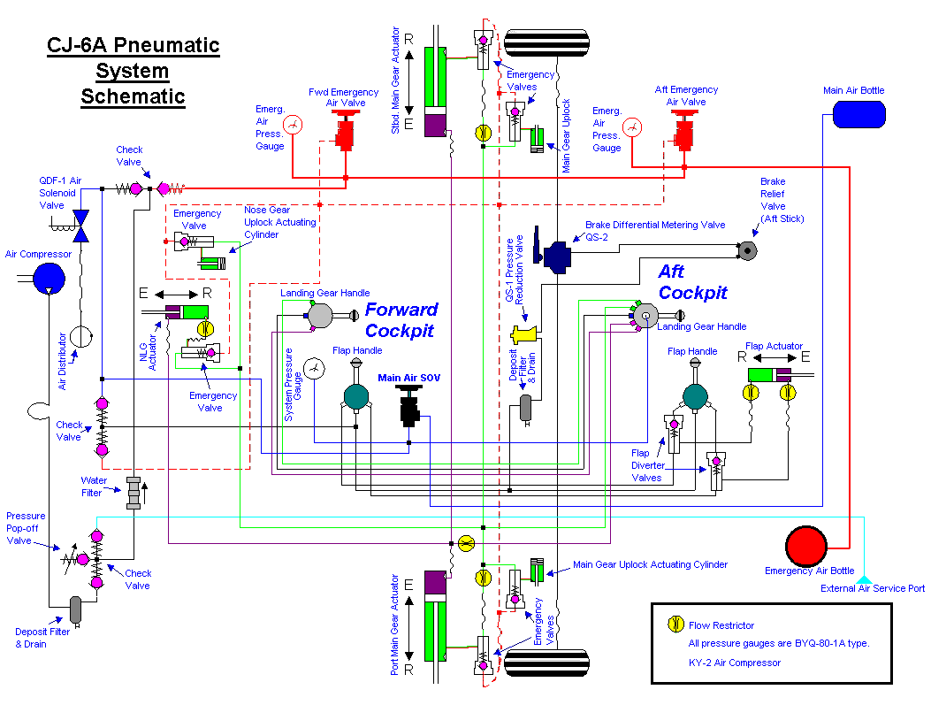

Does anyone have a "good" scanned diagram of the CJ-6 flap pneumatic system
Med Ragheb

The attached should help. It's a "good" scanned diagram of the CJ-6 flap pneumatic system.
Enjoy.
Jim B

This is outstanding.  I just had a great afternoon with a bunch of great CJ and Yak guys here in Oshkosh.  I like this group already.  Once again, thank you very much the schematic is great - it is almost "Med Proof"
All the best,
Med
