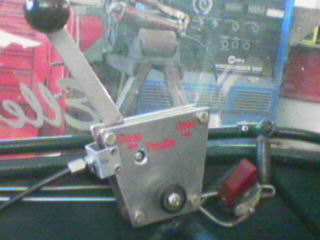

ElleryWeld(at)aol.com Guest
Posted: Tue Jul 25, 2006 8:30 am Post subject: Throttle to Cable Question... all models |
That don't look like a good idea Your throttle cable is going to fail sooner or later because of where it is bending in the pic
Dont ask me how I know this
I replaced the throttle with a Quadrant from CPS California Power Systems I did a little mod to it but it is much better and less wear on the cable
heres a pic of it
Ellery in Maine

Joined: 09 Jan 2006 Posts: 4639 Location: Titus, Alabama (hauck's holler)
Posted: Sun Jul 30, 2006 1:24 pm Post subject: Throttle to Cable Question... all models |
fail sooner
| Ellery in Maine
Ellery/Gang:
I have found nothing wrong with the standard Kolb throttle, which I
have used for a good period of time.
I do replace my throttle cable every 500 to 600 hours as a precaution.
I also replace the cotter pin with a 3/32" clevis pin.
mkIIl
_________________ John Hauck
Titus, Alabama |
