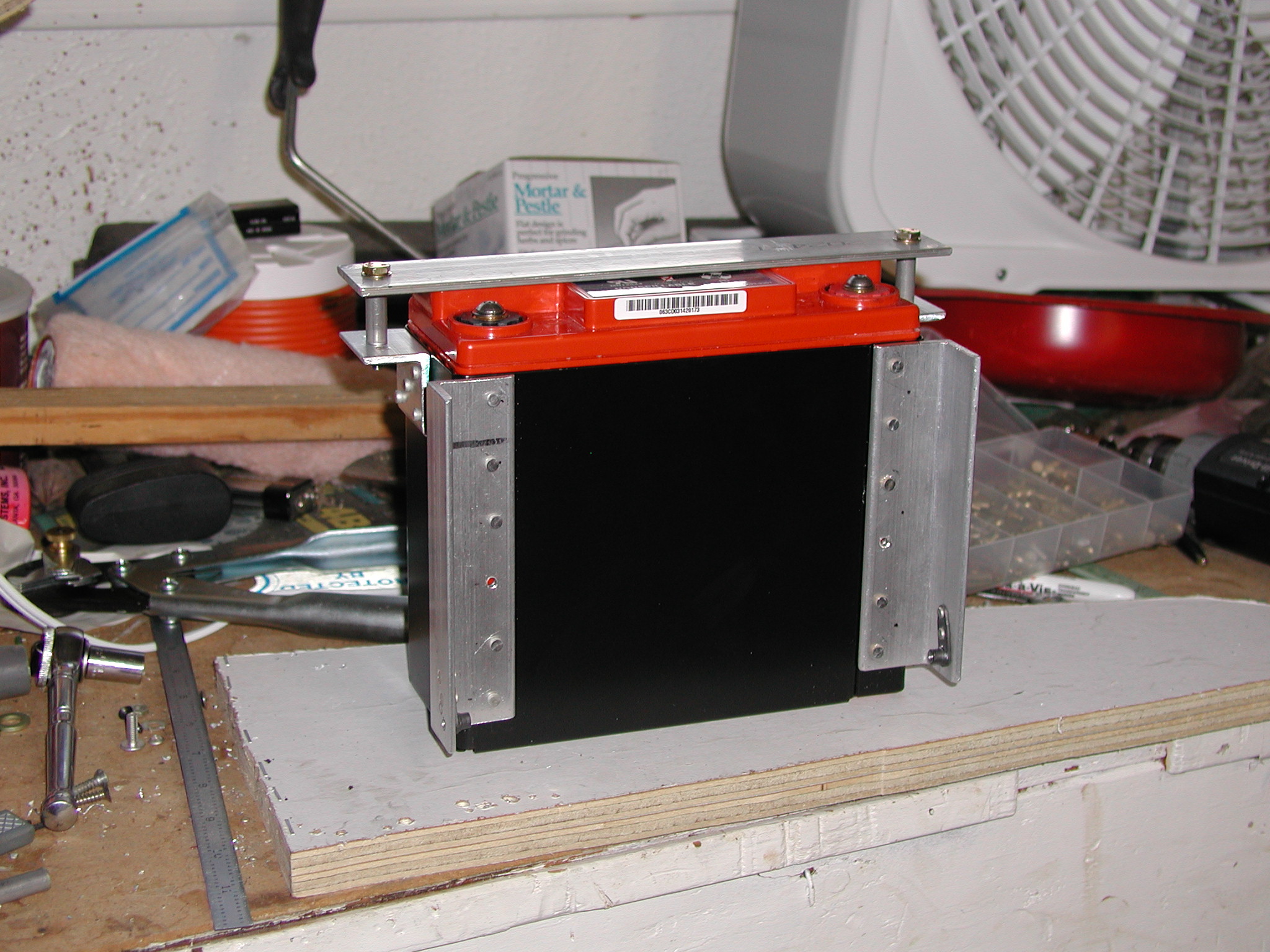

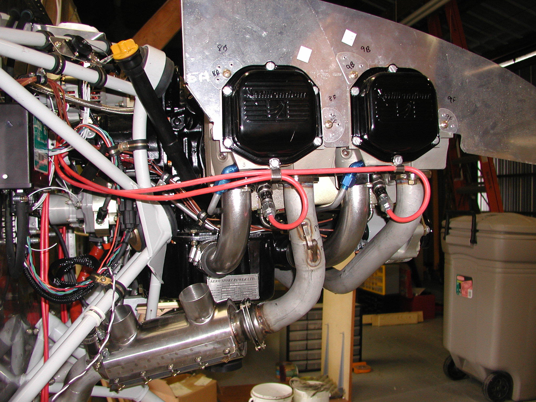

My 6A with AFP injected O360 & MT CS prop has an Odyssey (I think that's the same battery) mounted on the aft side of the firewall right below the cutout pan. My LASAR box sits firewall foreward approximately where the firewall foreward kit would place the battery.
I know that some other things go there if you're building your 7A strictly according to plans but I did mine before the firewall foreward kit came out and I'm not unhappy about it. I'm putting my heater vents (two) on the outboard edges of the firewall as I have two heater/mufflers on my vetterman crossover.
I've got more photos of it in it's place at home if you're interested.....I changed the top restraining bar to a fore/aft from the port/starboard arrangement as I wasn't sure about the clearance with the inboards of the rudder pedals.
The way mine is set up there are two nutplates at the lower corners of the attachment angle that allow the battery box to 'hinge' aft for maintenance after loosening them one turn and removing the two top bolts from their attaching nutplates. The assembly is mounted just low enough to get the allen wrench in to remove the battery cable attachment screws.
