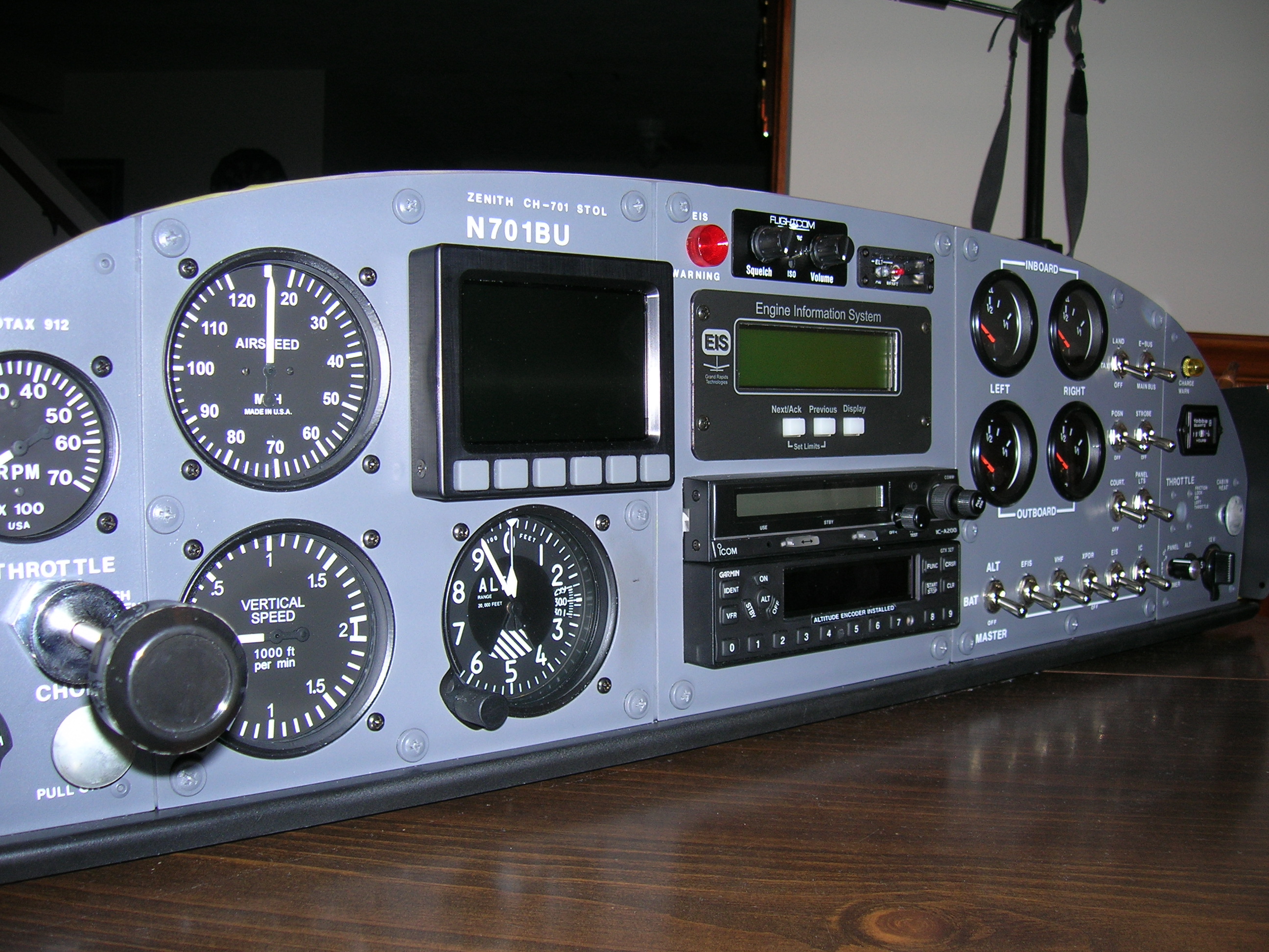

I've attached a pic of panel, hopefully seen at http://www.matronics.com/forums
Lettering has been done with rub on letters and numbers from tower hobbies.
Base paint is grey rustoleum glossy, letters applied and then applied a rustoleum flat clear coat. Used blue painters tape to line up letters and numbers to keep straight. It took alot of time but looks like a military style panel.
