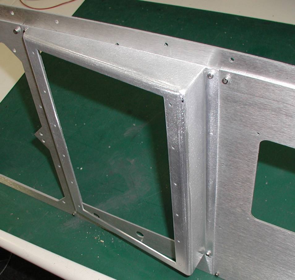

1. What things can I go ahead and attach to the instrument sub-panel
while it's 'transportable' i.e not riveted to the Fuse?
a. Other than the modifications to open up areas for avionics
mounting, what other access holes have builders put in the sub-panel?
I put a larger one in. No huge reason, but it ended up coming in
handy to use as arm and vision access while mounting the Lightspeed
and WSI stuff on the aft side of the upper firewall. I put a bunch
ov various holes in the subpanel for wire passthroughs.
b. has anybody installed anything on the FORWARD side of the
sub-panel? What?
c. Any other recommendations for sub-panel work before
installing the upper fwd fuse?
Jesse: I just put in one big hole for the radio stack, then used the bottom
of the sub-panel to hold adel clamps that all of my wires go through, then
put holes and snap bushings in the sub-panel to route wires through to the
firewall and down to the sides of the plane. I have my instrument cooling
fan, power distribution bus block, MAP Sensor, Ammeter Shunt, and dimmer
boards all on the sub-panel. That makes it really nice to work on the
wiring just by removing the panel. Also, I have the crossbar under the
instrument panel (although removeable with screws) there as an armrest
if/when needed. In N256H we almost completely removed the sub-panel and
then used angles to stiffen it back up, but then we had no good place to
mount all of the things mentioned above. To each his own, but this worked
great for us.

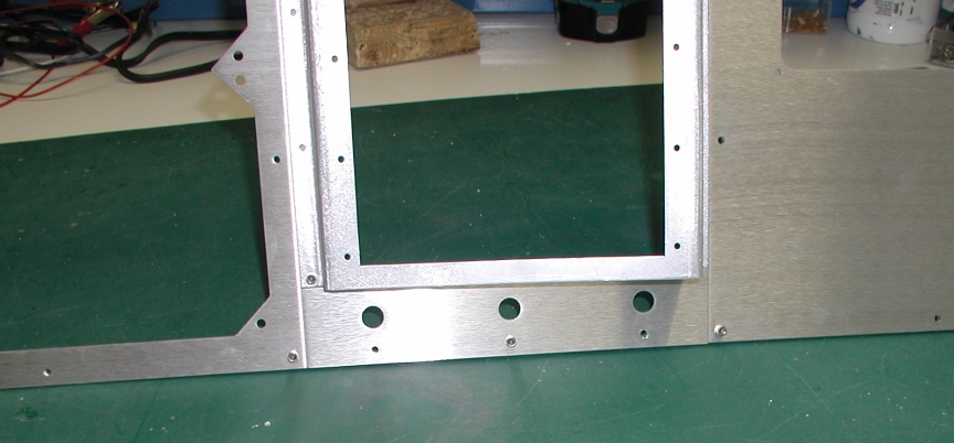

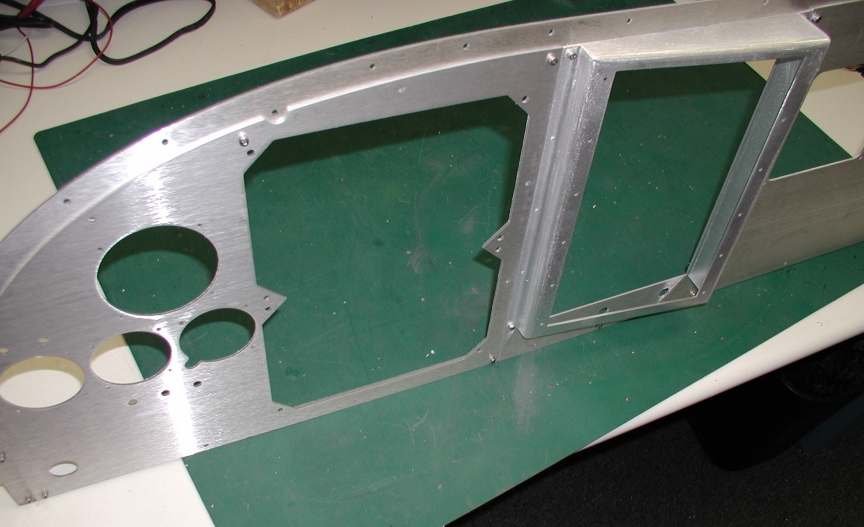

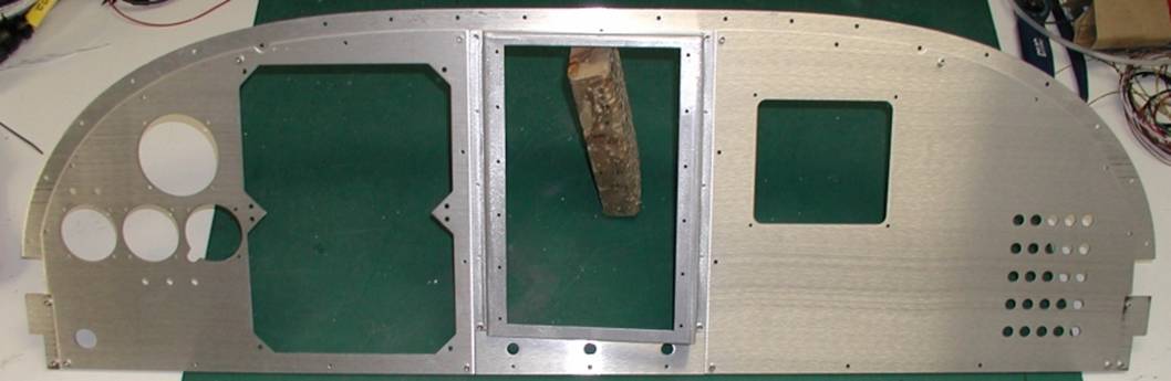

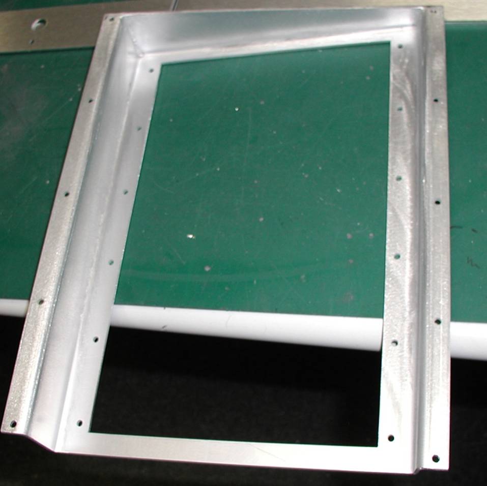

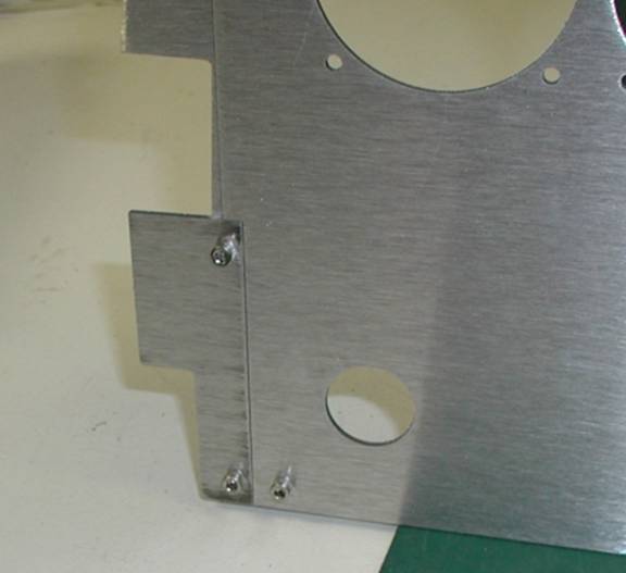

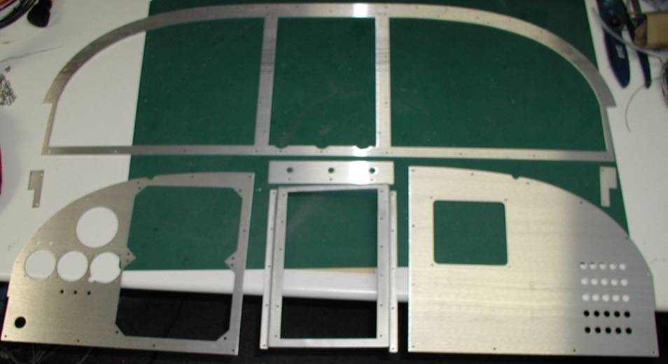

PostPosted: Fri Jul 14, 2006 3:47 am    Post subject: instrument sub-panel, fwd fuse and cabin cover questions Reply with quote
John,

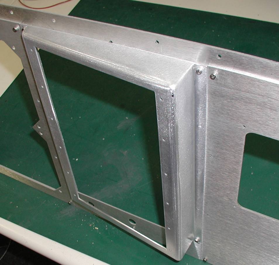

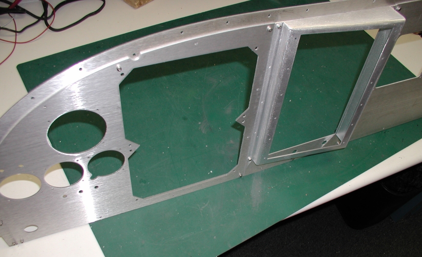

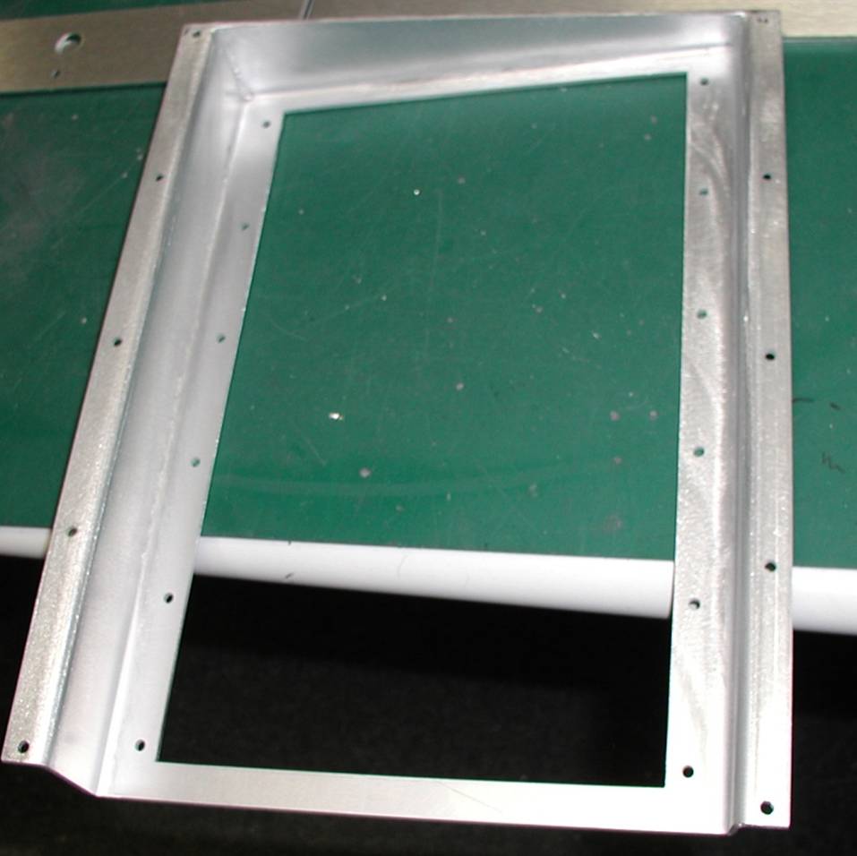

I am having Stein's group build my panel and they will be using the modular type panel like the photos that are attached. Apparently it is a very flexible unit, depending on what you want. The pictures shows it as already being cut but they obviously cut it to whatever you need. It's also, I believe, about 2" longer than the panel from Van's, allowing a little more room to fit stuff in. I like the idea that I will be able to take section apart to get at the equipment.
Wayne Edgerton #40336
working on the baffling baffles
[img]cid:006a01c6a73a$9405fd00$7601a8c0(at)MainOffice[/img]
[img]cid:006b01c6a73a$940846f0$7601a8c0(at)MainOffice[/img]
[img]cid:006c01c6a73a$940846f0$7601a8c0(at)MainOffice[/img]
[img]cid:006d01c6a73a$940846f0$7601a8c0(at)MainOffice[/img]
[img]cid:006e01c6a73a$940846f0$7601a8c0(at)MainOffice[/img]
[img]cid:006f01c6a73a$940846f0$7601a8c0(at)MainOffice[/img]
[img]cid:007001c6a73a$940846f0$7601a8c0(at)MainOffice[/img]

jesse(at)itecusa.org
PostPosted: Fri Jul 14, 2006 5:29 am    Post subject: instrument sub-panel, fwd fuse and cabin cover questions Reply with quote
Very nice!  Cost?

AV8ORJWC
Joined: 13 Jul 2006
Posts: 1149
PostPosted: Fri Jul 14, 2006 5:45 am    Post subject: instrument sub-panel, fwd fuse and cabin cover questions Reply with quote
A truly breath-taking example of quality construction, excellent
aesthetics, improved function and the best serviceability of any RV-10
panel yet.
Your's give's Jim Hergert's N6XE panel a major run for its money. Jim's
is my benchmark for High Score (as Randy, Tim, Deems and others already
know). You have raised the bar and hopefully others will take the
challenge. It is great to see a three dimensional approach to leave the
two dimensional panels on the birds of the past. The pictures are
worthy of archive and further study.
Congrats Wayne!
Did you do the fabrication and send it to Stein or is this his work as
well?
John - $00.02
