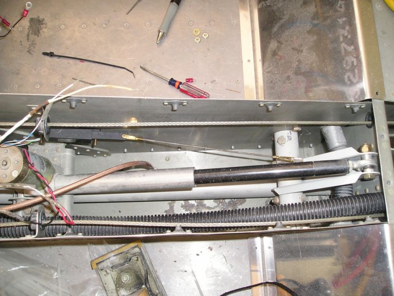

I would like to hear from anyone who has mounted a Ray Allan flap position
sensor (POS 12) on the flap system to drive a Ray Allan LED indicator. A
picture or description of where and how you mounted it would be most
appreciated.

Photos attached of my POS 12 mount. I used 2 pieces of .032 angle, one screwed to the tunnel wall and one pop-riveted to the flap actuator. I connected them with a piece of threated model aircraft pushrod with a brass clevis on one end and a Z bend on the other.
You can also see the flap switch I installed for my Advanced Flight Systems AOA Sport systems.
-Jim McGrew

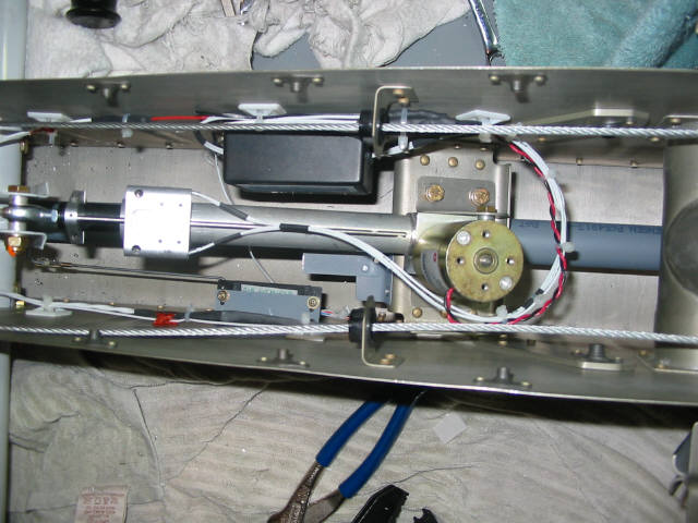

Here is how we've mounted the one in N184JM.
The push rod comes from a remote controlled airplane store.
Grumpy #40404
