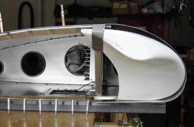

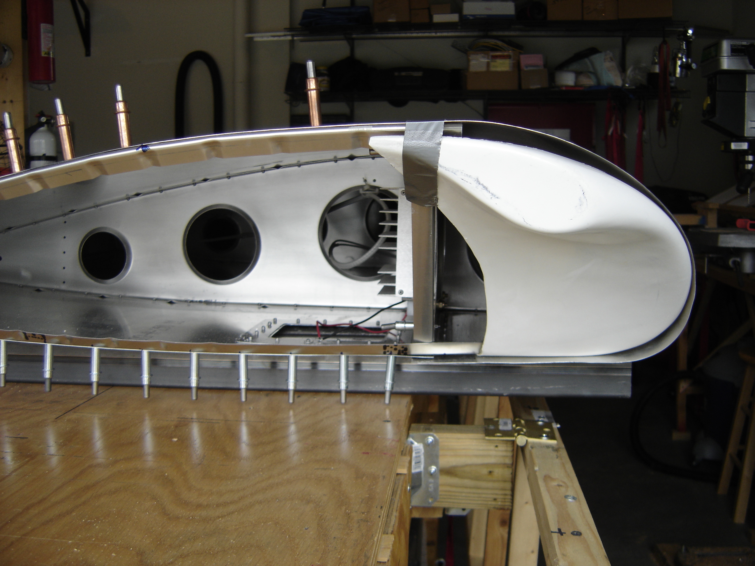

Do any of the 701 builders have advise on getting the fiberglass wing tip to fit? I'm having difficulty getting both the bottom and top aft edges of the tip to fit flush with the wing (see photo). I'm beginning to think I was shipped a defective part. All comments are welcome and appreciated.

    Wow- I thought I had problems with my HDS tips! It looks like you either trimmed them too far, or that you got tips for something other than a 701. Check the plans and pictures.
    Also, there's a ton of stuff in the archives from a year or two ago under "Fiberglass Tip Ribs" on how to deal with the miserable SOBs. Rots a ruck!

I'm helping a friend build a 701. He did the first wing basic structure. I came into the picture to do the wing tip and the wigh root. Fitting the fiberglass tip was a real pain in the #*&%(at) neck. I've done this airplane building a bunch and the tips on my 601HD were much easier than this 701. From what I see in your picture, you will have to really push the fiberglass tip forward a bunch. I found it hard to mark an index point that I could use on the leading edge wing skin and the fiberglass tip for repeatability when fitting. Drilling the rivet holes so that they fell in the center of the radius all the way around took a lot of time.  If I remember correctly ( it's been a couple of months since we built that first wing - haven't done the other one yet ) we had to cut some off the edges, near the top aft end of the Fiberglass tip. It took us more than a half day just to fit and drill up the tip. It looked O.K. when we got done.
When we started, I was sure it would never fit! But we did it. Don't give up.

That wing tip looks pretty hopeless to me.  Have you considered laying up a new one?
In one case on my plane (a 601XL) I wound up cutting a slit in the rear half of the fiberglass so I could make it stretch to fit the metal and then laid some new glass and epoxy in the opening.  I only had about a 1/4 inch to fill, but it looks like you have a lot more than that to deal with.

Nice pic!   Doubt that any parts from the mold that produced this tip will be any different than this one, there is a way to fix it and it will look perfect but is not something I can describe by typing, if you will call me i'll be happy to walk you thru it.
Have done LOTS of FRP work . this isn't a big deal to fix properly.  Kinda gets your juices flowing however when parts you pay good money for don't fit any better than this. email me off list and I'll send you my #   LOW&SLOW   John

Dave, your problem is real, your picture was great in showing it, and this list is the place to pose the question. However, that size attachment is a killer for those with dial up, and for the list administrator considering space required on his server for archive purposes.
Surely looks like, that you have tip from some other zenair's plane!

Out of curiosity was that a factory wing kit or scratch built? Surely those wingtips can't be the correct ones.?.? Thought about sending them back and asking for some new ones?

Haven't seen the photo you mentioned, but just about everybody runs into
problems with these wingtips. I decided the main thing is to
make sure you have the tip rotated back far enough so the bottom of the
airfoil remains flat; i.e, the leading edge doesn't sag a little bit at the
end.
On the first tip I did, I got everything cocked around so the skin followed
the fiberglass leading edge perfectly, but I ended up with the wingtip
pointing down just a bit from the rest of the wing. On the next wing, I
made sure the bottom edge was flat and accepted the 1/4" gap
between the skin and the fiberglass that resulted at the nose. Filled it in
with fiberglass filler from West Marine, which works real good for such
things.
As one of the other posters mentioned, a carefully applied heat gun works
great on the fiberglass tip to flex it a little where needed.

John and I used the same approach.  My wing tips actually fit pretty well.  I hit a major snag on the slat tips...same approach though....
