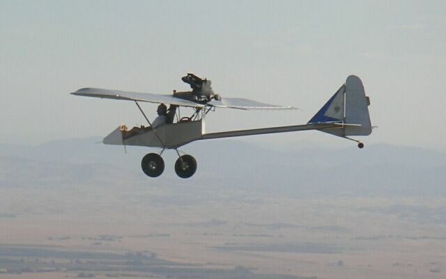

Posted: Sun Jul 09, 2006 4:56 pm Post subject: Thank Goodness For Big Tires... |
Yesterday was the second day that I've flown my Firestar and at about 3.9 hours since I put her back together and at 1500 feet, the engine quit without warning... The only field that looked halfway decent was plowed, but the wind was with the furrows... My 850x6 tires handled the rough ground without complaint... I got out of the plane, walked around looking for anything obvious, didn't find anything... Pulled the starter rope and she started first pull and ran perfect... I picked up the tail, turned her around and taxied to the end of the field, did a "runup", crossed my fingers and took off... Was only about a mile back to the airport and the engine never missed a beat... Got home, pulled the float bowl, perfectly clean, started and ran the engine several more times, no problem... "Gremlins", ugh...
