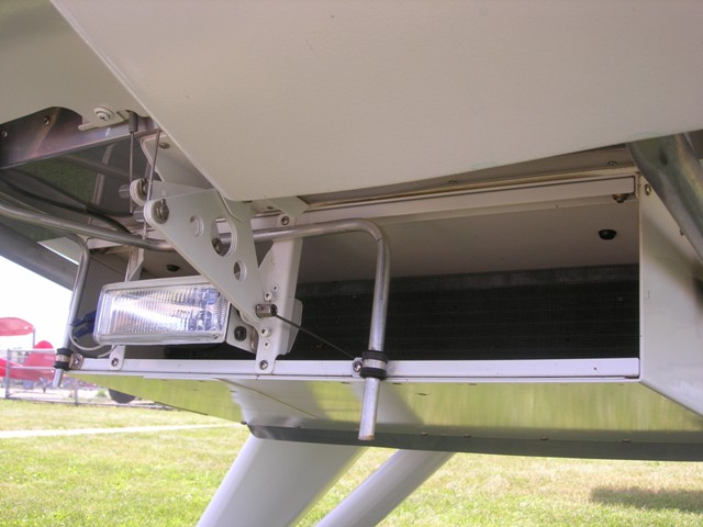

I was just reviewing your photos I saved from 2002. Do you have a part number (J. C. Whitney) for the landing light. I also assume you have a seperate switch and circuit breaker for it? Thanks. Jeff Classic IV

PostPosted: Thu Jul 06, 2006 7:43 am    Post subject: Re: Landing Light Reply with quote
Jeff,
Bill Willyard (on this list) has a pretty nice landing light - with position control. I took the attached photo at the JXN fly-in.
I don't think Bill will mind we sharing.
I don't know what bulb he used but he's pretty resourceful.
Richard

PostPosted: Thu Jul 06, 2006 4:39 pm    Post subject: Landing Light Reply with quote
Richard,
Thanks. It looks like the one Cliff had. They do look nice. Jeff

PostPosted: Thu Jul 06, 2006 7:59 pm    Post subject: Landing Light Reply with quote
Hi,
Just back from hospital with some back problems.  I think that it came with a set of 2 and the box maybe in my hanger-garage.  It did use the standard 50 watt quartz h bulb.  I think it has lasted for hundreds of hours.  Cost only a buck or two, carry spare.  Use it in landing pattern in flashing mode.  Better then strobes on final. Yes I have seperate breaker and swith.  I have it aimed about 50 down the runway and works fine.  Clint
