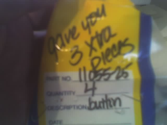

I’ve been slowly working on Bob Nuckolls’ design for the ground power plug made out of the Cole-Hersey Piper-style plug/socket.  I couldn’t get the insulating button out with pliers or other methods so I figured I’d try to be careful as I heated up the rear screw for solder.  Of course, it got too hot and melted.  I emailed Cole-Hersey (CH) on the website and got a message to call local dealers.  Dealers, come to find out, don’t carry little parts, just the end item.
I finally talked to someone at CH who had to go down to the assembly line/warehouse to find the little buttons, then sent me four for free when I only requested one that I would pay for, and who was also kind enough to write the part number on the little baggie when she sent them to me.  Awesome job at customer service.  If anyone else has had this problem, before you go buy a new plug or find a decades-old salvage part, call CH up and ask for part number 11055-25.
