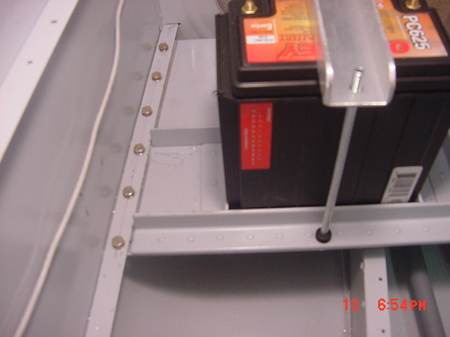

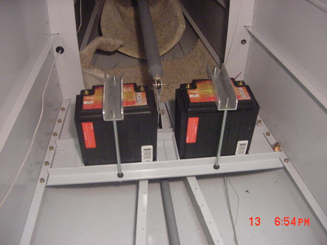

I have heard that several folks have mounted the battery in the lower forward baggage compartment.  From my CG calculations, that is a good place for mine.
Does anyone have suggestions on how to do this?  Pictures would be great.

Here’s a reference to Todd Rudberg’s site. He sells a batter box kit for mounting the battery inside the forward baggage compartment, on the floor.
http://www.rvwoody.com/battbox.html

[img]cid:001201c69fc4$406e1380$6401a8c0(at)Plotter[/img][img]cid:001301c69fc4$406e1380$6401a8c0(at)Plotter[/img]
