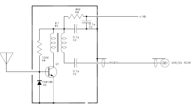

Understand. My current vision of this antenna suggests
that it will look like a piece of RG coax with a little
"lump" of a splice onto a 6-inch piece of wire. The
'lumpy splice' will contain a handful of components that
allows the relatively poor antenna to deliver energy into
the 50-ohm coax (end impedance of too-short element is
WAAayyyy to high).

In particular, I'll call your attention to one
of many versions described. Check out the
"AA7" . ..
It has an HF, VHF 'band' switch. You'll note that
in the VHF position, the active circuitry consists
of the single transistor and a couple of passive
components. The circuit I posted earlier . . .
[img]cid:.0[/img]
was an adaptation of the AA7 configuration. Most
active antenna designs bring rf energy down the
feed line and send dc power up to the antenna
on the same feed line. I decided to keep coax
installation as pristine as possible and not
mess with the feed line after it leaves the antenna.

To eliminate the 'monkey motion' at the
receiver end of the coax, dc power will have
to be brought out to the amplifier on a
separate, 22 awg wire that can be fed from
the same breaker as the radio . . .
The ferrite transformer cores came in last
week. I need to brass-board this thing
on the bench and verify performance before I
squish it down into that 'lump' described earlier.
