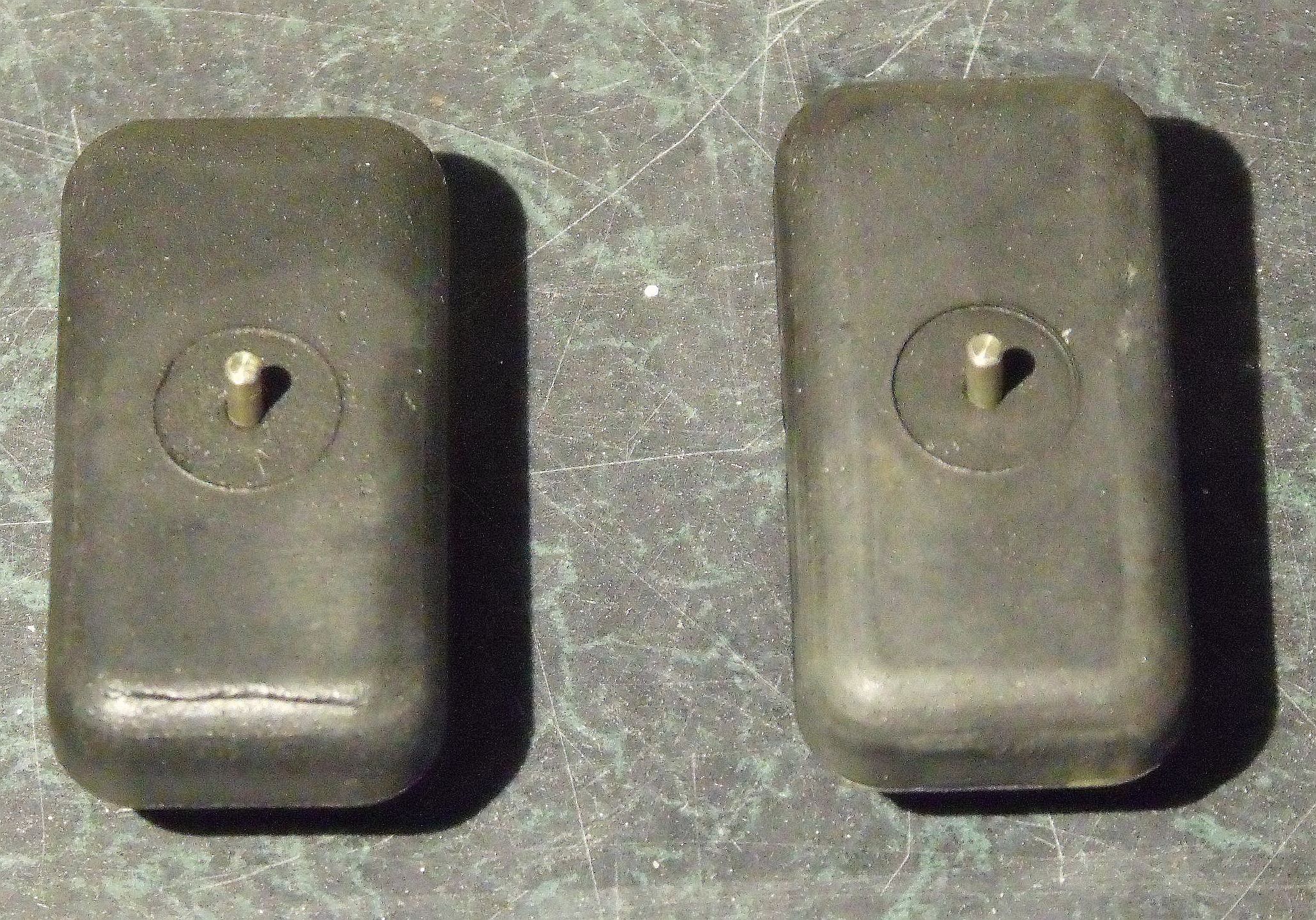

Did the weight check per the Service Bulletin and found a heavy float. You can see the crack on the lower edge of the left hand float in the picture.Called both Lockwood and the Bing Agency to get the status of new float availability. None at this time, Rotax is working with Bing and Bing's float supplier to fix the problem. Fortunately, I saved the old floats when I rebuilt the carbs 18 months ago.

Did the weight check per the Service Bulletin and found a heavy float. You can see the crack on the lower edge of the left hand float in the picture. Called both Lockwood and the Bing Agency to get the status of new float availability. None at this time, Rotax is working with Bing and Bing's float supplier to fix the problem. Fortunately, I saved the old floats when I rebuilt the carbs 18 months ago.
My 914 is 15 years old; but I replaced both carbs last year with new ones that I bought on Ebay. (The price was hardly more than the cost of a rebuuild kit.) Everything was fine for several months, but then I started smelling gasoline in turbulence, and occasionally the engine would flood after a flight and was hard to re-start. Sometimes the next day after flying I'd see that a bit of gasoline had run down the side of the pylon (it's a high-wing pusher SeaRey) and onto the turtledeck below. I worked around that by turning off the fuel pumps about 30 seconds before switching the engine off. That prevented flooding, but made me anxious, even though the engine ran just fine otherwise.
Then three people I knew with brand new engines had similar but much worse problems. The engine would load up and sometime quit when idling. Then in flight at low throttle settings. One got so bad that the only way the pilot could keep the engine running in flight was to turn both fuel pumps OFF! When the engine would begin to stutter he'd flip on one pump for a few seconds. It was a scary situation for him, but he managed to reach an airport and land safely.
Eventually Rotax issued the SB.
And THEN I had a look at the serial numbers on my "new" carbs. Sure enough, they were in the range that Rotax cited.
So a few days ago I took the floats out and weighed them: 3 g, 3 g, 3 g, 2.9 g--all within the acceptable range, but very close to Rotax's maximum pair weight of 7 g.
Furthermore, 2 of the 4 floats were abraded and had chips worse than those in Rick's photo. They had been in service for about 200 hours.
I replaced them with unused floats from a carb kit that I bought about 8 years ago. Those floats weighed only 0.5 g less than the faulty floats but they had no cracks or chips.
I've flown the airplane about 5 hours since then without smelling gasoline in flight, and the engine doesn't flood, and there's no gas seeping out anywhere. So I'm calling it fixed, at least for now.
Anyone with an engine or carbs in the worry range of serial numbers should take that SB VERY seriously! And if they notice any of the symptoms I've described, I'd urge them to stay on the ground until they can check the floats.

Vernon, When I called Lockwood tech support I was told the procedure is to order new floats and with them will come a warranty form. Fill out the form, send it in with the old floats and you get a refund. So, yes, it appears Rotax is supporting the S/B. Now all we need are new floats.

rickofudall wrote:
...Called both Lockwood and the Bing Agency to get the status of new float availability. None at this time, Rotax is working with Bing and Bing's float supplier to fix the problem. ...
Rick Girard
Here's an update on Rick's post:
I just talked on the phone with Dean at Lockwood. He says that Rotax hasn't yet announced a remedy for the bad float problem (other than to check them every 25 hours) and therefore Lockwood still has the old, potentially bad, floats. He says that float replacement will work like a standard warranty claim. You buy new floats and submit a warranty claim for the bad floats.
You'll need to demonstrate that the floats actually are bad--by weighing them individually or by photographing them floating in gasoline while in a carb bowl. I think he said that the pin should be at the fuel level; if not, they're bad. (A 912 bowl will work as well as a 914 bowl and is easier because you don't have to hold the bigfat bolt and o-ring in there to keep the gas from running out.)
In the meantime, all engines, carbs, and floats in the worry range should be checked every 25 hours. That includes brand new floats that you might buy to replace your bad ones--until Rotax gets the float supply problem fixed.
