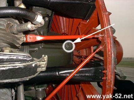

PostPosted: Mon Nov 17, 2014 4:46 am    Post subject: Propeller cycle and pitch issue Reply with quote
There is an oil gallery running along the top of the gearbox, but part of
the original casting. On that there is a large hexagonal plug, and under
that is the filter. Obviously if it becomes restricted, then the governor
will not work correctly. It is conventional wire-mesh and easily washable.

PostPosted: Mon Nov 17, 2014 6:55 am    Post subject: Propeller cycle and pitch issue Reply with quote
Here's a photo of it. When you remove the hex plug, use a box end wrench and not an open end wrench because you can easily round off the flats on the hex because it is aluminum.
