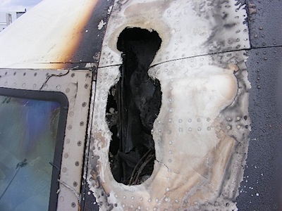

PostPosted: Wed Nov 12, 2014 9:43 am    Post subject: Electrical bonding Reply with quote
Hi Guys
I sobering pic of lightning damage to a fully bonded all metal aeroplane - I suspect in a Europa it would ruin your whole day!
Plus an interesting Boeing article. http://www.boeing.com/commercial/aeromagazine/articles/2012_q4/4/
Pete

On 13 Nov 2014, at 4:50 am, Ivan Shaw <ivanshaw(at)btinternet.com (ivanshaw(at)btinternet.com)> wrote:
[quote]v\:* {behavior:url(#default#VML);} o\:* {behavior:url(#default#VML);} w\:* {behavior:url(#default#VML);} .shape {behavior:url(#default#VML);} <![endif]--> <![endif]--> <![endif]-->
I don’t think that this photo is a lightning strike!!!
Ivan

Hi Guys
Pete
G-RMAC #109
<image001.jpg>

Hi All
Tried twice to post a reply but both times I got to see no content after
the mail was delivered.
Ivan is correct not lightning. Pic was originally posted as a strike
when I was sent it a while back. Further checking this evening shows it
to be now described as an electrical fire.
Hope this mail gets through ok.

PostPosted: Fri Nov 14, 2014 1:15 pm    Post subject: Electrical bonding Reply with quote
Of course it happened in my trigear Europa. I think it is one reason why glider pilots always wear a parachute.
Date: Fri, 14 Nov 2014 17:54:38 +0000
From: davidjoyce(at)doctors.org.uk
Subject: RE: Re: Electrical bonding
Karl, Was that in a Europa? I do not want to rabbit on endlessly but my own plan had been also to link the engine frame to the tail spring of my mono in case the lightning came at me in that direction, Regards, David
On 2014-11-14 14:53, Karl Heindl wrote:
[quote] David,
There are always exceptions. When I was hit by lightning, or call it electrical discharge, in clear skies, it entered via the tailpipe and exited via the radiators. Apart from some melted metal there was no damage. I also have nav lights on the wing tips.
It just illustrates that just staying away from cu nims is no guarantee for avoiding a strike.
Karl
Date: Fri, 14 Nov 2014 10:49:26 +0000
Subject: Re: Re: Electrical bonding
John & Ira , With the greatest of respect for your professional electrical & aeroengineering backgrounds, I think there are two rather different issues here:
        For certified commercial aircraft lightning protection standards seek to enclose all passengers and key aircraft components in a Faraday cage conducting system that will cope with the fairly frequent strikes affecting commercial operations without any significant damage. To bring composite aircraft to that standard clearly involves incorporating some conducting material in the entire surface of the plane and this is a nonstarter (or at least a non retrospective mod option) for a plane like ours.
       The other issue is the possibility of minimising any damage to a plane like ours in the event of a lightning strike, ( absolutely going along with the assertion that it is much preferable to avoid it). There are three good accounts of fibreglass small aircraft strikes that I have come across and in every case lightning went from wingtip to wing tip causing significant damage. These cases are the UK glider, previously mentioned (www.aaib.gov.uk/cms_resources/dft_avsafety_pdf_500699.pdf )  , another glider referred to in that AAIB report of the first glider and the Europa strike suffered by Paul McAlister (www.sarangan.org/europa_forum/2004-08/msg00094.html ). In each case the pilot thought he was well clear of threatening clouds it seems. The gliders had the strike track along the aileron control rods whereas with the Europa it tracked along the wing tip lights wiring killing a number of the avionics in passing. I would strongly recommend folk reading all these reports. Having personally done so I cannot avoid the conclusions that :
1. Getting struck by lightning is a real possibility for any sensible, cautious pilot let alone someone contemplating flying through the ITCZ where rapidly developing massive Cu Nims are endemic
2. Lightning can and will pass from wingtip to wing tip along the most available conducting track
3. More debateable perhaps but my third conclusion was that there is much to be said for offering a track that steers clear of vital structures, and in the light of this I had (in 2006) planned laying expanded aluminium mesh in the wing close outs connected to aluminium foil over the wing tip and to the rear lift pins/connecting rod. Nowadays I would no doubt use Aluminium Microgrid obtainable at modest cost from Aircraft Spruce.  I would not for a moment want to suggest that this would give commercial plane standard immunity to damage, but that it would improve the chances of avoiding either the wing exploding or the loss of avionics or other key electrical systems. I had toyed with the idea of static diffusers but without a system of conducting static from other parts of the aircraft I was not convinced this was workable ( and I guess that this non conductance of static is what saves us from sparking when we touch ground - we are only discharging the immediate area of contact.
Regards, David Joyce, G-XSDJ
On 2014-11-14 08:42, John Wighton wrote:
--> Europa-List message posted by: "John Wighton" <john(at)wighton.net (john(at)wighton.net)>
Ira,
You echo may own opinion on this subject. Fortunately my Europa does not seem to generate a lot of static (of a kind that can be detected at least). There is not a lot that could be done if it did collect static whilst airbourne.
I had concerns about static build up and discharge on the ground, particularly whilst fuelling. I adopt the standard procedure of grounding everything to the same potential by touch, relying on terra firma to act as a ground. So far there has never been the hint of a discharge even after a vigorous polishing session.
Being involved in aircraft certification myself l am aware of the often heavy and costly solutions on larger aircraft. I am a structures signatory on the A350, this has a high level of composites content and poses new issues and solutions on many fronts, including bonding and lightning protection.
John Wighton
Europa XS trigear G-IPOD
http://forums.matronics.com/viewtopic.php?p=433644#433644

paul.the.aviator(at)gmail
PostPosted: Fri Nov 14, 2014 7:48 pm    Post subject: Electrical bonding Reply with quote
Hello everyone,
I documented my incident on my WEB site http://www.europa.net.nz/363/  If you go to the left hand side of the page and expand open the “Flying Experiences� tab you find a page titled “A Lightning Strike�
As to adding discharge wicks, it my understanding that for certified aircraft they statically charge the aircraft and map the field. From this they determine the ideal locations for wicks. I guess if you added your own wicks you can’t make things worse but on the other hand it might not accomplish much either.
It is my understanding that the addition of mesh in the structure is for a different purpose. It is to provide areas to dissipate lightning strike should one occur.
I don’t have firsthand experience so I’m happy to be corrected on the above.
Paul[quote] [b]
Remi Guerner
Joined: 14 Dec 2010
Posts: 284
PostPosted: Sat Nov 15, 2014 1:15 am    Post subject: Re: Electrical bonding Reply with quote
Could anyone explain why wooden aircraft does not seem to be critically affected by the possibility of a lightning strike as are composite planes? Here in Europe, we have thousands of certificated all wood Robin DR400s, some of them approved for IFR, flying without any specific lightning protection such as aluminum mesh in the skin, wicks and so on. However, in my previous aircraft, a DR380 which is very structurally similar to the still produced DR400, there were a full network of tinned copper braid running inside the fuselage, connecting all metallic parts (fuel tanks, control hinges, engine mount...) together to the negative terminal of the battery and the engine block. I am not sure wether or not there were also such a ground network inside the wings.
Remi Guerner
