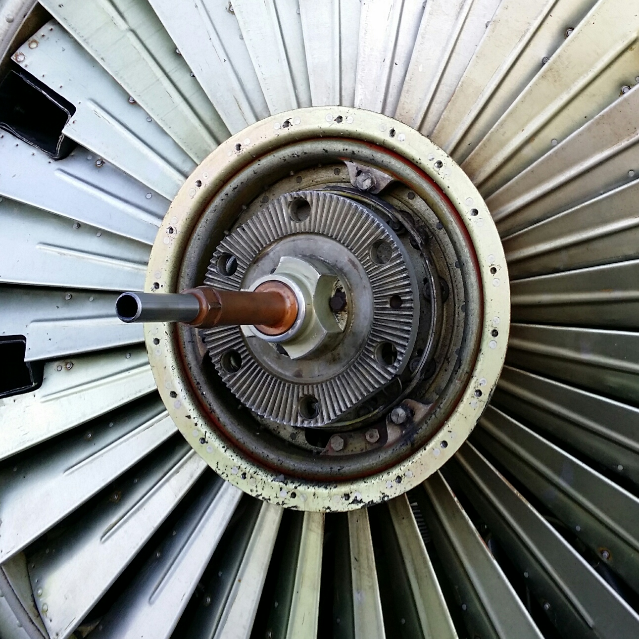

Hi all. I am a relatively new Yak owner since July. I am in the process of dismantling a few things for painting and having a problem figuring out how to remove the gills framework. I have removed the prop and hub. I am thinking the snout and the cast piece in front of gills needs to come off but cannot figure out how to remove. I did remove the four bolts at the base of the snout but it will not budge and cautious of using too much persuasion.
I have attached pic.
Any hints to going the last mile on this greatly appreciated.

Taking those bolts loose will not let you remove you oil tube ( the snout you refer to). Look at shaft of you oil tube. You will see a nut at the base of the polished tip that pushes oil into and out of the piston in the prop hub. Take the appropriate Mexican Speed wrench (adjustable) to loosen it. Careful, there is washer at the base. Put a clean rag in you prop shaft to keep FOD out.
You will have to remove all of those slotted safety wire screws around the ring that supported the defection plate at the base of the hub that you have already removed.
At the 0530 position you will see two ~8 mm bolts that on the back side attaches to a lever that opens and closes you gills. That all has to come off.
Then if you look around the base of louvers there are ? 11 mm bolts the bolt the ring to the nose case. Slowly loosen them all together so you are going loosen one a little, move to the next one, then the next one until you have all the walked around the ring. That is because over the top of the bolts is a slot in the perpendicular ring that prevents the bolts from backing completely out if they loosened in flight.
You also have to take those cooling trumpets off. You will have to take the outer ring braces loose that attach the ring to the nine cylinders. Do not lose those spacers at the base of those L brackets that mounts them to the stud on the cylinders. Impossible to find replacements.
Now that all of that is disconnected you can remove the louvers from the prop hub. Look at your prop hub. You will see two flat sides on an otherwise round flange. You will basically lift up the base ring behind the flange over one of those flat sides in the flange. You then rotate the ring around the flange like you would remove a lid from a gallon of paint if you intended to use the lide again that is. Yes I am talking about warping the base ring to slide it off the prop flange.

Thanks. Way more effort than I had hoped. While very tedious, I may elect to paint in place, not ideal but a lot of masking tape, small brush work, etc. may be my choice. Thanks for taking the time for your detailed response.

Welcome. Getting ready to re-hang my engine on the 50 and the the louver fun begins in reverse of what I wrote.
If you are going to paint them you really do need to pull them off the engine. Them you can degrease them and strip them. We pulled the axels out of mine and painted the individual vanes.

Mark, Interesting about removing the gills. Unfortunately, here in the mid-west I need to close them when to keep everything in green arc!
Doc, I went to the plane today read/re-read your procedures. I am attaching a pdf with pictures associated with your procedure and a couple of needed clarification areas. I want to make sure I fully understand before jumping into this if I decide to. After looking at it today, it does not seem so daunting other than time consuming (but keeping in mind Mark's comment also).
Ron

You are dead on with your pix and my description.
Once all of those bolts, braces, and screws are loose the louver ring will be somewhat flexible. Pick a flat side on the prop flange and lift that inner ring up over the top of that flange. You then rotate it around the flange until the whole ring lifts off free. Think about how you take an auto tire off the rime. The Russians made it a little easier by giving you two flat places on the outer side of the prop flange.

Thanks to everyone for your insights. I ended up removing the gills simply by removing the screws at the bottom of the gill and the long screws that go through the gills. Did my painting thing the reinstalled them. All is well and works fine as before. One thing I did note is about half dozen of the long screws were significantly worn where they rotate and make contact with the upper gill hole. They were worn about 50% through due to the rotation (and possibly lack of lubrication). I brazed each of them then turned down flush so hopefully that will work for some time to come. I would hate to tackle a problem where the screw broke in place. Don't know who it could be removed w/o tearing up the gill.
