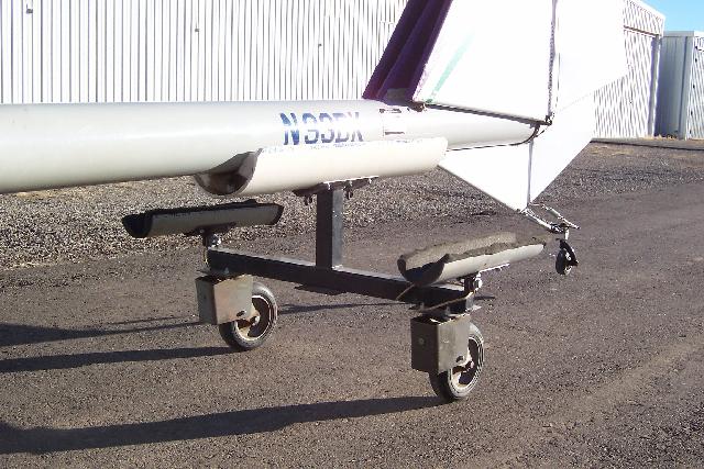

One method of supporting the boom tube on a Kolb MkIII (and other aircraft) is by using a PVC "saddle". This saddle is originally made for irrigation piping, but works perfectly with a little modification. The saddle itself requires no tweaking, but there is a pipe that connects to the saddle-tee, and the base of that needs a large castered wheel.
Another good solution for supporting the boom tube while trailering is to find a "base" for the pipe that comes out of the saddle-tee, and affix the "base" to the trailer... then, after the Kolb is in place on the trailer, put the saddle-tee in place on the boom-tube, then screw a connecting pipe on to it and the base.

Part: 6 x 2 PVC IPS FIPT Saddle, product code 4460-20 (at) $41.00
(The above part description, part #, and price is as of Aug 2008)
The part information above is only for the saddle-tee. Also needed is a pipe, connected to the saddle-tee, and of course the wheel. (When I find a photo of the saddle in place on the boom tube, I'll post it here.) I've used this method (with the caster wheel for over 7 years with my Mk III.  I also have the base that attached to my trailer floor, for securing it while transporting it.
Below are mfg pix of saddle-tees.

Question?  Is the MKIII tail boom 6” in diameter?
The firefly is 5”, so this may be too large unless you glue some padding of some kind inside of the saddle. Carpeting comes to mind.

Relying on memory (a very dangerous thing!), yes, it's 6" in diameter.
The PVC saddle has a thin (but not too thin) piece of rubber covering the entire inside surface, so that when it contacts the boom tube, it creates enough friction to stop the saddle from moving around on it (and protects the aluminum).  Carpet might work, but you'd then have to worry about it moving around on you.  I don't know if anyone makes a 5" saddle, but that's would be a better solution.  Second-best would be to use something rubber-like with a lot of friction that would give a tight and very even "seal" around the tube.
Until you mentioned the issue of its use with a 5" boom, it never occurred to me how lucky it is that this all works together so well!

Robert Laird wrote: << One method of supporting the boom tube on a Kolb
modification, and the base of *that* needs a large castered wheel. >>
Malcom / Kolb Friends -
Here's a picture of how I built my boom tube support for my Mark-3.
The center saddle is made from a piece of 12-inch diameter PVC, cut in half
lengthwise. I glued foam to the inside surface for padding. The two side
saddles are for supporting the wings. This is much more supportive, and
safer for transporting over long distances compared to the stock method of
wing support, which uses the 1/2 inch tube that passes thru the fuselage
tube.
For added shock absorption, once the aircraft is on the trailer, I place an
old tire under the dolly to raise it high enough to just get the casters off
the deck, then tie down the whole aircraft.
I have trailered my Mark-3 hundreds of miles using this, with no damage
whatsoever.
Dennis Kirby

PostPosted: Fri Nov 07, 2014 7:25 am    Post subject: trailering a fire fly Reply with quote
Hi Dennis, and other Klobers
Please explain how you get the
saddle under the boom tube.
My mk3 tail is too heavy for me
to lift. Do you use a jack under the
Tail ? A hoist? Or are you just really
strong. Your method looks good.
Frank

PostPosted: Wed Nov 12, 2014 11:44 am    Post subject: trailering a fire fly Reply with quote
frank.goodnight wrote: << Hi Dennis, Please explain how you get the saddle under the boom tube.
My mk3 tail is too heavy for me to lift. Do you use a jack under the Tail ? A hoist? Or are you just really strong. Your method looks good. Frank >>
Frank / Kolb Friends -
I bring the dolly right up alongside the fuselage tube near the tail, wrap one arm around the boom and lift, then slide the dolly under the tube. The saddle on the dolly is only a few inches higher than the boom tube, so I don't have to lift it very high.
Thanks for the compliment about being "strong," but ... there is only 65 pounds of weight sitting on the tailwheel. Where I lift the tail boom - just at the leading edge of the vertical fin - might be about 5 pounds more (due to shorter lever arm, compared to location of the tail wheel).
When trailering, I roll the whole assembly up ramps onto my flatbed trailer. Then, I use a jack to lift the rear of the Kolb (with the dolly still attached) up high enough to slip an old car tire underneath the dolly, for extra shock absorption.
George Alexander has been gracious enough to post other pictures of my tail boom support dolly on his website.
