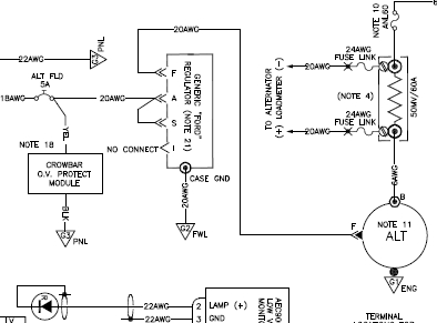

PostPosted: Mon Oct 27, 2014 6:31 am    Post subject: B&C alternator question Reply with quote
At 00:32 2014-10-27, you wrote:
--> AeroElectric-List message posted by: Justin Jones <jmjones2000(at)mindspring.com>
In the Z-13/8 Diagram, it specifies the use of an SD-8 PM as the standby alternator. Is it acceptable to replace it with a BC410-H 20A and use a generic ford voltage regulator? Or is it necessary to use a B&C alternator controller? I would connect it to the system in the same place (battery side of the battery contractor). In the event of a primary alternator failure, I require 12A (worst case scenario) to continue to run necessary systems without discharging the battery. The SD-8 doesn’t seem up to the task, not to mention the BC410-H is a less expensive option.
Suggest go with Z-12 and use ANY of the larger,
B&C pad-driven alternators.
The generic Ford regulators are 'okay' . . .
they perform as advertised but they are
not adjustable. Z-12 was orignially crafed
to accommodate an 'auto switching' mode
for the stand-by alternator (like those
systems installed on many, many TC aircraft.
The standby system is ON all the time with
a voltage regulator set for 1.0 volts below
the normal system voltage set-point. If the
main alternator goes south, bus voltage drops,
the s/b regulator tells the little alternator
to go to work. If you're using the B&C SB-1
controller, it will light an annunciator to
tell you that the alternator is on-line.
If in an overloaded state, the light will
flash. You then reduce loads until the light
is on steady indicating that the loads are
now within the alternator's capabilities.
If you don't want/need the auto-switched feature,
use the generic Ford regulator if you wish.
Leave s/b alternator OFF until advised that
it is needed by a low-volts warning whereupon
you bring the s/b alternator on line and
then adjust loads to keep the bus voltage
at the regulator's set-point or some value
at or below 100% of alternator's output as
displayed on a loadmeter.
KISS . . . Z-12 is recommended. I used to
have a Figure Z-13/20 that proved to be
rather in-elegant and I removed it.
Wire your "Ford" regulator thusly . . .
[img]cid:.0[/img]
. . . as depicted in Figure Z-11.
 Filesize:  48.8 KB
 Viewed:  7806 Time(s)
PostPosted: Mon Oct 27, 2014 6:39 am    Post subject: B&C alternator question Reply with quote
Justin,
If you try to use an automotive Ford regulator, my experience shows
you'll find that an attempt to shutdown that alternator in the
conventional method, by switching off the field power to the
regulator, will instead result in a voltage runaway, with the
regulator powering itself from the alternator directly with NO
regulation of voltage. Once that happens, turning the field power
back on does NOT result in voltage control... Overvoltage continues.
The only way to restore normal regulation is powering down the
alternator, which usually means engine shutdown... Not handy.
This is a condition limited to the Cessna's which
do not tie "A" and "S" terminals together . . . a
condition that's okay for the legacy electro-mechanical
regulators and their solid-state clones.
The commercial off-the shelf replacement regulators
are sometimes wired a little differently within . . .
which does not affect their performance in cars
where alternators are not controlled. These not-
quite-a-clone variants will indeed produce the
behavior your describe . . . been there, done that.
But when wired as depicted in Z-11 and others, the
generic COTS regulators of all stripe are well
behaved performers.
Emacs!

> If you try to use an automotive Ford regulator, my experience shows you'll find that an attempt to shutdown that alternator in the conventional method, by switching off the field power to the regulator, will instead result in a voltage runaway, with the regulator powering itself from the alternator directly with NO regulation of voltage. Once that happens, turning the field power back on does NOT result in voltage control... Overvoltage continues. The only way to restore normal regulation is powering down the alternator, which usually means engine shutdown... Not handy.
behaved performers.
