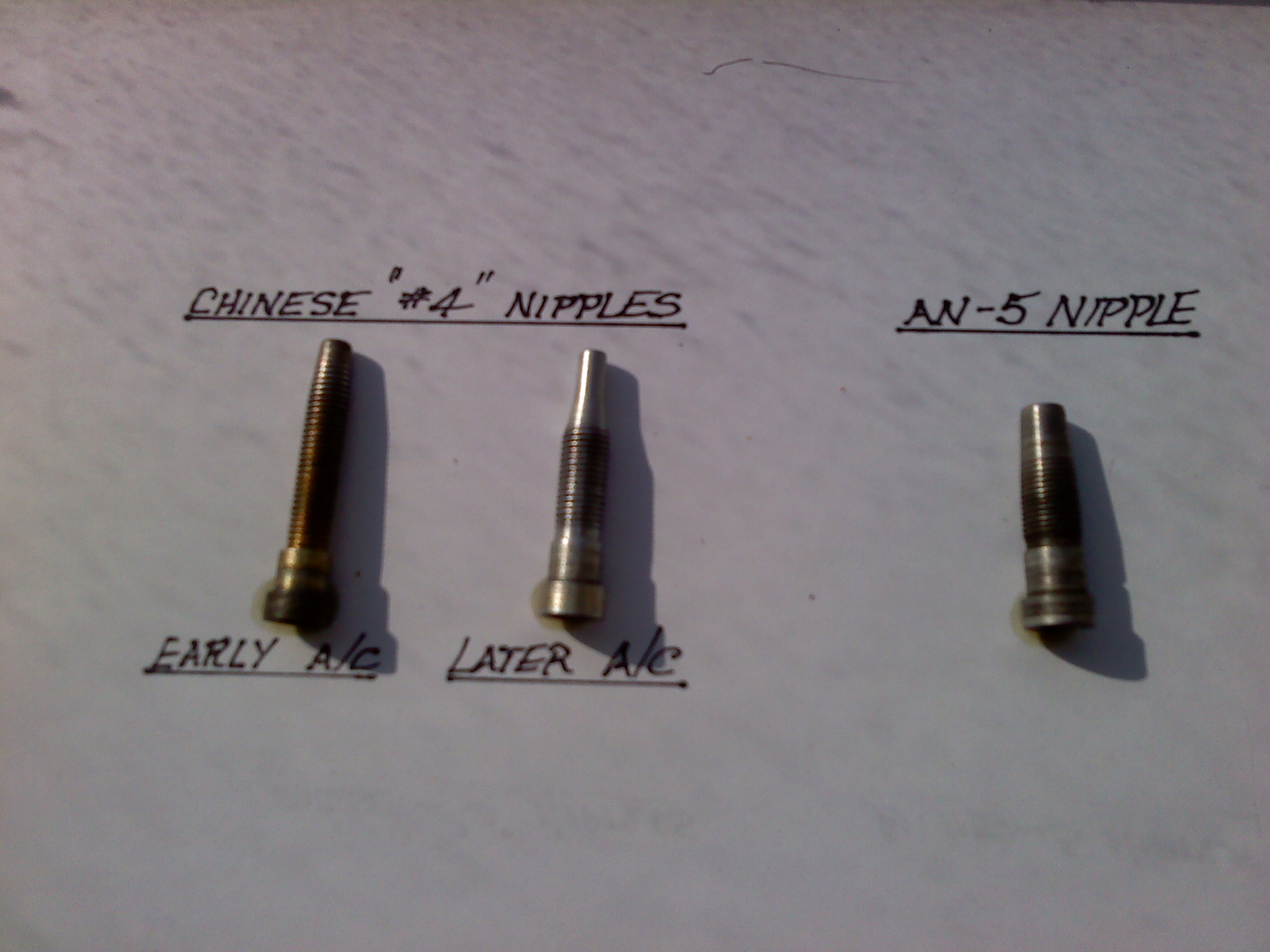

PostPosted: Tue Sep 23, 2014 9:29 pm    Post subject: Aeroquip Hose Reply with quote
Hi Dennis, et al;
Did some research to refresh my memory on the CJ air system hose & fittings, etc. Hard to believe but it was 20 years ago (1994) when there was no new Chinese hose available.
The above hose & fittings are identified as a size 4. The rationale for that number is the ID of the hose and the ID of the standard al. alloy tubing (6 mm X 1 mm) used in the system. Both are 4 mm.
The AN/MS designation of dash (-) 4 might suggest that these are of the same size and in fact the ID’s of hose and tubing are indeed similar to the above. In this case the – 4 represents the OD of the standard al. alloy tubing in 1/16th increments.
There the similarity ends.
The Chinese hose is designed for an operating press. to 750 psi. and likely will approach 1500 before failure. To achieve this without a steel mesh requires a number of fabric layers and a much larger outer diameter.
The MIL-H-8794-4 (303-4/ 111-4) is designed principally for medium press. hydraulics to 1500 psi. with an ultimate in excess of 3000 psi. These numbers of course decreasing with increasing diameter.
Due to the much larger OD and the corresponding larger size of the fitting components, replacing the AN nut with the metric nut will result in a structurally unsafe assembly. The axial load produced by the internal pressure is reacted at the bearing area of the nut on the nipple. This is a circular contact surface with an outer dia. of approx. 3/8” and a width of approx. 1/16”+ in the original configuration. That width is reduced to 0.016” (1/64”) with the metric nut on the AN nipple. I have not calculated the actual area reduction but it is severe and unacceptable.
So much for the AN –4 size.
On the other hand the 303-5/111-5 I believe can be quite safely used as a replacement hose but only using the complete Chinese fitting assembly and only if the socket and nipple of that assembly are of the later design as shown in the attached photo. In this configuration with the slightly smaller OD nipple (8 mm compared to approx. 9 mm for the AN nipple) the 3000 psi minimum may be compromised a bit.
In the bad old days the hoses always leaked from the socket area after they had some time on them. The reason was the 7 mm nipple was just too small. The Chinese tried to fix that by wrapping the nipple with fabric before screwing it in.
So the –5 will work - with the Chinese fitting! It could be done with the metric nut on the AN nipple BUT that requires increasing the hole dia. in the nut and decreasing the OD of the nipple head resulting in the same problem as the –4 size though not quite as bad. Not a good idea and why bother! New hoses are available at a fraction of the price of the AN/MS stuff and are more than adequate for the rather minimal pressure they are subject to.
I don’t know when the “new’ nipple arrived, maybe back in the seventies (Doug?) They are a huge improvement and are probably on all the new stock hoses. I think they are on mine - all new from Doug and haven’t leaked YET???
Walt
