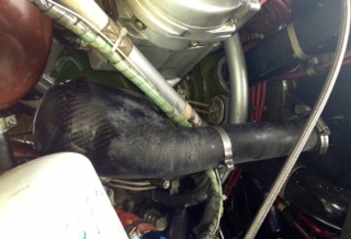

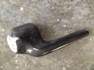

PostPosted: Thu Sep 11, 2014 5:59 am    Post subject: Compressor shearing shaft. Reply with quote
This compressor shear pin failure has happened twice to the M14P on my CJ. In both cases, the compressor overheated because of insufficient ram air cooling. The compressor's piston was gummed up with deteriorated oil which had become a gritty substance.
The fix was to copy the compressor cooling horn/shroud from a Yak 18T. It delivers more cooling ram air because it half surrounds the compressor. It's constructed of carbon fiber. The local fellow who built it for me intends the produce more, but can't seem to find the time to create a master plug from which copies can be replicated. He's had several requests. I'll bug him again. Hope the photos come through.
Blitz Fox
