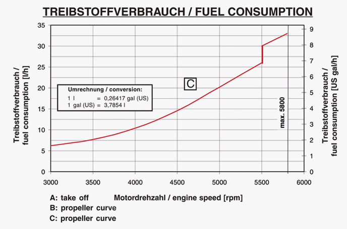

Hi
Could someone show me where I can find figures for the fuel consumption on my 914 when let us say I go 4.200 rpm / 30" MP ... ???
All I can find is the graphics in Owners Manual and do. graphs. on other Rotax enclosures, but the MP is not an item as far as I can see.
Regards Gert
OY-GDS
Mono/914/Woodcomp
[img]cid:C6970731-1B86-47DC-80F6-DEDEB304646D(at)domain_not_set.invalid[/img]
 Filesize:  173.19 KB

Gert,
I would not run 4200rpm and 30”….sounds a bit over square to me.
Best way to get your fuel burn info is by test on ‘your’ particular aircraft. Then arrive at a nice economy cruise speed/fuel burn and a regular cruise speed.
Remember you want to cruise your Europa ‘on the step’ AOA wise and this will vary with aircraft weight and differing aircraft. But at MTOW you want to be going 120kts indicated minimum to be nicely in the groove.
Most aircraft have a ‘sweet spot’ speed wise when the aircraft just ‘feels’ right!! Find the sweet spot for YOUR aircraft and cruise there….why would you do any other?!!

Hi Ivan - and others
Two years ago I had opportunity to purchase a brand new 914, and a Woodcomp at a very reasonably price.
Changed engine last summer after 700 hours og trouble free flying with the old constellation.
With the old set-up - 914/Warp Drive - i did 105 knots at 4600 rpm, burning 16.5 ltrs./hr.
At that power setting my old engine/prop really sounded like it could run for a thousand year - must be the "sweet spot", Ivan Smile
My new engine and prop. really sounds and feel OK at 4200 rpm / 30", and that is giving me exactly 120 knots IAS.
But again - this prop. is a completely new world for me ...
What power-setting are others aiming for at cruise with a 914 and adjustable prop?
And what fuel-flow do you get?
Gert

Hi Gert,
30", and that is giving me exactly 120 knots IAS. But again - this
prop. is a completely new world for me ... What power-setting are
We usuably cruise with 27" and about 4500 rpm if we are not in a
hurry, which is about 16 l/h fuel, and good for about 120 IAS.
I think for 30" you should go to about 5000 rpm. There is some curve
about that in some Rotax manual. Of course it also depends on the
balance of your prop (I have a two blade prop, and it feels just a bit
more rough in the area of 4600 to 4800 rpm, so I avoid that area.)
Frans

Hi
Regards Gert
OY-GDS
Mono/914/Woodcomp
<image001.png>
