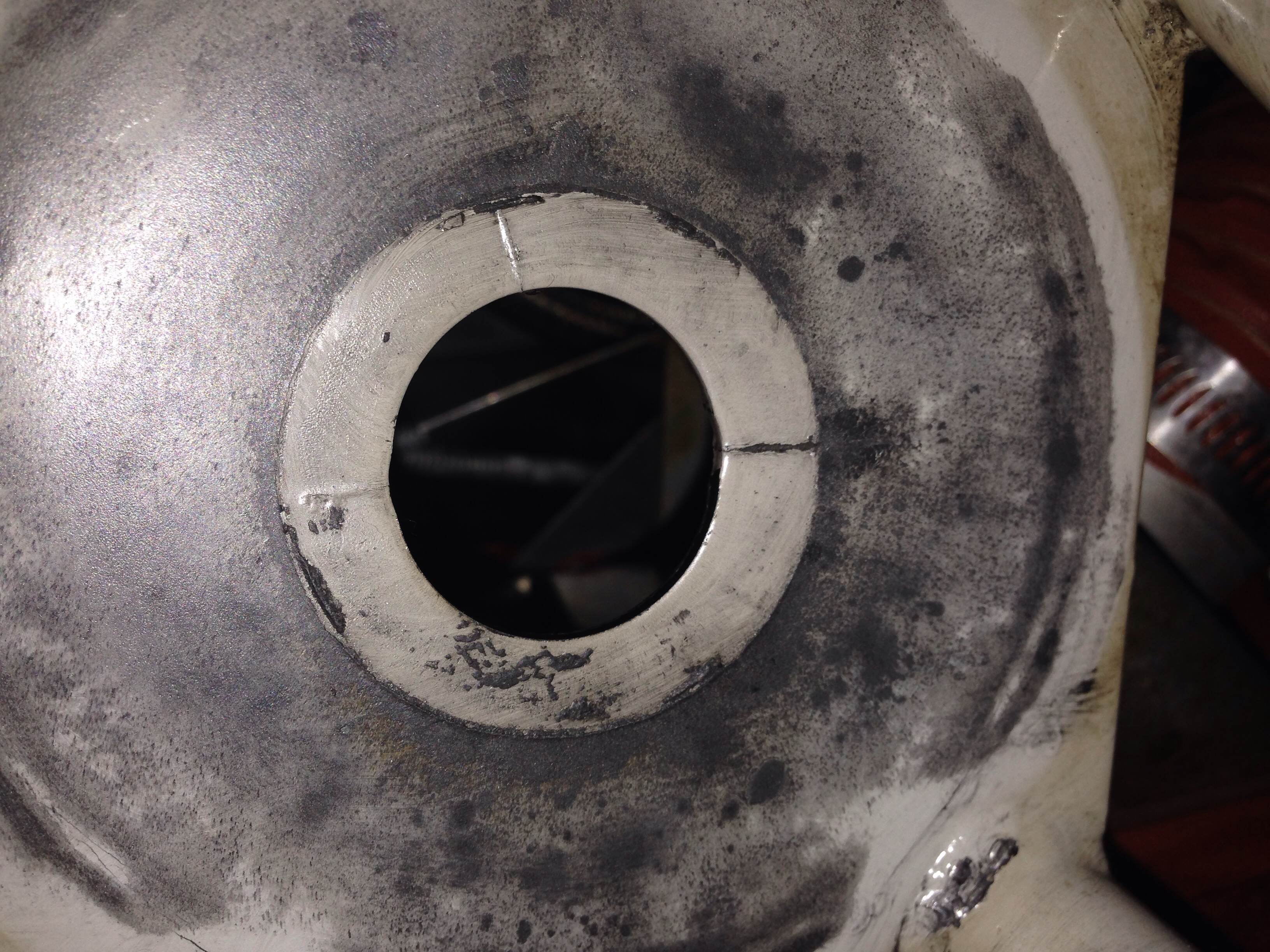

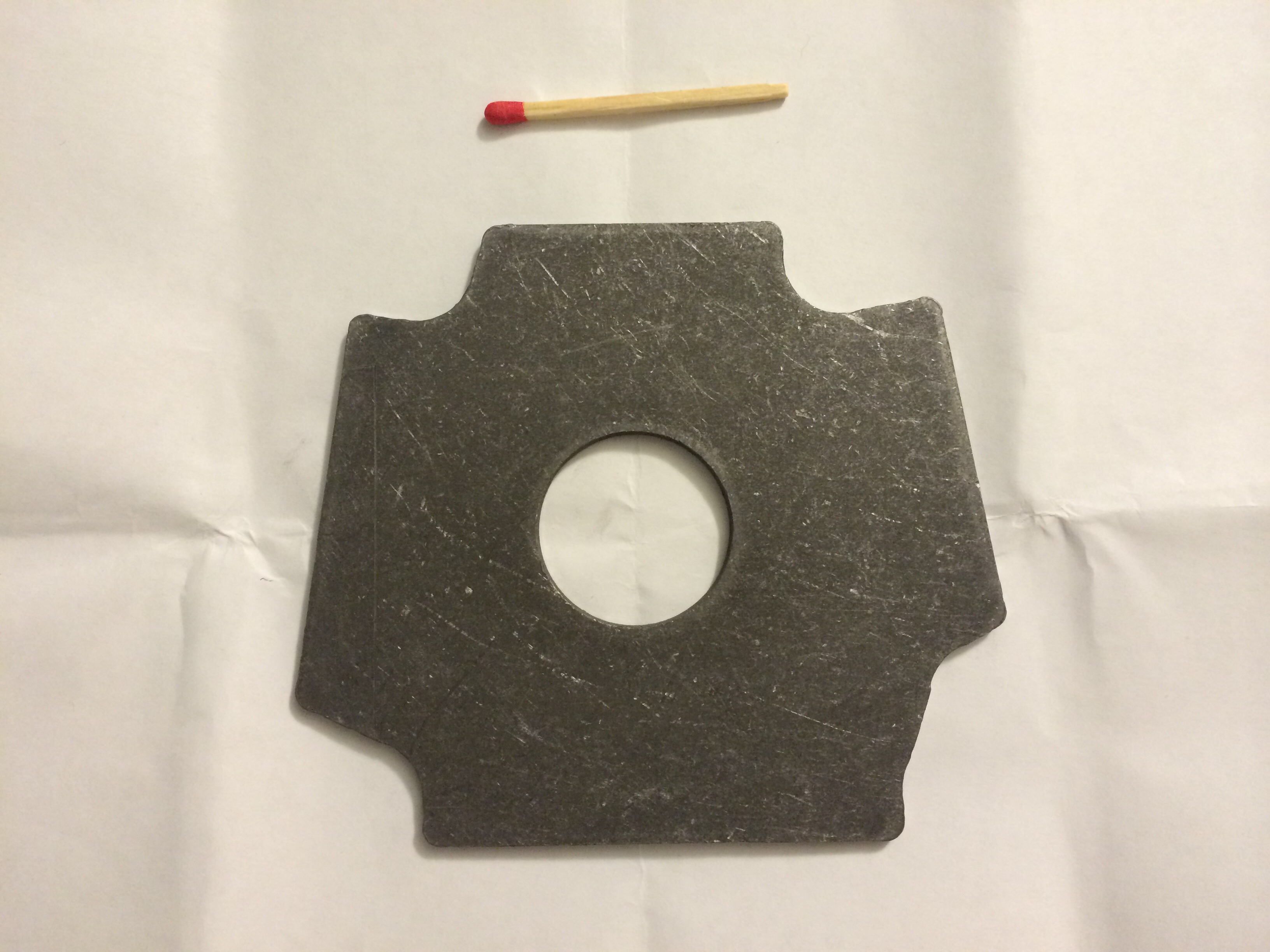

PostPosted: Sat Sep 13, 2014 10:02 am    Post subject: SB Nose Wheel Report Reply with quote
Details:
Serial: 40605
Total Hours: 504
Weight: 1684 lbs
Empty CG: 107.29
Nose Wheel Mount Status: Cracked at 3rd Condition Inspection. 4 donuts installed since first flight. There was play in link assembly when weight is removed from nosewheel
Misc: Front wheel was found cracked at 2nd Condition Inspection (336 hours), replaced with WHLNW511.25. Link assembly not removed for inspection.
Original main tires and brakes.
Rough field Operations:
At least 450 Takeoffs and 450 Landings on 8NC8
Avg Est Takeoff weight = 2450lbs 110.4" aft of datum
Avg Est Landing weight = 2330lbs 110.5" aft of datum
Notes:
No rough landings and no nosewheel-first strikes.
90%+ taxi operations on 8NC8 performed with stick full back
On landings while balanced on mains, bumps would cause nose wheel to fall slowly and make ground contact once or twice during rollout before settling to ground with full back stick.
Occasionally on takeoffs, the nose wheel would strike a bump while being lifted off.
Photos:
(I'll try to attach one picture to this post but not sure it will display)
Here is a link to photos in my Kitlog site:
Cracks in Elastomer Plate

PostPosted: Tue Sep 16, 2014 1:06 am    Post subject: Re: SB Nose Wheel Report Reply with quote
I just thought to post a picture of the doubler.
Michael
 Filesize:  1.14 MB
 Viewed:  20197 Time(s)
