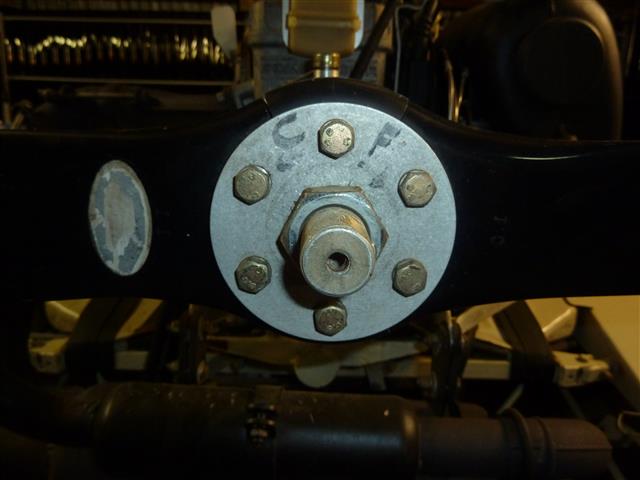

What John & the others said. Let me add a few remarks from my own experience: leave the jets alone and fine tune the EGT with prop pitch. When the pitch is ideal, your EGT's will stay roughly between 1050 & 1150 at any typical in-flight throttle setting except WOT, where they will be 1000-1050. As the EGT rises and falls from summer to winter, once again, leave the jets alone and add or remove pitch.
I marked this on my Ivo hub abut 3 years ago, so the arrows are a bit faded, but coarse is one way, fine is the other. Takes less than 2 minutes, usually a half a turn is enough.

I can easily set up and run the MOI tests myself to get the true answer, but
I suspect I am not going to like it.
Options are buy a new milled aluminum hub, but that is saving all the weight
at the center, which won't help the MOI much. I could convert to a two
blade hub, but the 60" is probably not able to put enough load on the engine
at any kind of a reasonable pitch.
I wanted to check out the Power Fin props at OSH, but could not find them on
the field nor in the list of vendors.
Now what I am going to say next is strictly personal and is NOT meant to
start any flame wars over props:
I know Travis recommends the IVO, but for me they are not an option due to
other's experiences. End of story, no more gas for the flames.
I have a good regard for the Warp Drives, related to the above sentence,
again, no more gas.
I am completely open to any other prop that gets the job done that is
reasonably priced.
I don't care about looks, but am concerned about vibration, price and noise,
but of course they have to take a back seat to proper application.
Some things I have read and conversations I have had led me to think that
the 3 blade would be a better choice as it would be smoother and quieter
than a 2 blade. I also liked the idea of a lower overall folded size (my
hanger/trailer situation came into play here).
Anybody want to buy a new prop that has not even had the bolts torqued down?
Not the first stupid thing I have done, probably not the last either.....
Stuart

PostPosted: Sat Aug 30, 2014 3:07 pm    Post subject: pitch? Reply with quote
Stuart, Before you get rid of your WD prop, know this. Most of the MOI problems on "B" gearboxes come from trying to make the engine idle at too low an RPM. Doing this beats up the dogs and wears out the spring washers in the gearbox. Just keep the RPM at idle at 2000 or more and you'll be just fine. You have one more option before you dump the prop. Have the blades tapered. It's going to mean putting another $200 or so dollars into the prop but tapering the blades gets rid of mass on the blade tips where you get some good out of it.
My 2 cents, your $200 bucks if you decide to do it.

stuart(at)harnerfarm.net
PostPosted: Sat Aug 30, 2014 4:47 pm    Post subject: pitch? Reply with quote
John,
That was the exact impression I had, and the reason I did not question it
any further. Seemed like he knew the plane, the engine and the gearbox. I
did not get the "used car salesman" red flag.
I really did not give it much extra thought until some replies to my
starting pitch angle came back, indicating that this combo would not work.
The numbers back this up, Rotax did not put the limits in the book just for
the heck of it.
However, no one has replied that Yes, they are running this combination and
it is fine. The flip side of that is no one has said "I tried that and it
tore up my gearbox", only some have warned that it would not work, according
to the numbers.
So, it would seem that it all comes down to whether I want to try it or not.
I have been doing some research on this subject today, some of it I did not
understand. I like physics, but am not very good at it.
To me, a heavier prop (flywheel) would help smooth out the pulses of
combustion, at the expense of quick throttle response. It seems to me that
a lighter prop would speed up and slow down "faster" so that it would
"hammer" the gears more. More rotational mass (MOI) would be slower to
reach a set speed, but would also tend to continue rotating at that speed
(minus the drag of producing thrust) therefore carrying the inertia into the
next combustion pulse. To me this should dampen the "hammering of the gears
effect". Maybe I just don't "get it".
Something else I find interesting is that the Rotax manual warns never to
run the engine without a prop (load) as it will damage the gearbox. They
give a max MOI, but wouldn't there also be a minimum MOI?
Maybe I am fretting over nothing. Maybe I should bolt it on and fly!
I value EVERYONE's input, and thank you one and all.
Stuart
P.S. I still haven't heard a suggested starting pitch angle....

Stuart, I'm re-posting this response just in case it didn't come through. And I'm going to add something after.Before you get rid of your WD prop, know this. Most of the MOI problems on "B" gearboxes come from trying to make the engine idle at too low an RPM. Doing this beats up the dogs and wears out the spring washers in the gearbox. Just keep the RPM at idle at 2000 or more and you'll be just fine. You have one more option before you dump the prop. Have the blades tapered. It's going to mean putting another $200 or so dollars into the prop but tapering the blades gets rid of mass on the blade tips where you get some good out of it.
Rick Girard
In the winter of 2006, hot out of LSARM training I built a rig and did the rotational inertia per Rotax Service Instruction 11 UL 91E published December of 1992 (attached). At the time I had six props for various aircraft in the shop. As I recall only the wood two blade that came with my Firestar passed and being of multi-laminate constuction only did barely. Jimmy Young also did tests on two props, a WD and an IVO if memory serves. Both were three blade props.
Anyway, I stand by the recommendations above.
I know I'm not alone in recommending WD props for one simple reason. They are great at holding up to the trials and tribulations of the pusher configuration. I put an AN 6 bolt through a Warp and didn't even know it until I landed. I put a cheap pair of bifocals through the Power Fin on my trike and it cost me two new blades.
Rick

jbhart(at)onlyinternet.ne
PostPosted: Sun Aug 31, 2014 1:39 pm    Post subject: pitch? Reply with quote
From: "Stuart Harner" <stuart(at)harnerfarm.net>
Date: Sun, 31 Aug 2014 08:34:47 -0500
Stuart,
May be I can help you "get it".
The moment of inertia is the spread of the mass about the center of rotation
times the radius of gyration squared.
Take a large hex nut and tie to the end of a string.
Give it a whirl in the horizontal plane with a short
radius and notice the tension in the string and the
revolution count.
Double string length and try to keep the rotation
speed the same as before.
You will find that the string tension more than doubles and the energy you
have to exert to swing the whole thing goes way up. In this case the system
mass "the nut" is constant but as the mass is moved out from the center of
rotation more torque is required to keep rpm constant.
These represent the loads as seen by the gear box and the crank. It is
desirable to have a low inertia propeller so that the propeller can
accelerate and de accelerate and absorb some of the firing impulse exerted
on the crank by the piston and connecting rod. This reduces the peak
oscillatory torque loads in the crank and on the face of the gear
teeth.
It is some what counter intuitive. With a lower inert propeller, the
engine and gearbox will jump around a little more on the mounts. But

PostPosted: Tue Sep 02, 2014 12:59 pm    Post subject: Re: pitch? Reply with quote
I started at 16 degrees and then adjusted for 6250 rpm static
PostPosted: Thu Sep 04, 2014 1:14 pm    Post subject: pitch? Reply with quote
Thanks, that is where I will start too.
Stuart
