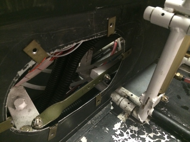

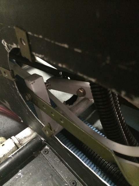

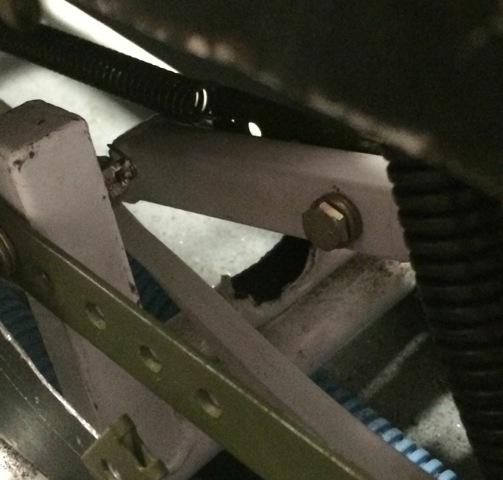

Kolbers,
The good news is that no one was ingured and the aircraft damage was relatively minor. It could have been a lot worse if it happened in the air.
Recently we had a taxi test in my Xtra with a once around the pattern and shortly after landing the right rudder failed! Atfter a sharp left turn to exit off the runway, without the benefit of a taxiway, the Xtra ending up off the runway with both axels sheered off at the wheel and a bent right wing tip.
After getting the plane back to the hanger I found that the rudder failure was caused by the weld failing between the upright square bar that connects the rudder to the cables. I also noticed that the axel is hollow. Should the axel be solid?
Have any of the Kolbers experienced this before and if so, any suggestions as to the cause of the failure and the best course of action, repair or replace the failed part?
I have attached the photos of the failed part and the sheered axel.

I think the issue might be that the rudder control system wasn't designed
to handle the load that toe brakes put on the rudder control system. Flight
loads and ground control steering just doesn't put that much load on it.
Like so many things when a seemingly small change is made it can effect a
bunch of other things. Those of us that have the old heal brakes shouldn't
have a issue. For those that have toe brakes check for stress in the area
described. Also check the rudder control horn on the rudder and the rudder
hinges. It would seem that some beefing up of the rudder system is in order
when using the newer toe brake setup. Seems like there was one toe brake
installation that increased the leverage to the master cylinders for this
very reason. Maybe both areas need to be looked at. In the mean time don't
stand on those toe brakes.

[quote] Not rudder failure, but what looks like a rudder crank that failed, not
because the weld failed, but the round tube wall stressed cracked over time
and failed. I had a similar aileron crank failure on a Ultrastar in 1985

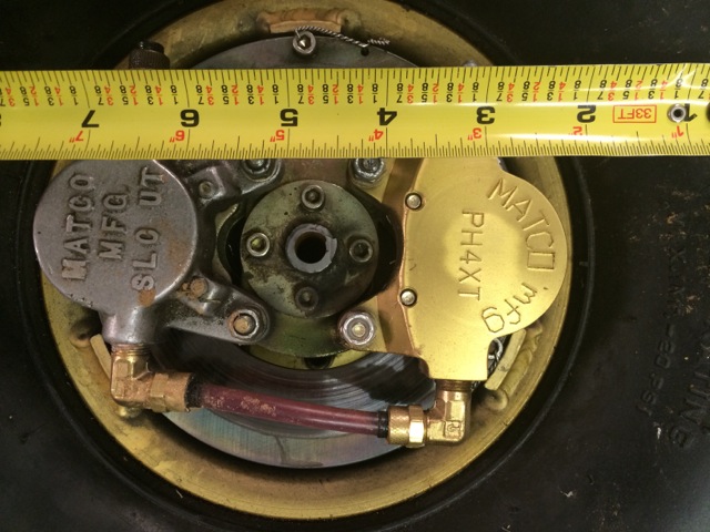

Brad/All
The both axles failing at the same time got me thinking. I see dual Matco brake calipers (one may be a bigger caliper) along with the failed rudder controls. I would bet that the brakes were slammed on extremely hard sheering off the axles and braking the rudder system. Not sure what to say. It looks like the brakes were instantly locked up putting way too much torque on the axles. What landing gear legs did you have?  I would guess a nose over could have occurred if things hadn't failed.
 I have the original Kolb optional solid tapered spring steel gear legs. Not sure how they would handle that much braking force.
Again worth what you paid and refunds anytime.

The rudder control failed first causing the hard left turn and running into the soft dirt embankment which caused the wheels to sheer off. The gear legs are tapered steel. The gear legs were buried in the dirt about 4 - 5 inches. Most of the time around here the dirt would have been as hard a concrete, but we have had a very wet rainy season, and would most likely just ridden up the embankment and not into it.
The reason for the dual breaks is that the single ones were not providing enough break pressure. I wasn’t able to hold the plane while doing a run up. I could have replaced the masters or added another set of pads, I opted for the extra pads.

J.Hauck wrote:
<< Not rudder failure, but what looks like a rudder crank that failed, not because the weld failed, but the round tube wall stressed cracked over time and failed. I had a similar aileron crank failure on a Ultrastar in 1985. Weld was good but the rotating tube wall stress cracked and failed. First I have heard of this type failure in a rudder crank. >>
Kolbers -
Hauck is correct: It was the torque tube on the rudder pedal assembly that failed on Brad's Xtra ... not the weld. Failure was likely due to accumulated stress on the part. This Kolb aircraft has 240 hours of time on it.
What concerns me is, this was a critical, safety-of-flight component that failed. Good thing this happened on a landing rollout, and not in flight. Why did this steel part fail? Is anybody else who flies the Mark-III Xtra concerned that this same part might fail on YOUR aircraft? No amount of rudder pedal pressure exerted by a person in the cockpit should cause this part to break. Otherwise, the part is not designed strong enough.
Rick Neilsen suggested that the extra stress from the pedal-mounted toe brakes may have contributed to the failure. OK, but that is still a Kolb-provided option - not some homebuilder's one-off modification. The part should be built to take that kind of stress.
Seems to me that Kolb should be making this part from thicker-walled steel tubing. I hope the Kolb factory doesn't wait until another failure of this kind happens - with a possible horrible aftermath - before they decide to improve the design of that part.

As long as I'm thinking about it, here's a simple thing Brad could do that would help start the investigation. Pull out the part that broke off and look at the nature of the break. Is there a part that shows signs of corrosion, i.e. rust? This would most likely be where the crack started. Is there a portion that appears as though the weld did not penetrate both sides of the weld line? Is there a portion of the crack that appears polished? This would indicate that after the crack started the two parts worked against each other as the crack grew. How much of the material appears grainy? This would be the area that finally gave up when the last stress was applied and the part finally failed. >From this visual analysis reasonable ideas about whether the failure was caused by a manufacturing defect, a design defect, or a material defect.
Anyway, that's where I'd start if it were my rudder pedal weldment.
