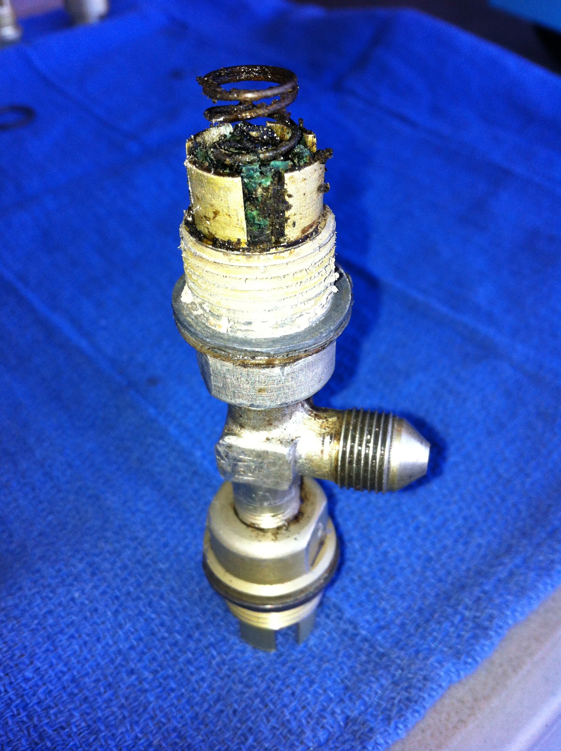

Anyone have any suggestions on flushing out the air lines of a CJ? I was just thinking of injecting a little tool oil just beyond the desiccant, and disconnect the B-Nuts at all the actuators and then empty a few scuba bottles through the systems while actuating the Gear and Flap handles.
Thoughts???

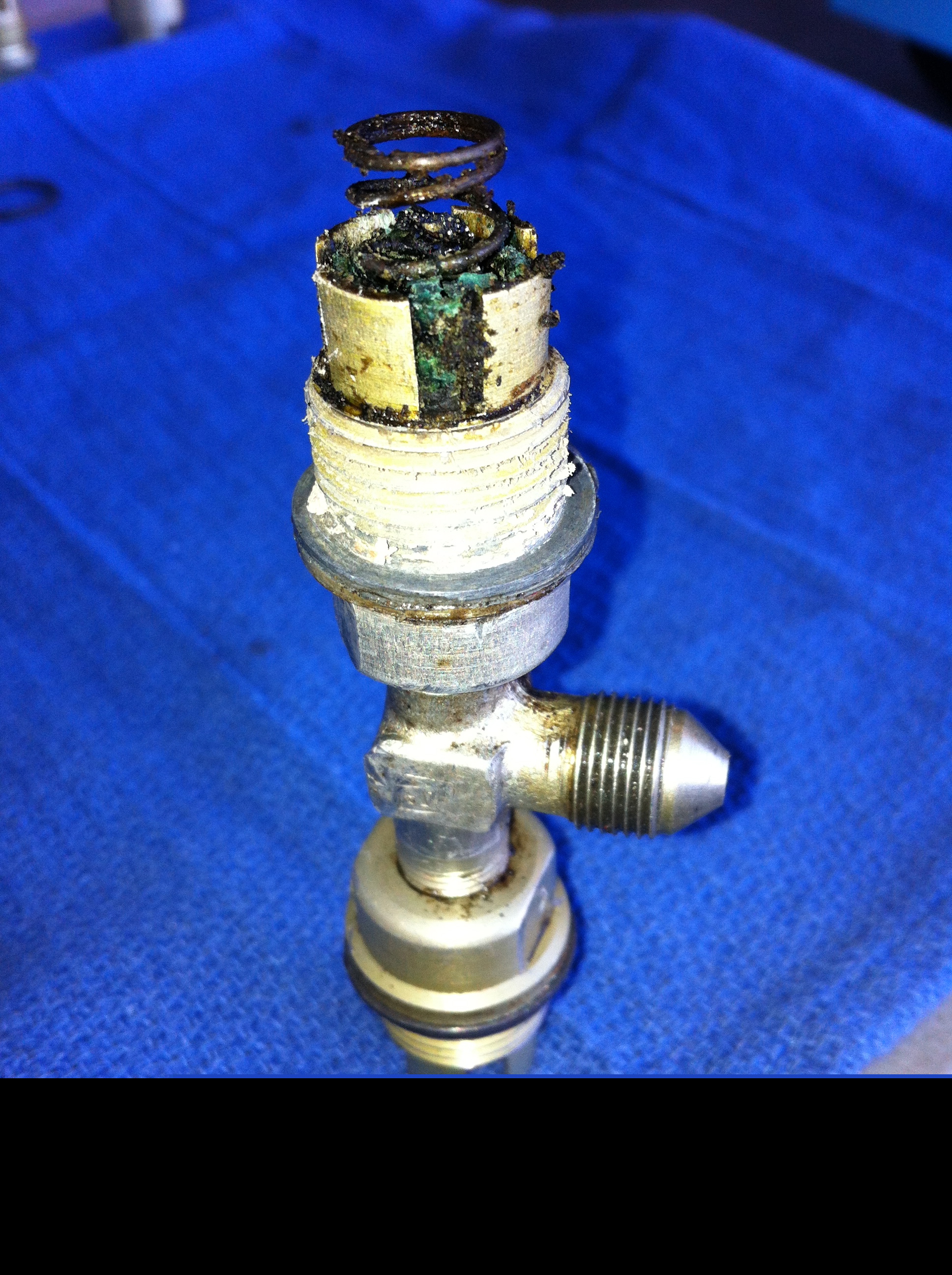

When you open up a diverter valve and see it encrusted with rust and gunk, and the log books show repeated replacement of Flap and Gear valves and actuators, then you assume that the air system was NOT maintained properly. So......I'm pulling all the diverters since they act like little sediment traps, and rebuilding them all, AND I'm going to assume that all this rust and gunk is throughout the air system. Which also means pulling the air bottles cause who knows what shape they're in and is probably the source of the rust. Log books say they were Hydro tested last year, but I don't believe anything that was written by a particular mechanic for a Well Known CJ importer/builder/seller, after some of the things I've found.
Actually a very trusted IA that I know brought up an interesting point yesterday. How in the world can we legally get these bottles Hydro Tested? They're not DOT approved. Maybe I'm missing something. I'm actually considering just using Scuba bottles instead.

[quote]When you open up a diverter valve and see it encrusted with rust and gunk, and the log books show repeated replacement of Flap and Gear valves and actuators, then you assume that the air system was NOT maintained properly. So......I'm pulling all the diverters since they act like little sediment traps, and rebuilding them all, AND I'm going to assume that all this rust and gunk is throughout the air system. Which also means pulling the air bottles cause who knows what shape they're in and is probably the source of the rust. Log books say they were Hydro tested last year, but I don't believe anything that was written by a particular mechanic for a Well Known CJ importer/builder/seller, after some of the things I've found.

k7wx
Joined: 24 May 2010
Posts: 117
PostPosted: Mon Aug 25, 2014 11:38 am    Post subject: Air system Flush Reply with quote
Mark,
After buying my CJ, I began the methodical process of going through the pneumatic system. The actuators were not disassembled and have since been replaced, thanks to your advice. I looked at the check valves, emergency valves, gear valves and flap valves. What I found was amazing. Attached is a representative picture of a firewall check valve. Some springs were completely dissolved and the gear and flap valves looked like they were coated in a combination of sand and chocolate pudding. As you point out, all bets are off for a system that is not properly cared for.
Even though corrosion within the pneumatic system may not always be symptomatic, it can still be impressive and pervasive. If you see one valve that looks bad, chances are good that others are similar.
