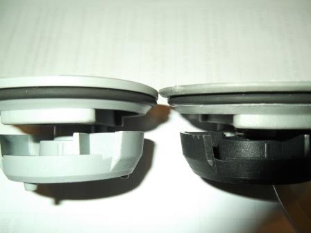

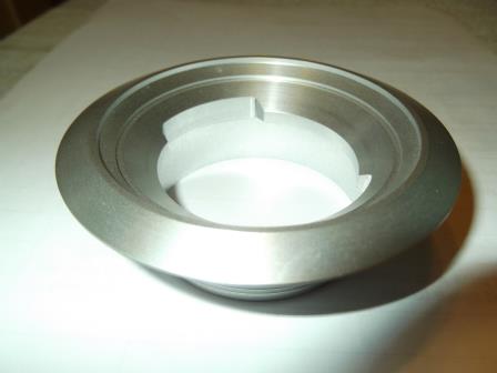

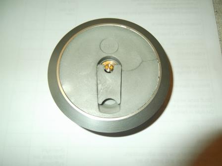

I received a call from a client who inadvertently misplaced his gas cap. His kit is a about a 2001 XS and Europa-Aircraft (2004) does not have stock on these older caps.
Come to find out, the caps changed in or about 2003. All caps on newer XS kits have a smaller cap and ring (65mmOD).
What to check.
If you have a fuel cap supplied with your kit made by SPRL that measures 70 mm OD on the gray cap, these caps are no longer in production and the new 65 mm caps do not fit properly. Aircraft Spruce and Wicks do not have any old style caps in inventory.
Classic caps and the newer XS kits are available but the cap and flange have to be bought at an average price of about $60-$70. On the older pre 2004 kits if you have the 70 mm cap and you wish to upgrade to the newer style, you will have to cut the fuel ring out and replace. Not fun especially since the diameters are different.
Please review the pdf document attached for details on the differences.

I measured my cap at the hangar yesterday and it looks like a 65mm dia cap so take me off your list for the 70mm cap.
Regards Dave Park G-LDVO

A little follow-up:
While the twist locking mechanism on the 65 mm cap engages the old 70 mm
flange, the O-ring does definitely NOT seal the down pipe. It is shy by at least
0.5 mm from the flange. I would not want to fly in rain with it Wink
Ira N224XS

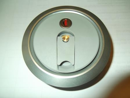

I changed my original cap for the locking version. Does this then mean that
it will not now be sealed? I have had my suspicions! However Europa
Aircraft supplied the locking cap so surely this issue was investigated and
they should have spoken out ?

I replaced the original with a locking cap from Europa a while ago because I lost the original!
It is not sealed I put a circle of vinyl (the type used for sign writing) over the cap. It works but it is a bodge. If anyone comes up with a sealing cap for the old classic filler please let me know.

I believe the non-kludge choices for the loss of an original kit supplied
fuel cap (which are 70 mm diameter) are:
1) tear up fuselage and replace existing 70 mm flange with now standard 65 mm flange / cap set
2) As Bud has offered, have supplier provide a new short production run of 70mm caps

Bud
I hope you can clear up my confusion over the fuel cap problem.
I have the old 70mm cap and flange supplied with my XS kit around 2001 - not yet fitted.
As you stated it has the tapered edge to the cap measuring 70mm at the max diameter and the receptacle flange has a similar taper.
Around 2005, I purchased a locking cap from Europa which is indeed 65mm max diameter due to the tapered edge having been machined square.
However, having measured almost every dimension on each cap with a digital vernier, I can find no significant difference between the two caps.
The O-rings are the same 57mm x 3mm size and the O-ring groove and position on the cap result in identical O-ring position and dimension when fitted.
The O-ring sits in exactly the same position on the receptacle flange when the 65mm cap is fitted and when tested to 10psi there was no leakage from either cap.
The only difference would appear to be the gap around the cap when fitted to the old type receptacle caused by the square machined edge.
Am I missing something.
I know some are reporting leaking caps but could this be due to the cam mechanism being incorrectly adjusted to obtain an effective seal of the O-ring.

PostPosted: Wed Sep 10, 2014 1:27 pm    Post subject: Fuel Caps for the Europa Fleet. Reply with quote
<?xml:namespace prefix="v" /><?xml:namespace prefix="o" /><![endif]--> Sorry Kelvin,
I have been assured that the cap doesn't quite seal due to the taper of the aluminum.
Bud Yerly
