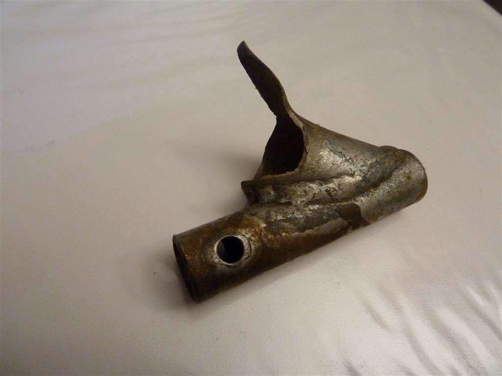

More FSII gear leg problems today. Several years ago we virtually totaled N582EF for a really bad landing where the welded fitting that joins the landing gear leg to the axle failed. Had the fitting not failed, it would have been bad, but not a virtual total. So we rebuilt it.
Today Ed landed the FSII in a friends hay field due to a fuel problem. It was a hard landing, but nothing remarkable. It should have been maybe a slightly bent gear at worst, pull the gear leg out and straighten it. Yet this fitting failed in exactly the same fashion as happened several years ago with the previous gear leg fitting. Once we get the airplane home - hopefully tomorrow - I plan to take the factory fittings and beef them up as much as I can. I no longer trust them, and will be welding some straps or saddles over and around them.
Just something for the rest of you guys to think about.
PS: Note that the file has been resized to 64 kb, and fits very nicely onto the page. No resizing of the page or scrolling back and forth is necessary. Wink

I may be wrong,( the photo was so small  Smile  ) but the fitting appeared to be one of the early axles. Those were 60 thousands in thickness. The current models are the 120 thousand thickness.
I had the thin ones on my plane and they too caused me a lot of problems. I have since gone to heat treated 4130 because of the problems with the axles and gear legs. I wouldn't go back.
I realize that Homer felt that it would prevent damage to the cage to have the gear legs fail first, as a limit to the damage. That has not been reflective of my experience. Failing gear legs and sockets have caused heavy damage to the cage due to the legs failing for what would have been no more than a rough landing with the proper gear legs.

OK, did not know that they are now .120. After we get the airplane home, I'll call Travis and get some. Thanks.

Fourteen years ago a single failed gear leg/axle socket put a stop to my second attempt to fly my MKIII to Point Barrow, Alaska.  That single gear leg/axle socket cost me a torn up airplane, a lot of grief and money, plus 30 days to hitchhike and fly commercial to Alabama, find a 24 foot enclosed trailer, then drive back to northern British Columbia to retrieve my airplane.
I have been using heat treated 4130 gear legs since 1987, but I was still using a bolt on gear leg/axle socket because it was easier for me to align the main gear.  Brother Jim wanted to fabricate the steel gear legs with .120" axle sockets welded to the end of the gear leg, but I resisted and ended up paying dearly for that decision.  I have been flying with the same set of steel gear legs with welded axle sockets since I rebuilt the MKIII in 2000 and 2001.  Don’t know how many hours or landings I have on those gear legs, but I am still flying with them.
I have torn up Firestar fuselages with aluminum gear legs, i.e., ripped out gear leg sockets.  The aluminum gear legs my save fuselages in some cases, but not in all cases.

You might want to rethink modifying that. Forced landings will cause damage, it's just where you want it to happen.

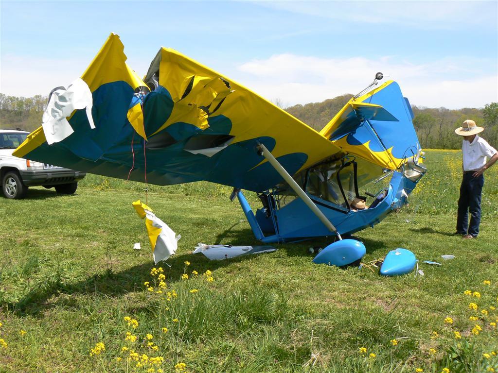

This is what happens when the fitting on the end of the gear leg breaks, the wheel comes off, and the end of the gear leg stobs into the ground. How much worse could it be?
