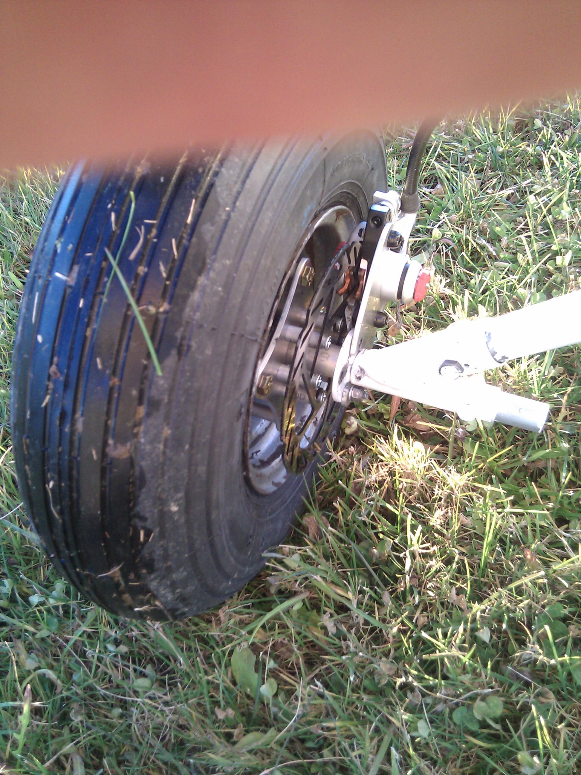

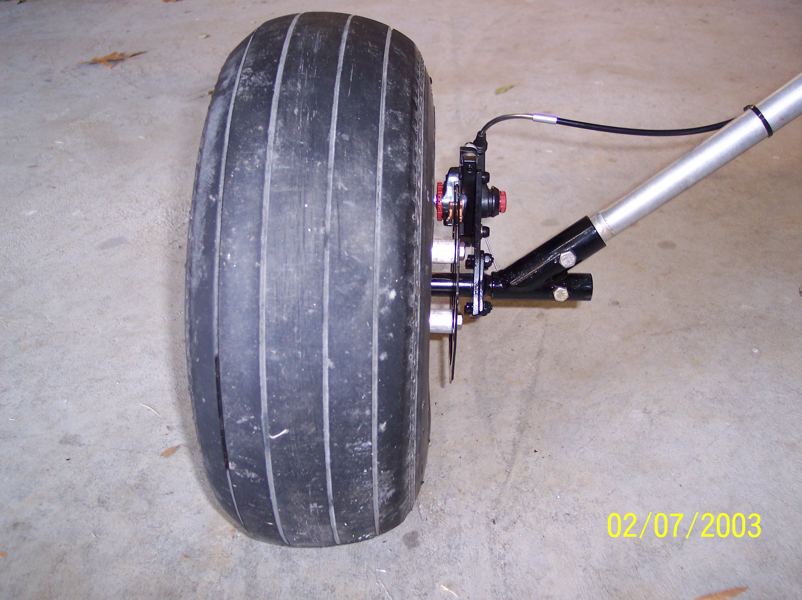

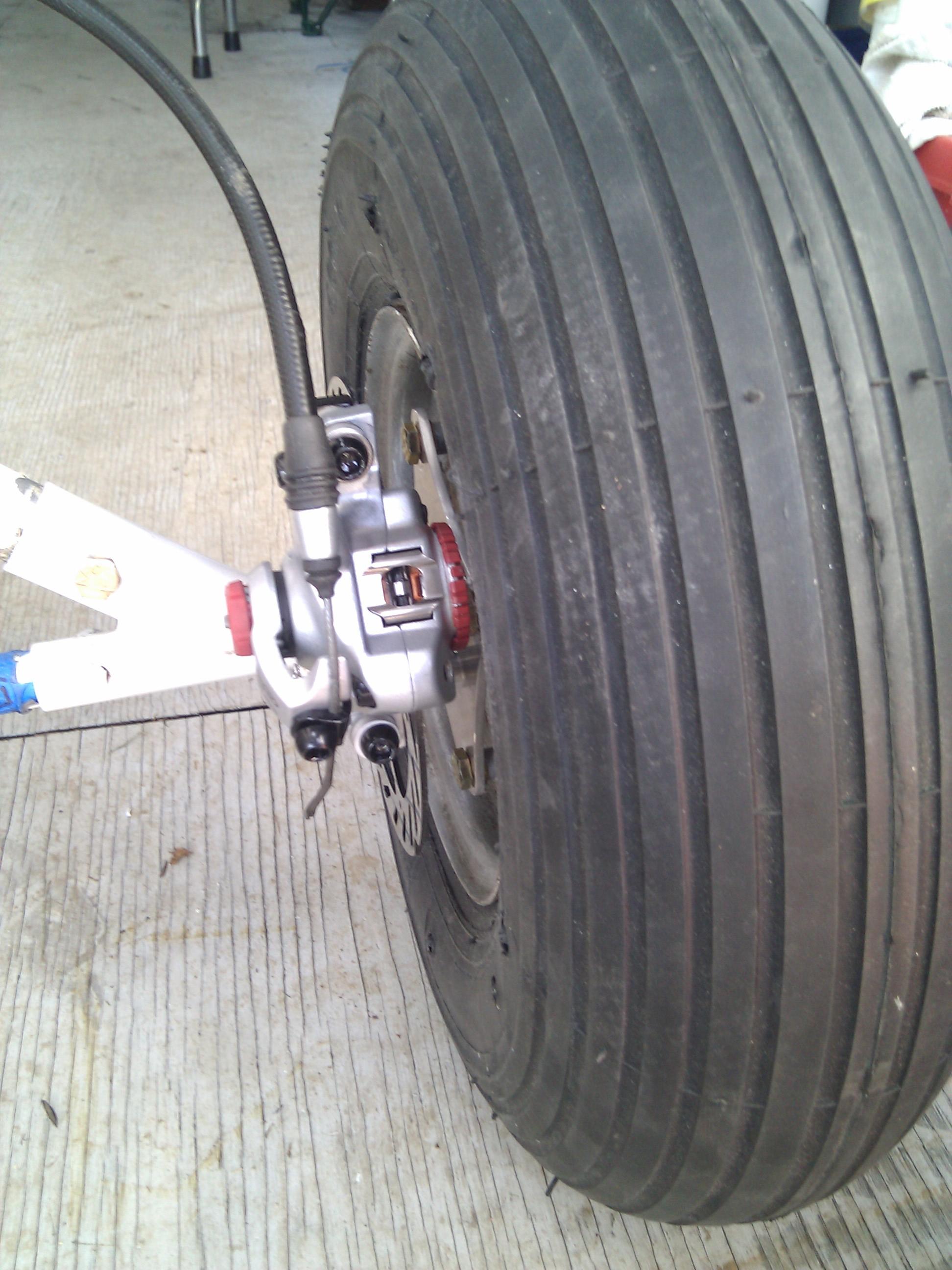

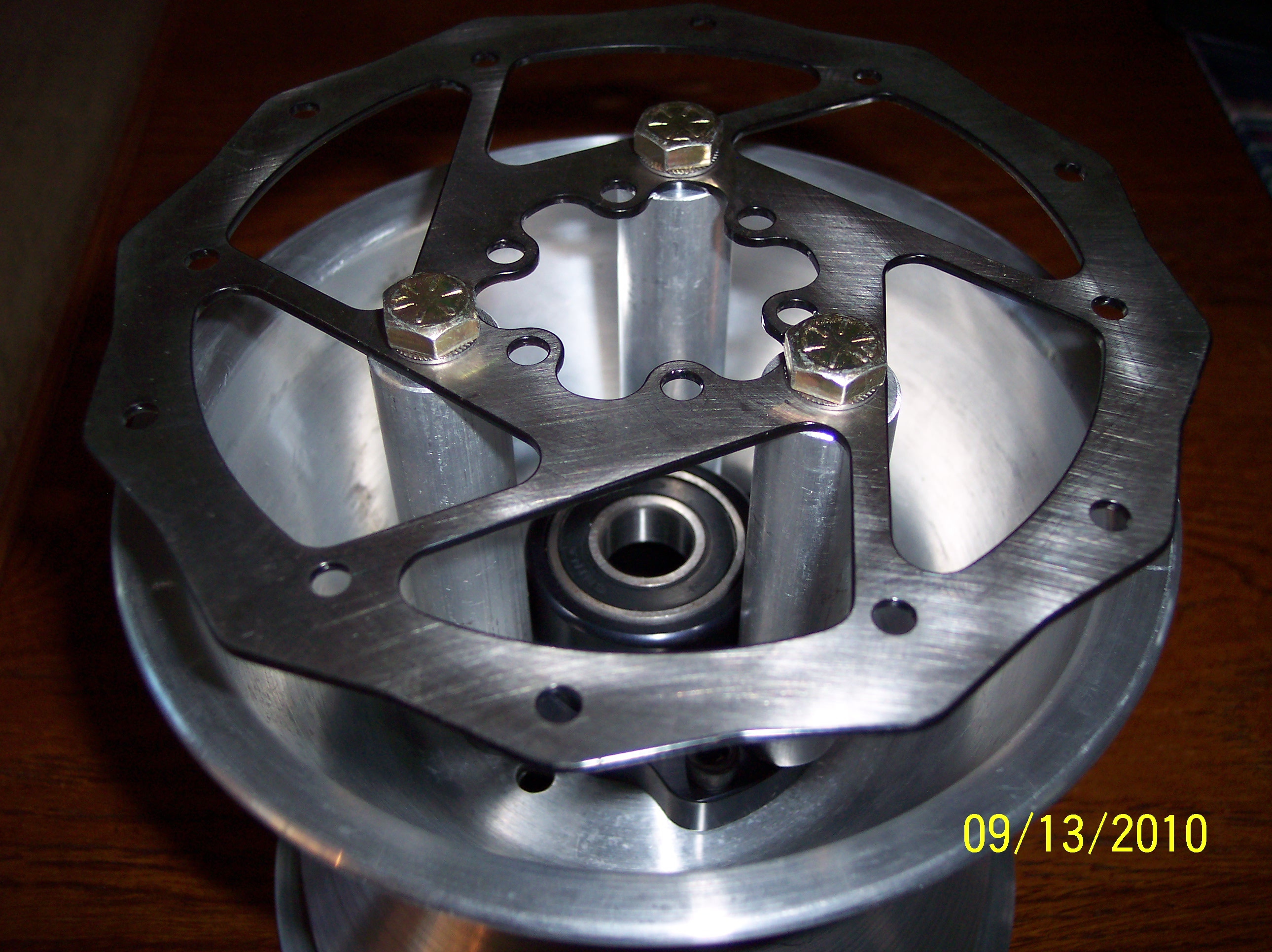

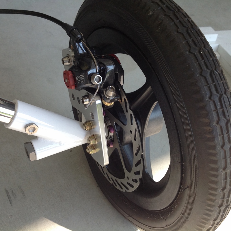

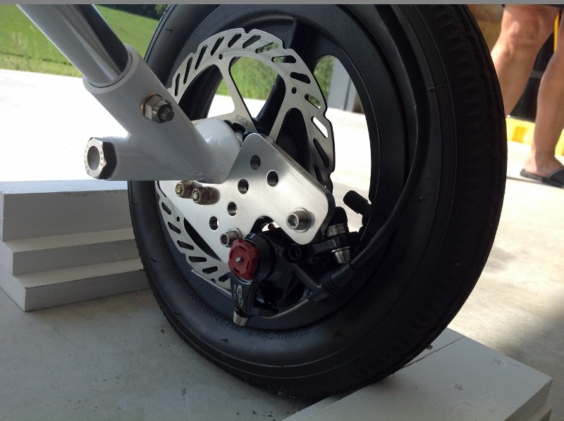

I put these on my Firestar. They work great. One finger will bring me to a screeching halt.
They are cable activated bike brakes.
Avid BB7 Road Disc Brake 140mm x 6 Bolt
I hope you can see what I did there. I had to make two brackets out of aluminum. One bracket plate has the four bolts going through the rim on one side and six bolts holding the rotor on the other side. I switched to narrower tires to make this work. I may have been able to use longer bolts but I like the way this came out. The second bracket is for the caliper to mount to. I thought three bolts on the axle plate would work but I couldn't get a bolt through there so it is held on with just two bolts and is plenty.
The nice feature of these brakes is that the individual side pads can be adjusted easily with your fingers.

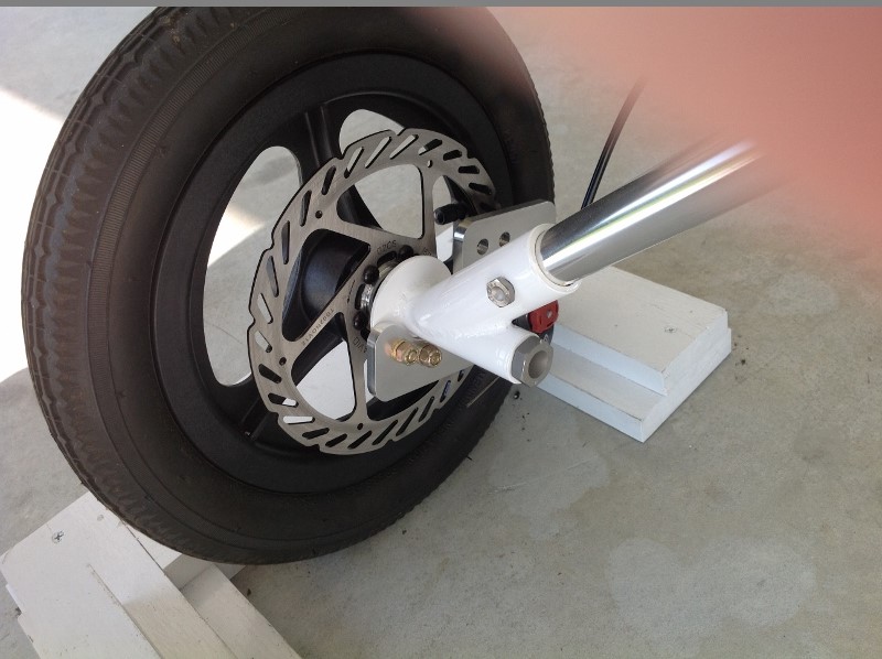

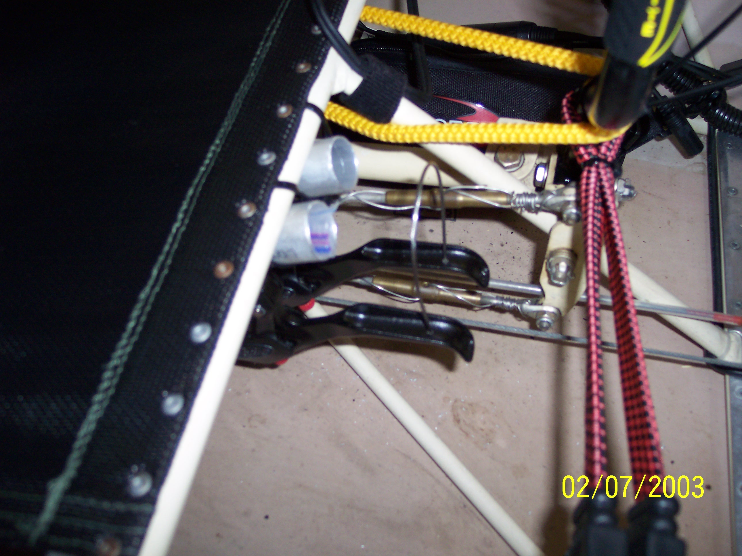

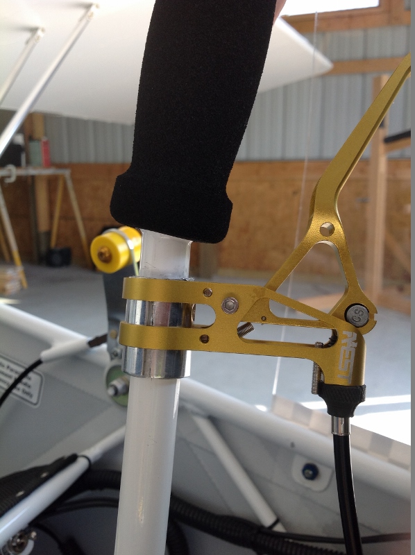

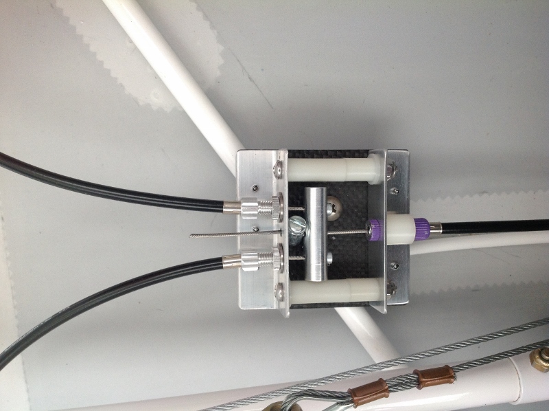

Forgot the hand controls. One lever controls both cables. I also use a wooden wedge to lock the lever open as a parking brake.

Thanks for the help Scott. Pictures are always worth a thousand words in my book. Just a couple questions if you don't mind. Do you use the brakes on your landing rollout to slow down or just on the ramp? I used to fly off a grass strip and brakes weren't really necessary but that airport closed so now I'm on a paved airport. I'm concerned about a noseover if the brakes are applied too hard after landing. Also, did you have to buy new axles from Kolb or did you buy some stock yourself? I'm pretty sure the original axles are heat treated. My axles were cut down to fit during my build since I wasn't using brakes, so I need some new ones to accommodate the brake assembly. I'm not sure if a regular pipe threader for plumbing can do steel for the threads needed on the end of the axle. You can buy 5/8 #8 Bolts at the hardware which are hardened but I'm not sure they are strong enough to do the job. My landings are pretty good but not all are greasers.

Nicely done,very light clean installation

I do use the brakes on landing rollout, taxiing and as a parking brake while I'm getting into the plane since I start the engine outside then get in.
You need to use the brakes carefully because you will nose over. Not as much an issue when landing because you have more air over the tail to help keep it down. Its really only an issue when trying to do a run up with the brakes locked. I can't get over 4000rpms in a runup without nosing over.
Another concern with using a single handle brake lever is that you will want to adjust your calipers so you get an even pull on both sides. I do that by holding a little brake while taxiing and feel if it is pulling one way or the other, then get out and adjust them.
My axles were already adapted for brakes. They had the flange welded on. I don't have the knowledge to turn a bolt into an axle. That seems like a bad place to take a shortcut. I would buy the proper axles and have a flange welded on. I do know that plumbing threads are not the same as regular nuts and bolts threads.

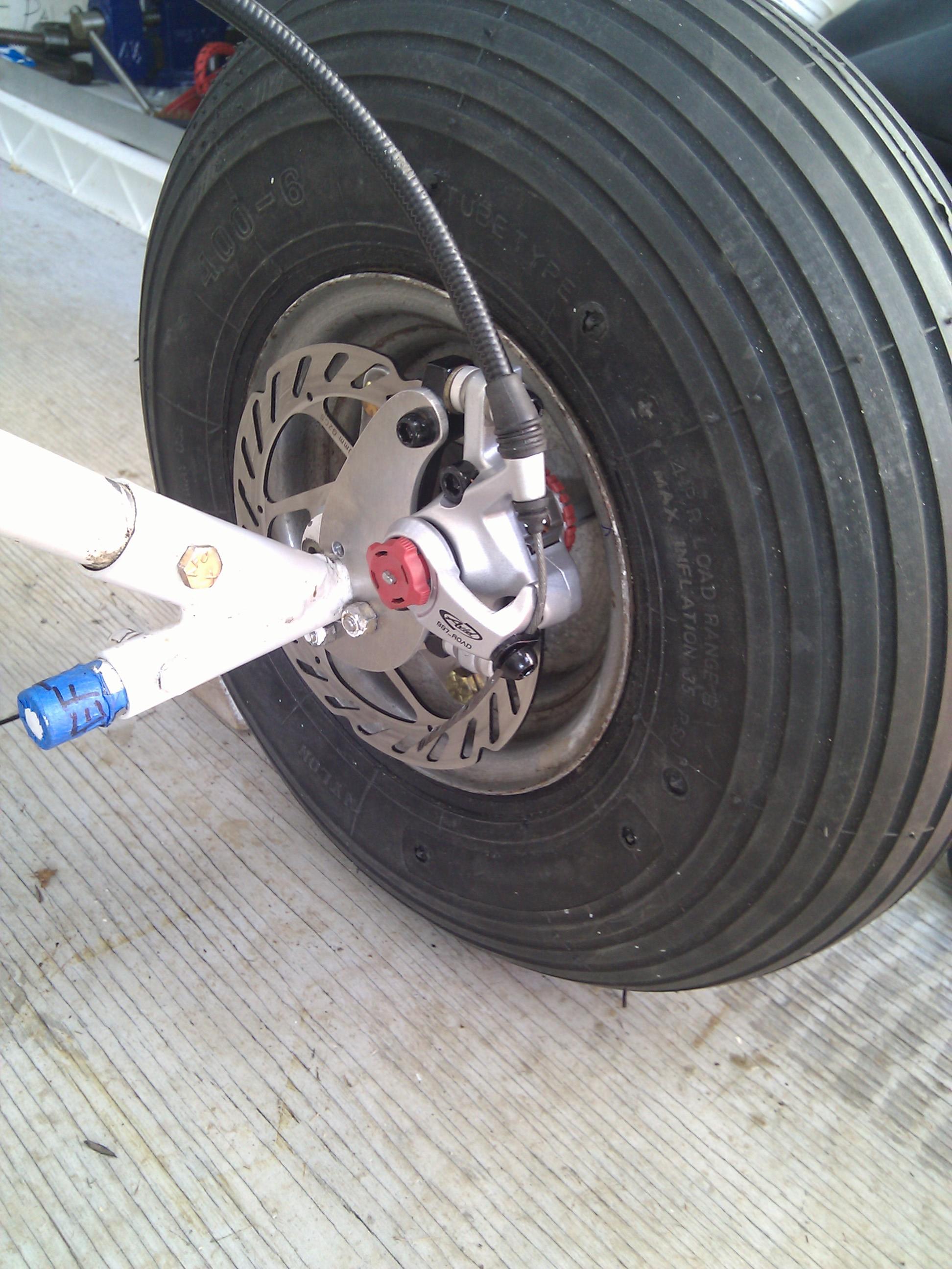

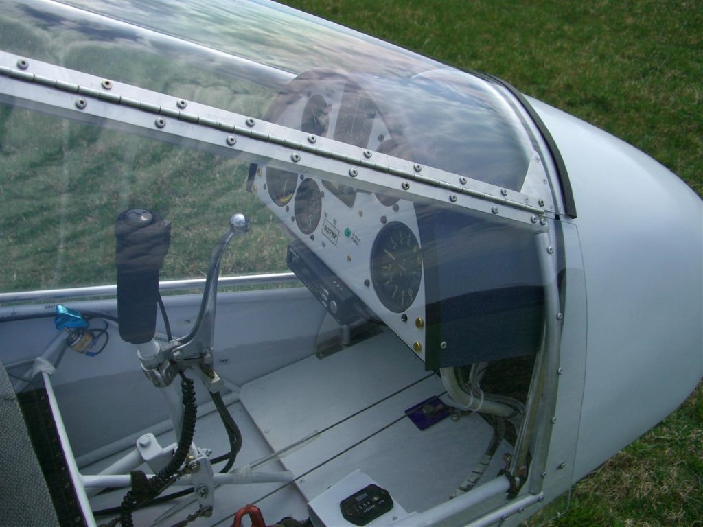

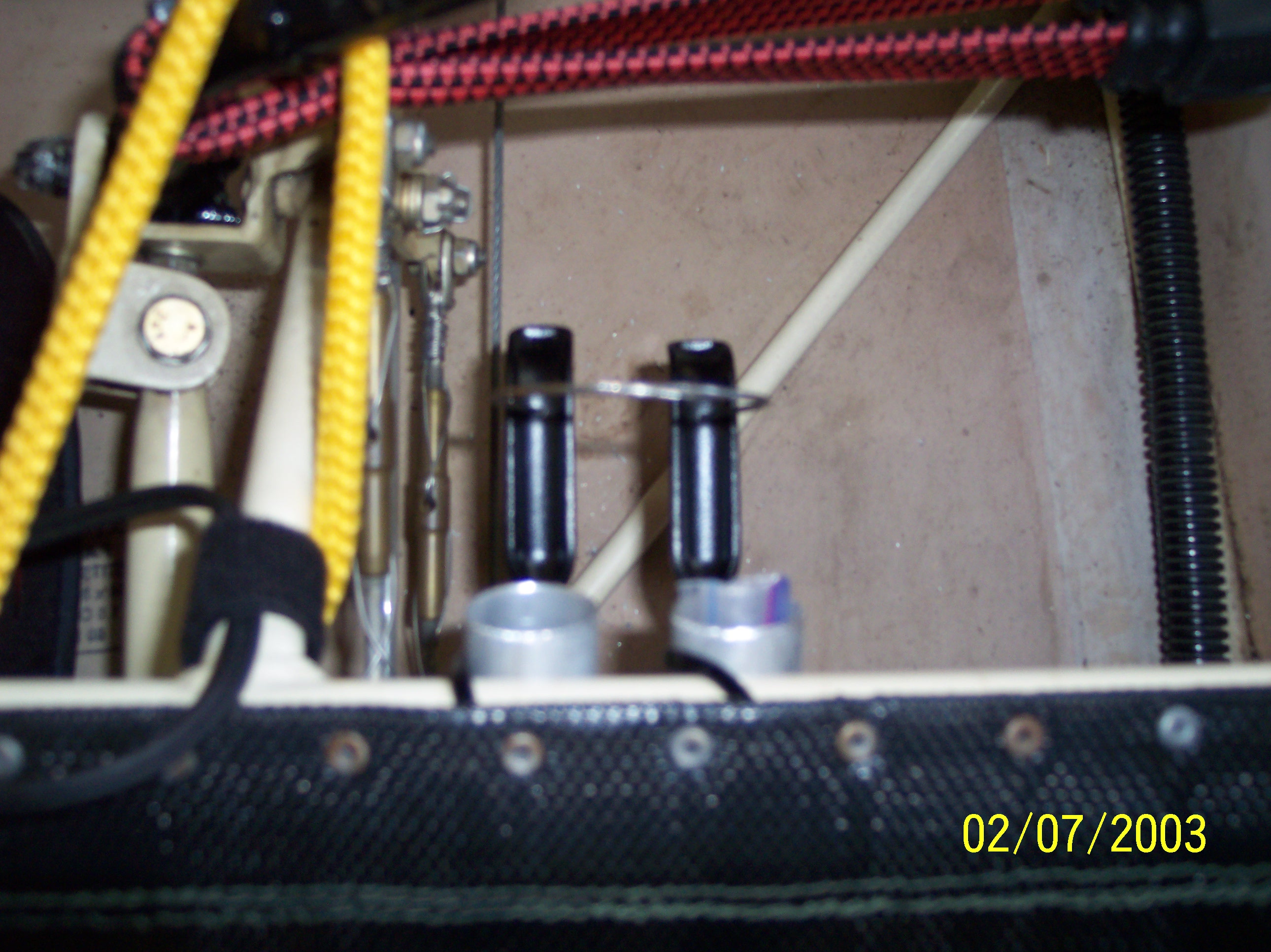

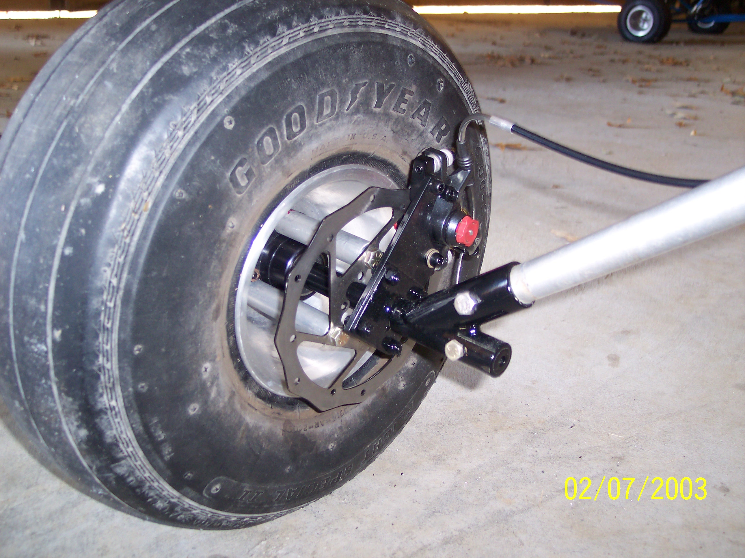

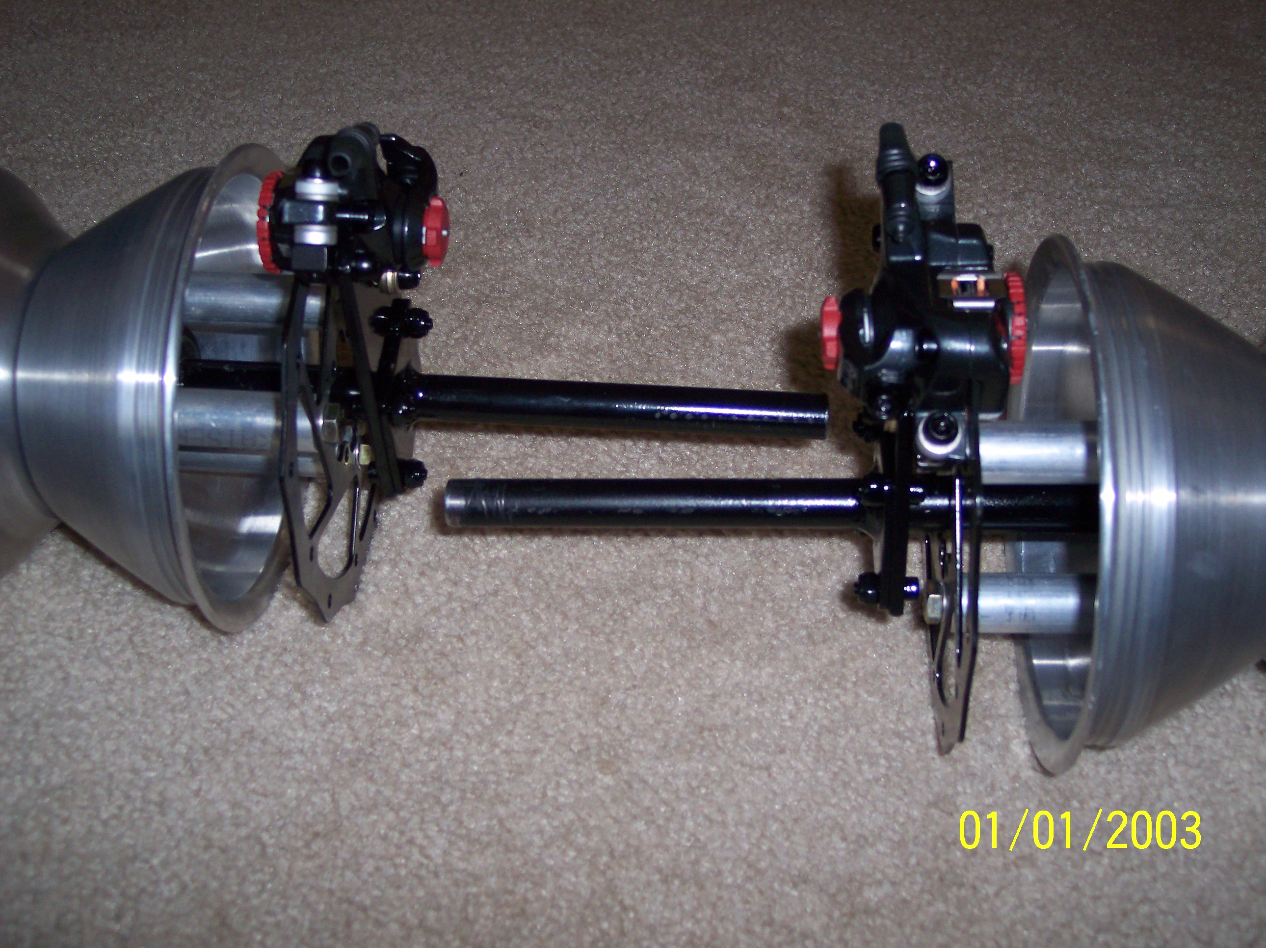

These are the same BB7 brakes but I used the parallel levers under the seat and just reached down for equal braking or differential braking. Worked great. Sold the airplane but these pictures should help.

I used spacers also...I wanted to turn two spools instead..but I could
not find any large diameter aluminum at the salvage yard... plus , my
wheel barrow rims were not true and I needed to add shims...Herb

The separate spacers were stiff enough to keep the brake disk from getting out of calibration? I hadn't considered that. I thought the spacer would have to be a solid assembly of some type. I guess the key would be to buy a brake disk whose mounting holes line up with the wheel bolt holes if possible. I'm running the stock azusalite 5 inch wheels right now. I figured I would have to make a template of the hole pattern to take to the bike shop/amazon/ebay and see if I could get something to already line up. That would make the job easier compared to having somebody fabricate a special spacer for me. Thanks for all the photos. They are saved in my archives now

I haven't tried working with bike brakes on ultralights, but I would think the difference in diameter between a road bike or 29" mountain bike might offset the difference in weight.
I wouldn't worry too much about dissipating heat on an aircraft that lands at 30 mph.

Gregg, I've looked at this option a lot and found two sticklers that always stop me.
One, bike brakes tend to be one side only. A right caliper, for instance, is darn near impossible to mount on the left side.
Two, the job of the brake is to dissipate heat energy and disk and caliper sizing is done by how much mass you want to stop and hence, how much heat you need to shed. Putting a bike brake on a plane, even an ultralight like the FireFly, is asking it to work with at least twice the mass for which it was designed.
Good luck,

Firefly brakes. Have not taxied with these yet but they work well on the considerable slope of my driveway. Changed to these to save weight, had Black Max which worked extremely well but this setup is 4 to 4.25 lbs. lighter.
 Filesize:  291.56 KB
 Viewed:  30526 Time(s)
 Filesize:  232.76 KB
 Filesize:  217.8 KB
 Filesize:  117.07 KB
 Filesize:  119.11 KB
PostPosted: Sat Aug 16, 2014 3:41 am    Post subject: Brakes Reply with quote
Very clean and professional installation.
What size tires are you using? They look very small.
Larger tires and low air pressure take a lot of shock load off the gear legs
and airframe.
lighter.
